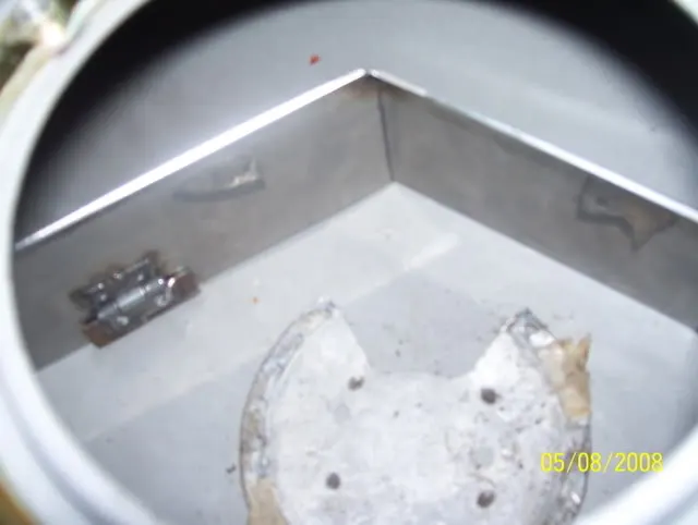

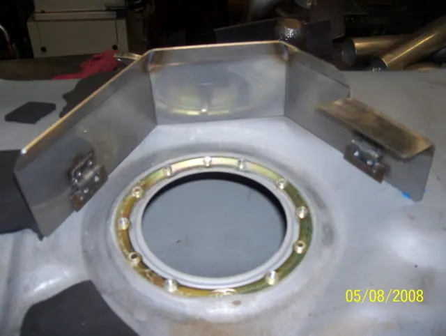

Make your own "baffle"..like this.
No thanks. Info on how to get the 03-04 cobra tank and pumps to work on a 98 gt only please.

I'm pretty sure the 98 and 99-04 tanks are the same. The difference being the the 98 hat has a return provision. Other than that it should plug right in.
Just showing you other options.
