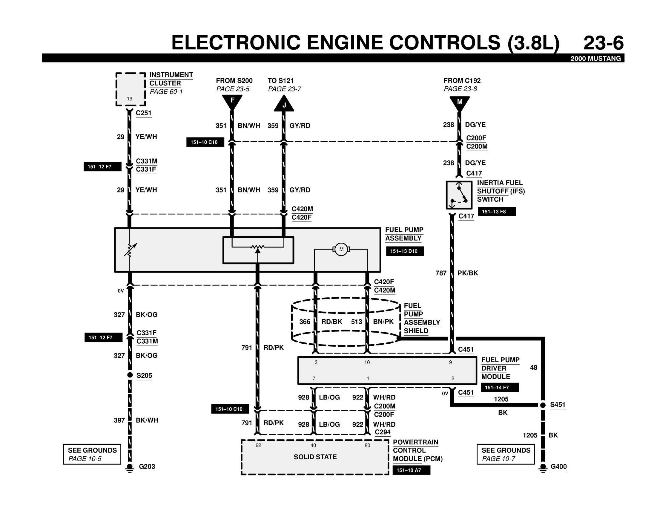

Persistent P0453. This car has been sitting so I think I have narrowed it down to wiring as no matter what, voltage remains at 5ish

The fault returns almost immediately after starting. I am including the wiring diagrams I am working with. Looks like pin 62 on PCM should be what I want, but that seems to end at fuel pump.
But not seeing the actual FTP on the diagram, not sure where to go
