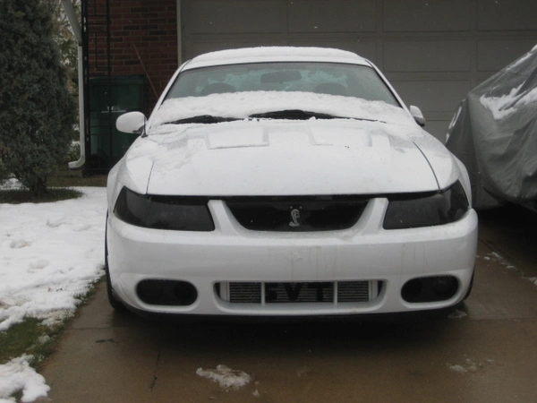

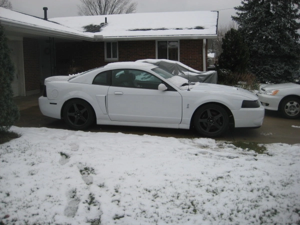

It was delivered today while i was at work. I arrived home and it was sitting in the driveway smiling at me.

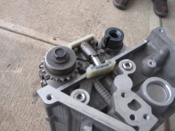

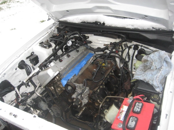

The top end is pulled apart. The tensioner broke and starved the cams of oil on the DS head. Need the cams polished and the journals cut and line honed. I hope to have it back together in a few weeks.
Anyone have a DOHC tensioner
