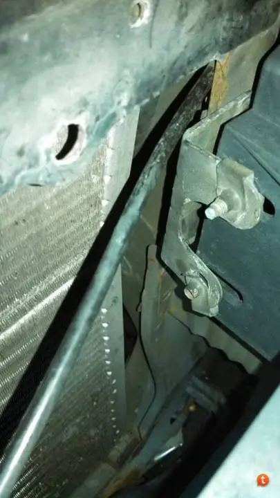

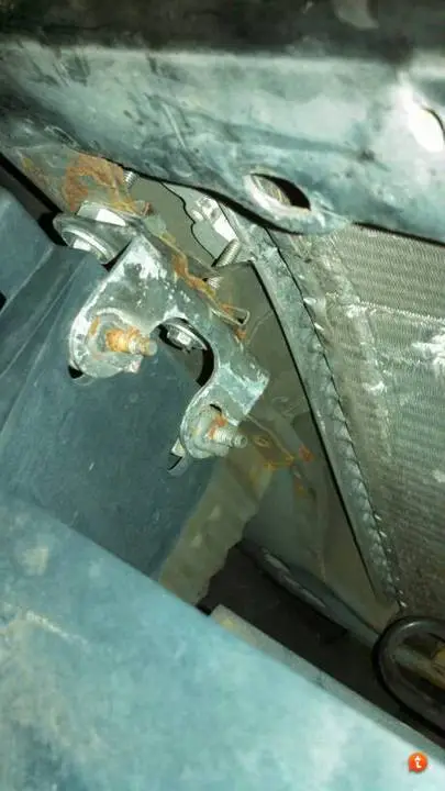

At any rate, the passenger side headlight bracket is bent. He spaced the assembly off using nuts.
From looking a little deeper in it tonight, it looks as if that part is a part of the core support. Can just the passenger side bracket be replaced? Or would the whole core be needed? Is it bolted or welded....or both?
First pic is passenger side, second it drivers.

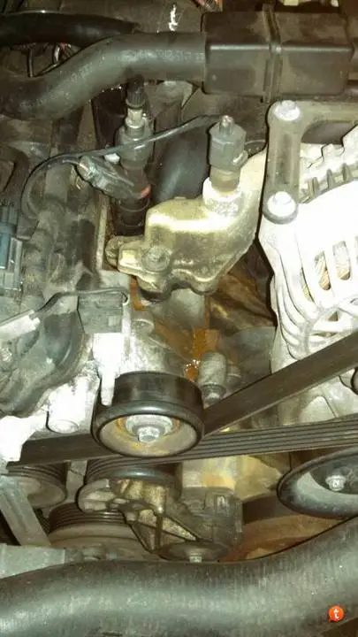

I know these intakes are prone to leaking coolant..in the following pic, is this a common leak point caused by the intake? I plan to just r&r the entire upper intake. You can see the dampness behind the tensioner.

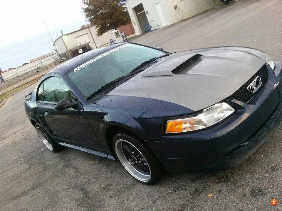

And lastly for the time being....the car.

Seems like your in for a little fun. As far as that radiator support, It looks like someone tried to beat it back into submission. Depending on how it looks when you get into it, you may just want to replace it by cutting it out and putting a new one in.
A new intake manifold is always a good idea on these 4.6s especially if they have a lot of miles on them. If you don't know how to do it, YouTube has a couple of great videos you can watch.

I'm going to pull the front parts off for sure, and take a better look. The only place that looks bent is the headlight mounting portion of the core support. If it comes down to replacing it, that will fall on my body guy. I can build a 1k HP powerstroke...but I am far far from a body man. Lol.
As for intake, I may look into some all metal options as I just do not like plastic parts. Lol

Well you have to know that your headlights are just clipped into your header panel. The header panel is attached to the radiator support, and holds the grill, bumper, headlights to the car. It may be your header panel that is also bad or the previous owner may have use a non-Ford product and it does not fit well.
