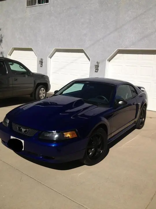

Here is a picture of the car if anyone is interested
if the imbeded picture is broken here is a link http://imgur.com/brdufno
