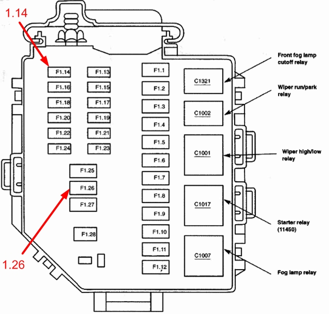

Here are some fuses to check. Measure from both ends of the fuse to chassis with the key On. There are usually slots at each end of the fuse where you can make contact with a voltmeter probe while the fuse remains in place.
F1.26 (engine compartment); 30A large size fuse; powers the PCM and CCRM.
F2.34 (fuse panel under the dash); 20A; powers the PCM and CCRM
F2.8 (fuse panel under the dash); 20A; powers the oxygen sensors
F1.14 (engine compartment); 20A; powers the CCRM
F2.2 (fuse panel under the dash); 20A; powers the CCRM and fuel pump
In all cases, the voltage at both ends of the fuse should be approximately equal to the voltage measured at the positive battery terminal (~12V). Fuse 2.34 is particularly suspect because it protects loads that are only powered with the key in the On position, specifically the imstrument cluster, passive anti-theft system, CCRM, and Ignition.

The linked fuse diagram matches the one in my '03 shop manual. I am posting one here for the engine compartment fuse/relay box.
