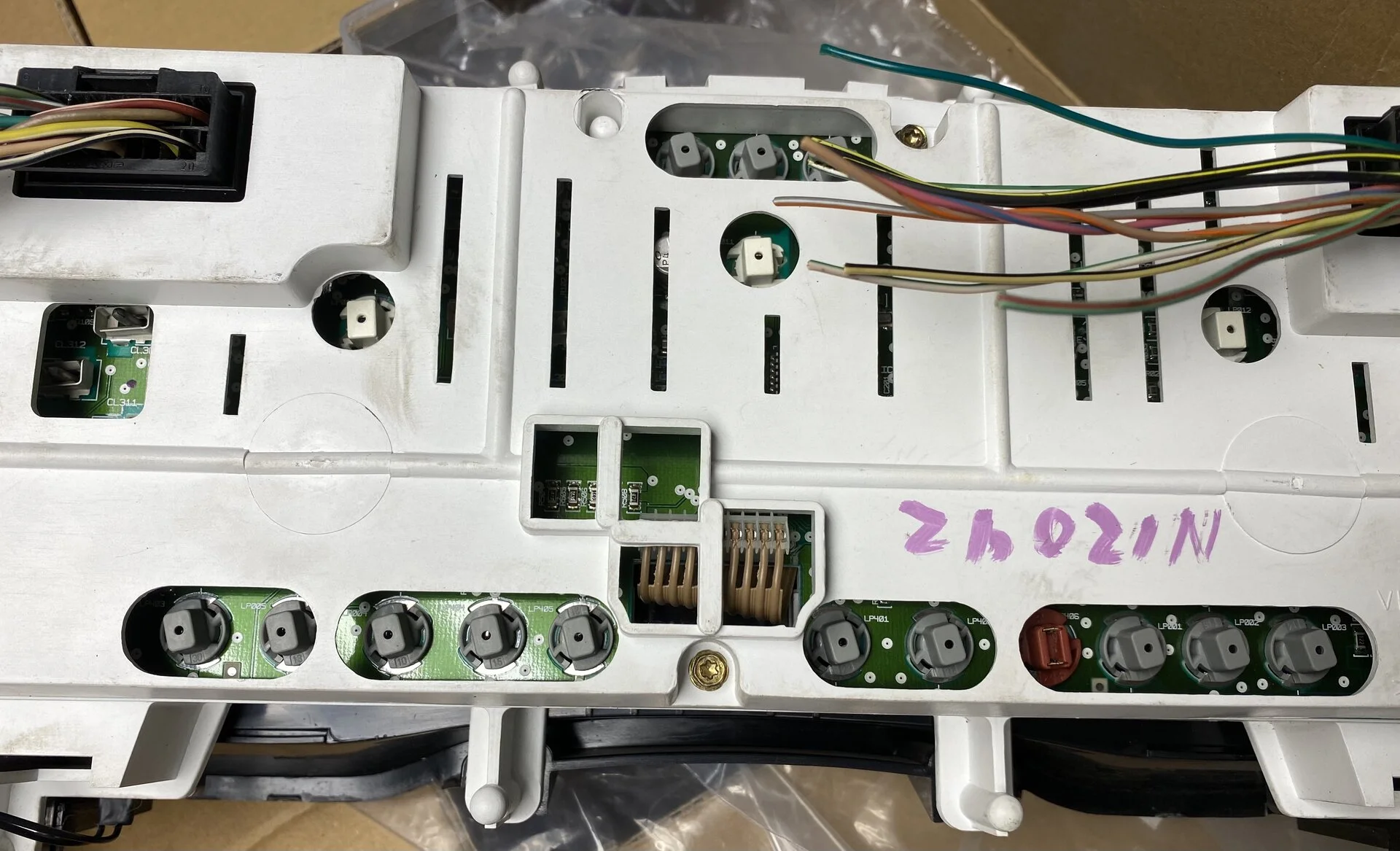

Hey fellas. I think I know the answer but wanted to ask. When I turn my key forward, no check engine light or abs or traction control light appear on the cluster on my mach 1. I have 2 codes pulled from computer. But the normal 420, 430 for x pipe. Do you think my car had been tuned. If so they didn't give me the tuner. Also when spinning the tites the green traction light dont come on. I checked fuse #5 for traction control but fuse was good.

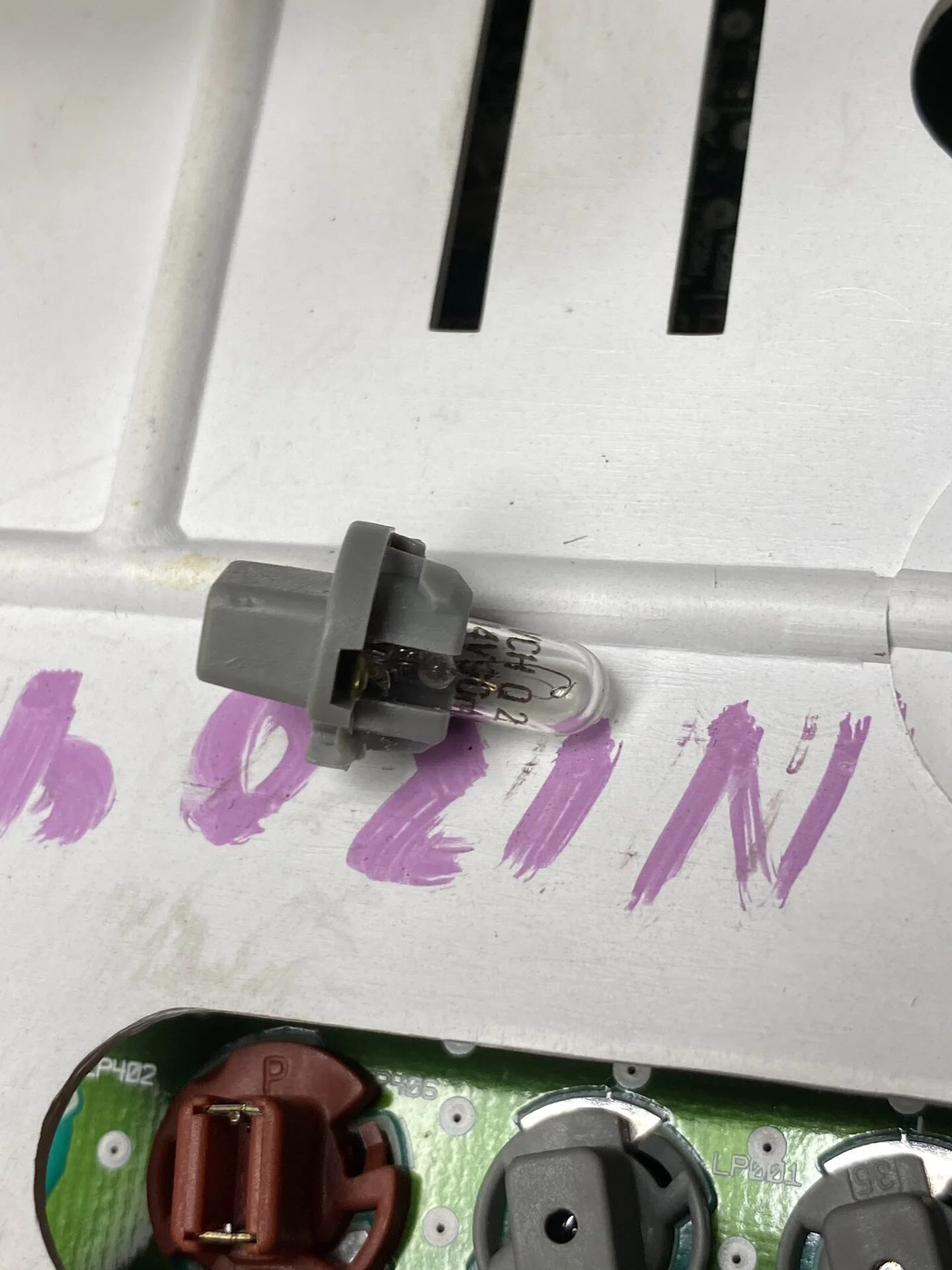

Pull the cluster and check the bulbs. After 20 or so years, they could just be burned out

I'll give it a try. I'm on my 16th mustang. And for the record if the traction control is disabled that's a plus. Im almost sure it's disabled. I've tried a few pulls and spun the tires and it hasn't bogged down.
It's always possible. When I load the tune on my car the traction control indicator on the switch lights up to indicate it's off. But at start-up all the dash lights come on.
Interesting. I'll pull the bulbs. I've only had the mach 1 for a few weeks but am fully enjoying it. Going in the morn to get slp's put on. The x pipe is nice but it has Borla s type mufflers which are garbage.
