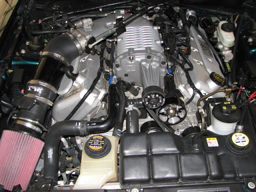

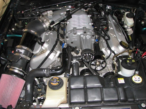

Last cobra I owned was a 1998 model. I picked up this 04 back in september....11K mile, showroom stock. Have since added the typical mods (pulley, exhaust, tune, etc...) Great car, lots of low end tq. Fun cruiser. I'm still debating on how exactly to lower it and if I go with aftermarket rims.........so it's a bit of a 4x4 at the moment. :(

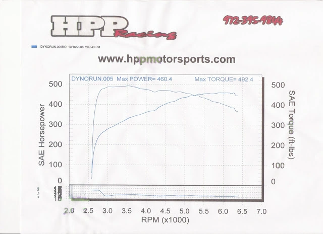

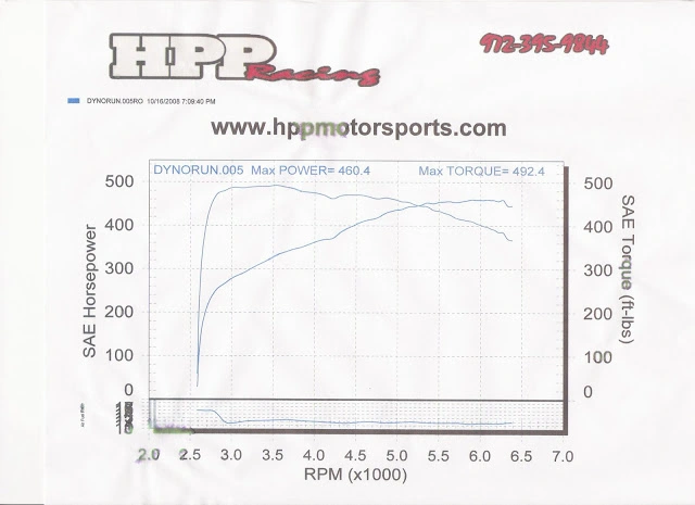

dynosheet sae corrected, check out that tq curve

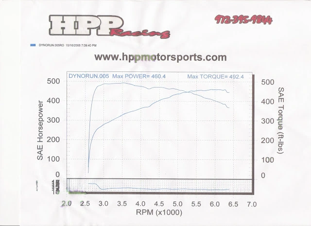

now to power output - keep in mind, the strim'd 98 car made 460rwhp. The 04 car pullied makes 460rwhp. A true wash in the HP dept....but the TQ dept is a vastly different curve. The strim'd 98 car made 385rwtq peak around 4000rpms....the 04 car makes 493rwtq at 3500. Even going lower in the rev band....say 2500rpms, the 04 makes 490ft lbs versus maybe 300ft lbs for the 98 car. This 04 just has a big block feel in comparison. Much funner to drive around town IMO.
here's the 98 graph done over at mti in august '99 (huge heat issues on the 2nd pull - lol):
04 graph
