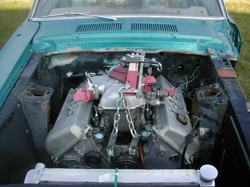

Has anyone done a 3V test fit yet with the OEM shock towers in place? Page 108 of the 2009 FRPP catalog has the 4.6L SOHC motor at 25 5/8" wide and the 460 motor at 26" wide. Taking into consideration that the 460 is just as tall (without carb) as a fully dressed SOHC motor, it SHOULD be some sort of a drop in ordeal.

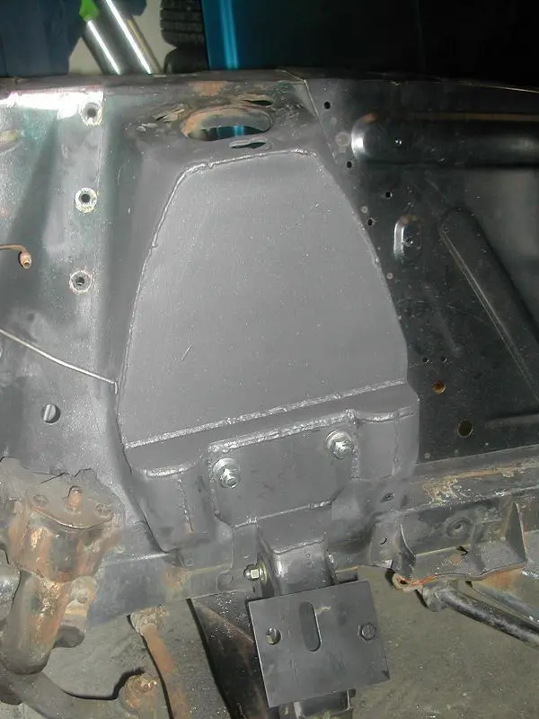

I doubt it very much, every mod motor install I have seen whether SOHC or DOHC has had tower modifiction of some sort....with a SOHC you can get away with notched towers from what I have heard, but it wont fit with stock towers....and every mod motor conversion I have seen pictures of has either a mustang II install, or a RRS install(which costs even more)....that being said, here is a quote from themustangshop.com
"For those with 67-up cars doing SOHC 2v swaps, there is hope if you aren't wanting to go all the way with your front suspension. With a little trimming, the narrower SOHC engine will actually fit down in between them with about 1/2-inch to spare on each side. We have bolt-in custom motor mounts available for this swap, and combined with the rear crossmember you can make it work with minimal fabrication. For non-A/C cars, the heater motor will have to be flipped over (this can be done by pulling the heater box and unbolting it), and when the heater box is reinstalled we recommend using four nuts to space the box 1/4-inch further back from the firewall just for a little extra room. A front-sump oilpan and pickup will need to be used, we sell the Canton 15-790 and pickup as our favorite for the swap."
If the SOHC motor is narrower, according to Ford, than the 460 motor, which fits fine between the '69 shock towers, I'm wondering if you'd have to trim at all, which is why I'm hoping someone has done a test fit already.

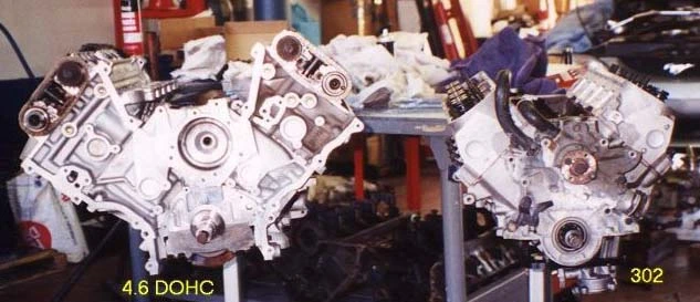

The DOHC, however:
remember also, the SOHC 2 valve motor is most likely narrower than the SOHC 3 valve(speaking of which, why did ford waste money developing a 3v? they could fit 4 valves in the same space and still control them with SOHC...after all, the neon does, and tons of other new cars...maybe they wanted to boost low end torque? it sure wasnt the power...they had a 300HP 4 valve they could have used, regardless, the 3v is obsolete already, due to be replaced by the 5.0 DOHC 4v coyote engine)
anyway, back on subject, while the engine itself may fit with half an inch to spare(according to the article I quoted) manifolds may well be a different matter entirely...on my 4v my cobra manifolds clear ok, but I no longer have shock towers
