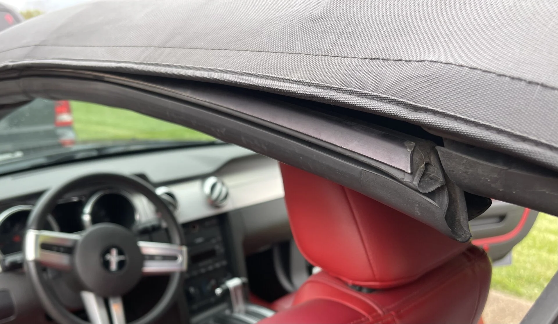

My 05 mustangs convertible top won’t full close flush and it’s pushing the drive side window out. Any ideas?

The rail that your weatherstripping slides into doesn't look like it is bolted on in the back. Pull off the weatherstripping and see if a screw is missing where its hanging down at.
