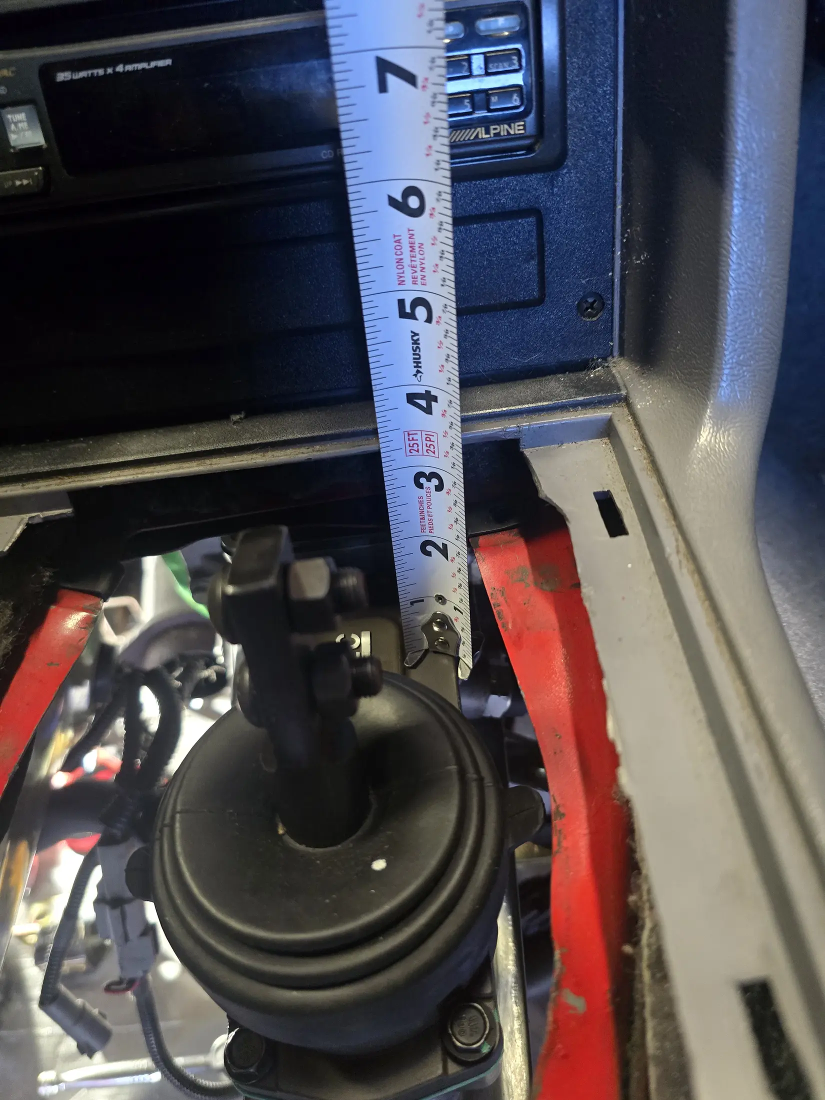

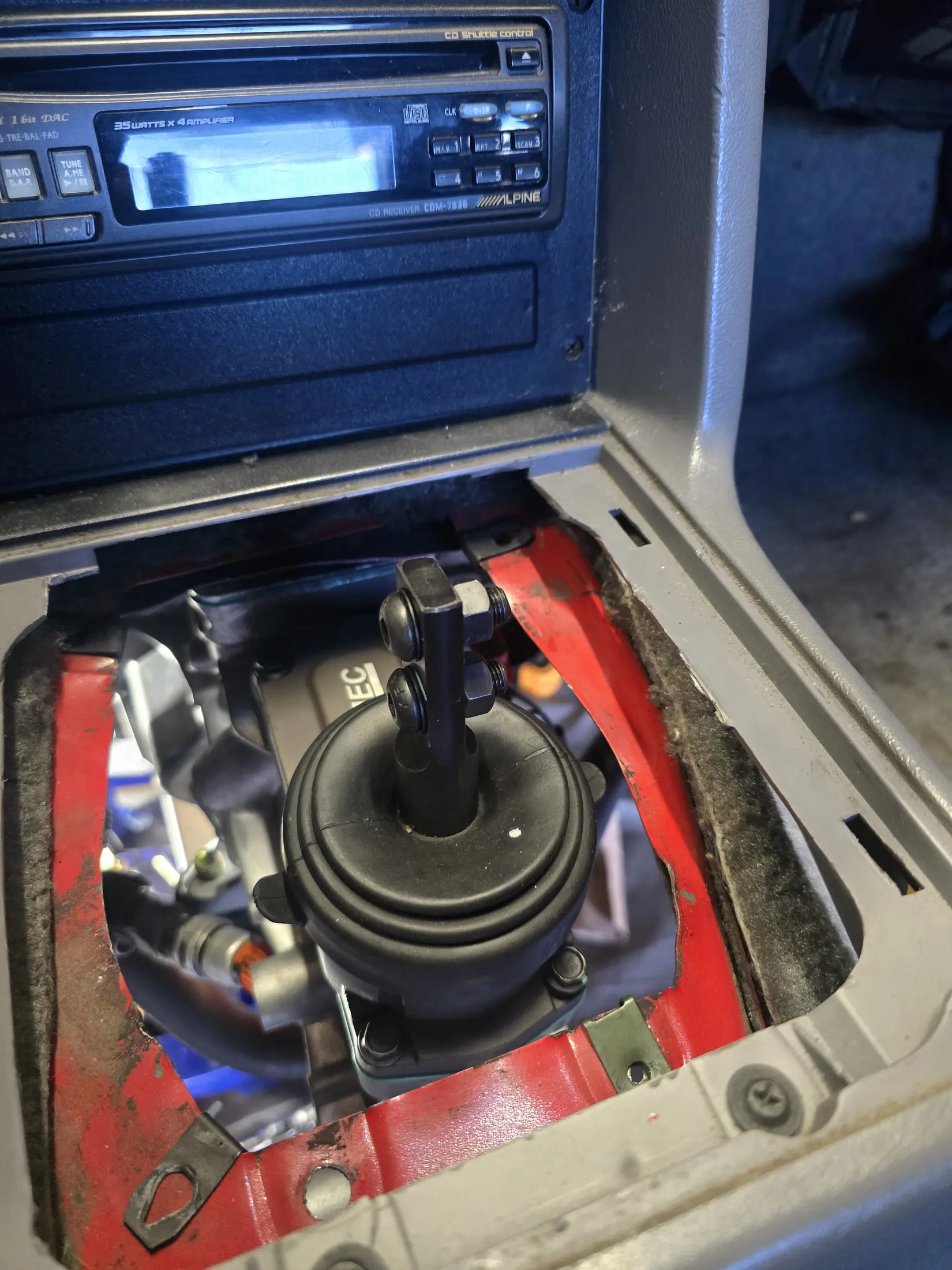

So you have the stock Tremec shifter on there right now? If that’s the case I cannot provide much more help as I removed the Tremec shifter and installed a MGW before the TKX was installed. Not sure if there is a height difference between the two on the base.

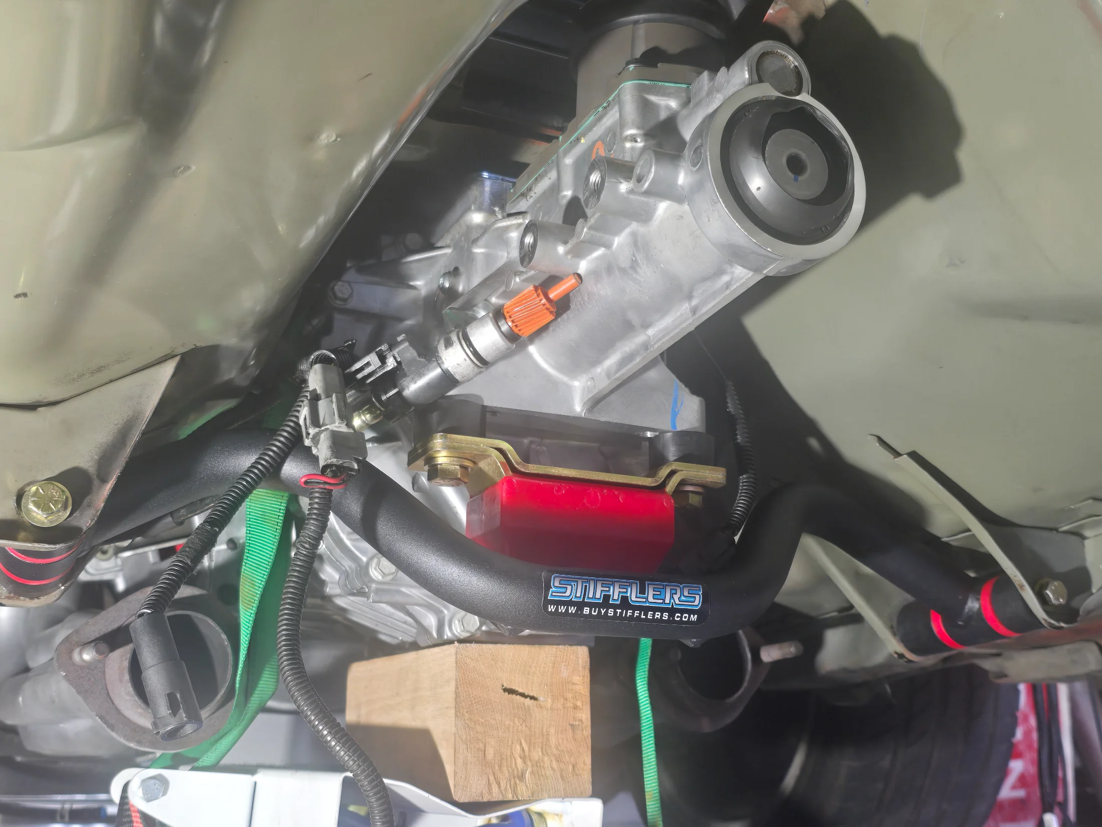

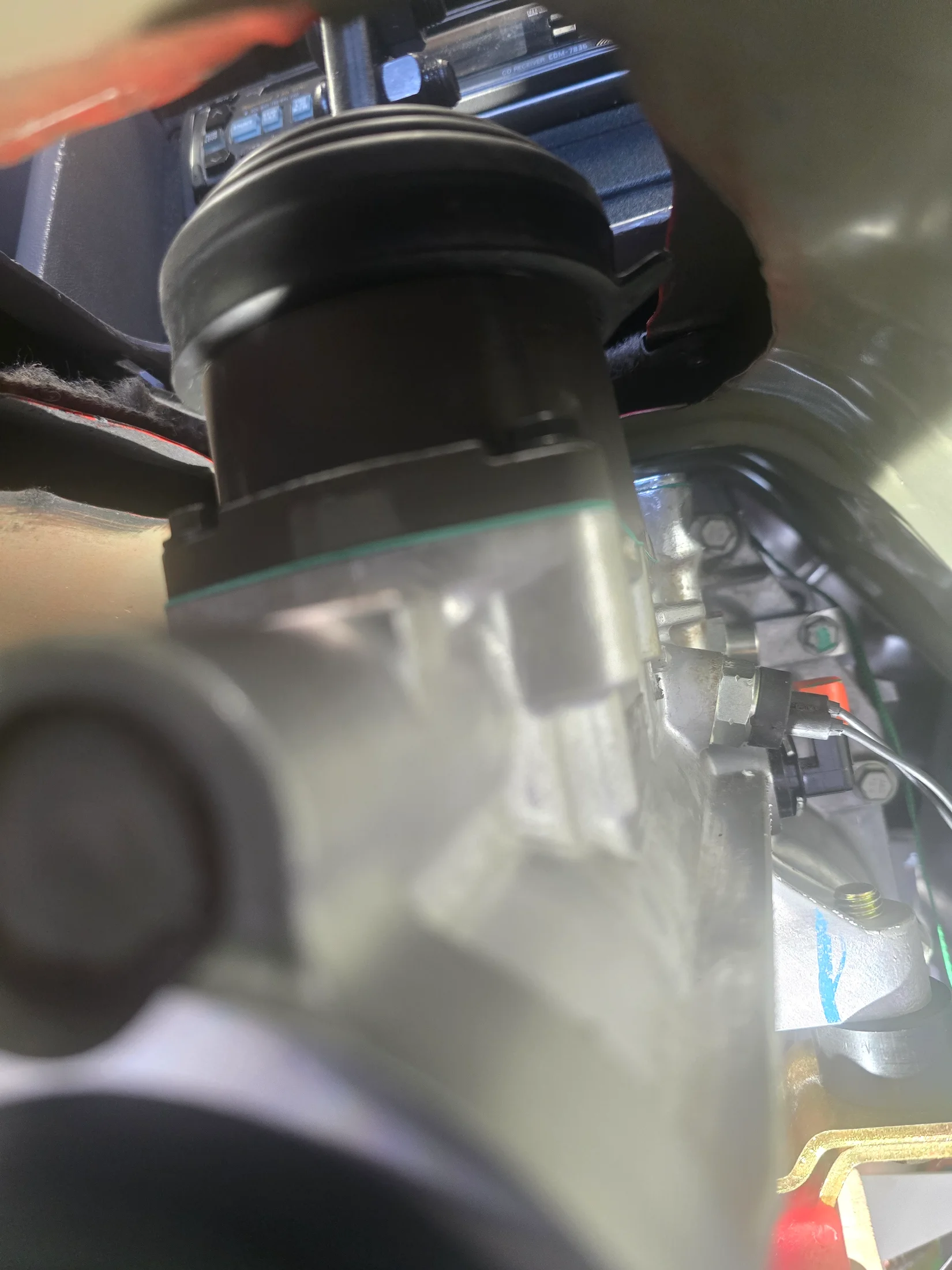

If the tranny is nearly hitting the floor, it's good to go. There's nothing else you can do. My car is a '94 so I can't compare shifter position. The only thing that can raise the shifter position is the crossmember and mount. Yours looks correct.
Thanks for this... so odd though why everyone seem to have theirs flush pretty much in every video and photo I've seen on the installation.
