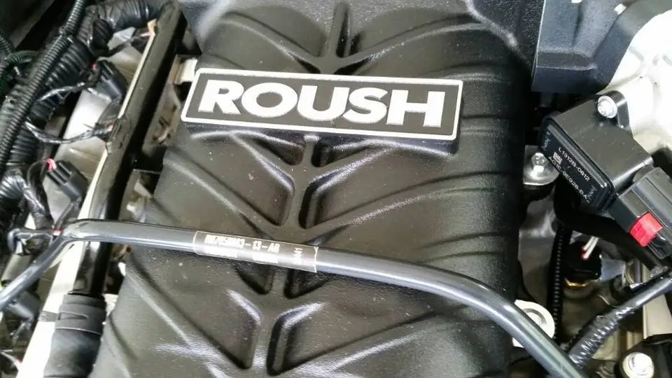

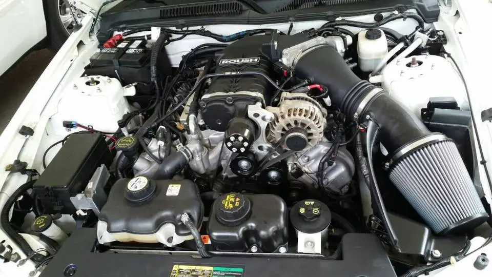

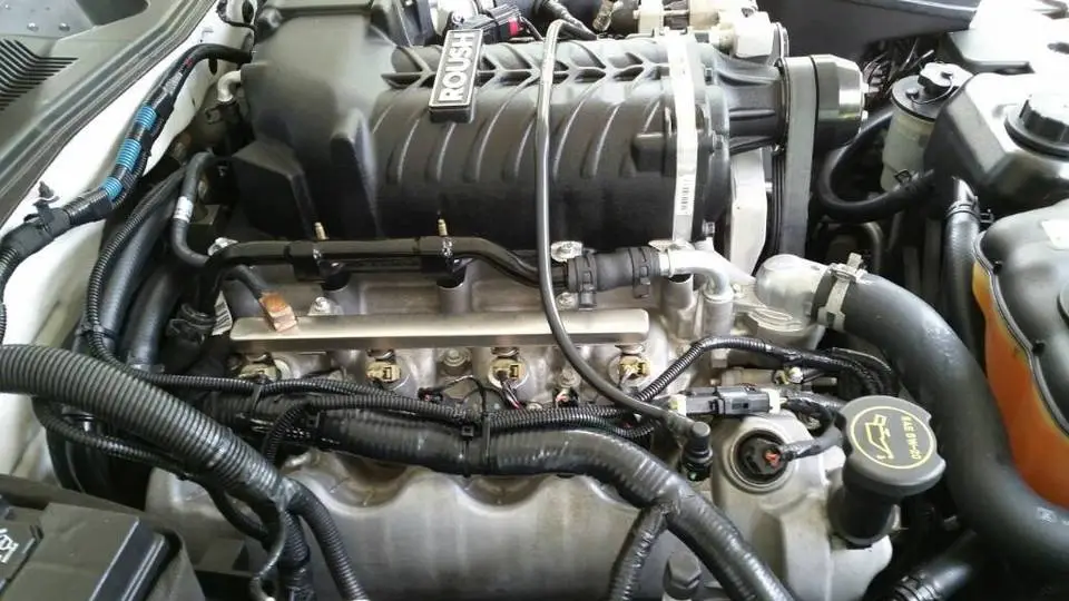

There are no special guages in this car so aside from taking it to someone I don't really know how to tell how much boost it's running. Maybe you guys know more about my set up than me from pics:
