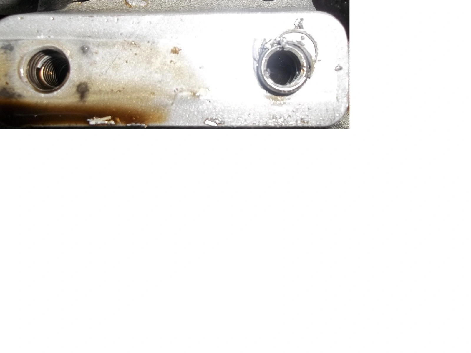

my coupe im having a problem with my roller rockers well just one. number 3 piston the rocker in on the right side. i have taken my valve-cover off n tightened it and its come loose again? i do run my car but hey its built for driving fast any suggestions or ne one have this problem?
Torque is supposed to be 18-20 ftlbs. You could try using a little loctite and see if that would help. I might be a little leary of the red stuff...I think the blue is supposed to be easier to break loose.
heres the problem now...how do i fix it without replaceing the head
