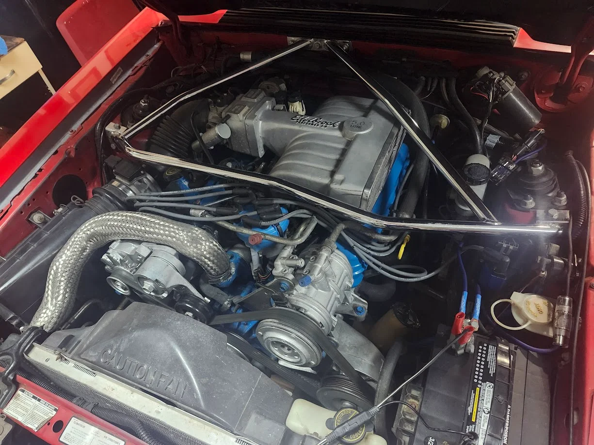

New-to-me 1989 LX with all of the normal goodies. Unknown aluminum heads with roller rockers (or so I'm told, I haven't removed the valve covers myself, yet), unknown cam with a nice chop, Edelbrock Performer intake, BBK 70mm throttle body, K&N filter in stock airbox, BBK shorty headers, H-pipe, unknown mufflers (all 2.5"), 4.10 gears.

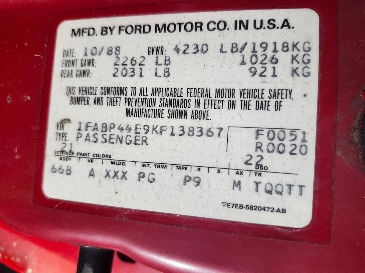

One other thing: If I'm reading the tag right, the car was originally an automatic and is now a 5 speed. I do not know what computer is in it yet.

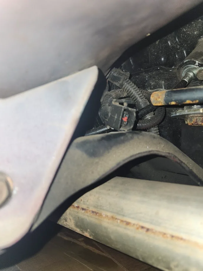

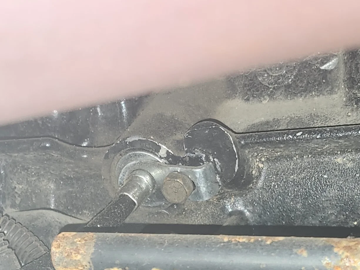

With the help of some suggestions from a Facebook group, I found out that my VSS is missing. I need to do a little investigating to determine what teeth are on the internal gear, but I can order and add the VSS. I'm assuming this is the correct plug, right?
Any reason why it would have been left out? The car has 4.10's, and I think the speedometer is pretty accurate currently.
If I check the indicated speed and it's correct, I just need to I.D. the gear in the tail shaft housing so I can get the right gear for the VSS, right?

1989 5.0's should all have a VSS. Who knows why it was left off. I run into so many folks who misunderstand how these systems work and delete critical items because they don't think it's necessary. In this case the VSS provides a signal to the mass-air ECU that helps it recover idle when you come to a stop. Without it, as you've seen, you stall. Speed density ECU's only use the VSS for cruise control.
Anyway, i believe the speedo gear you already have will transfer over to the VSS once you get it. You will however need a new speedo cable as that one is not compatible with the VSS. My guess is previous owner may have ordered the wrong cable and said "well, i don't need the VSS".
And yes, that 2-pin plug hanging is the VSS plug.
No VSS signal generates a code 29 i believe. So if you dump codes now you'll likely see this code. Once installed, clear codes and redump to see if the code 29 has cleared.

Yes. You don't need the connector (unless yours is bad). I'm 99% sure the speedo gear you already have will transfer over. When i converted my car to mass air I had to add the VSS and can remember only adding the VSS itself and changing the cable. Pretty sure I just moved the gear over
