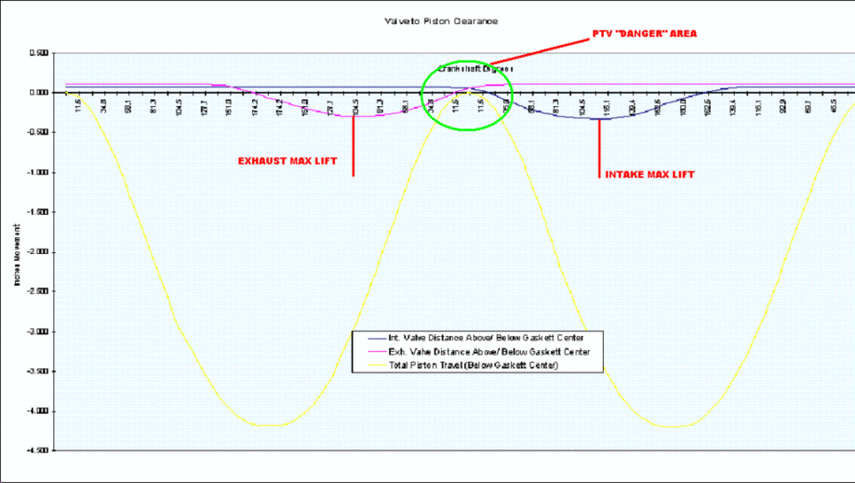

Now the one thing you NEED to check and did not ask about is PTV (piston to valve clearance)
With the 1.6's your total lift will be as advertised - .498. Going from 1.7 to 1.6 will increase PTV clearance. Stock springs can handle up to .500 lift so you will be running on the edge of tolerance.

Total valve lift has nothing to do with the possibility of PtV issues, it's during the overlap (or exhaust to intake cycle changeover) that the valves and the piston could get intimate, as shown below.... when maximum valve lift is reached, the piston is >1.5" below the deck.
