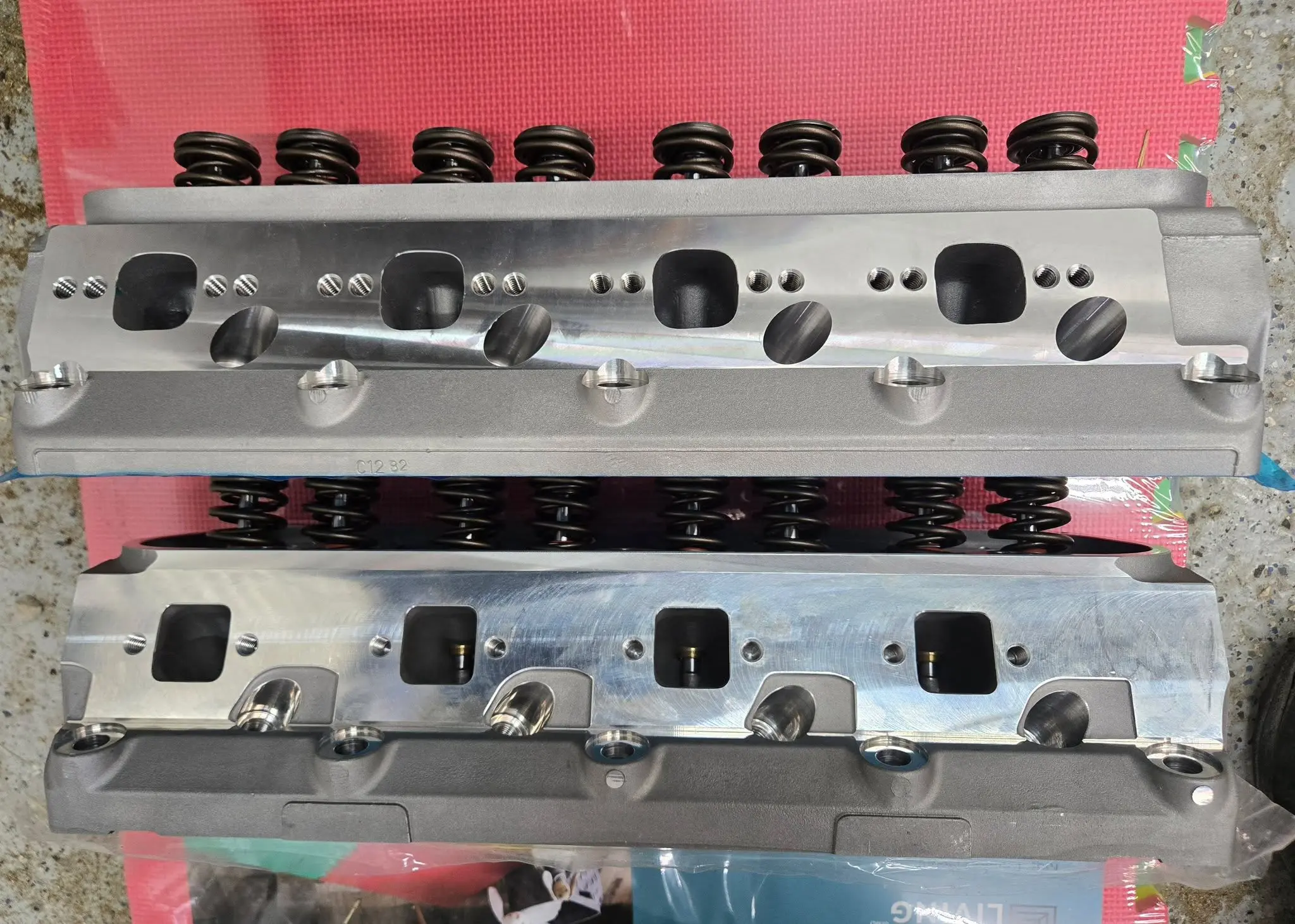

Vevor shipped 3 different China heads all under the same part number, I bought a few sets to get the castings I wanted on the cheap, but only used the valves everything else got replaced, even with a stock cam I'm not an fan of most hardware box stock heads ship with. I sent the ones pictured back, its the same as the current speed master casting, updated tooling so not an exact 1-1 as the 7yr old ones you have.. Now they only seem to ship the ones shown in the picture, which is the Vic Jr clone, same as speedmaster 175. Valvetrain damn near identical too speedmaster but still kind of junk for any decent cam profile. Springs where in 120 range seat on an rimac spring testor. That channel has a couple videos of that head, not the way I would do them but gives you decent info.
The other castings where the dart pro1 clone aka afr enforcer / blueprint casting but with 2.02/1.60 11/32 valve stem. Can still source them from aliexpress or Alibaba just not as cheap as threw vevor was
And the third was Steven suns 175cc head, cloned off the afr heads. lmr sells That as the new sve 170 head, the older one used stevens edelbrock rpm clone casting. His larger dealers seemed to have talked him into fixed pricing, as the prices of those jumped way up and even forced lmr to raise the 185cnc version an extra $300. You could pretty much get the same sve 170 lmr sells for 1k from vevor back then for $440 a pair. A certain person/ PE group who's tied to too many companies now, that I refuse to do any buisness with was trying to hawk the same heads with his branding as 165's for over $1500, some got them for $450-500 threw vevor with promos. There just Stevens 175 casting with low end hardware, its actual a 177cc runner when poured.

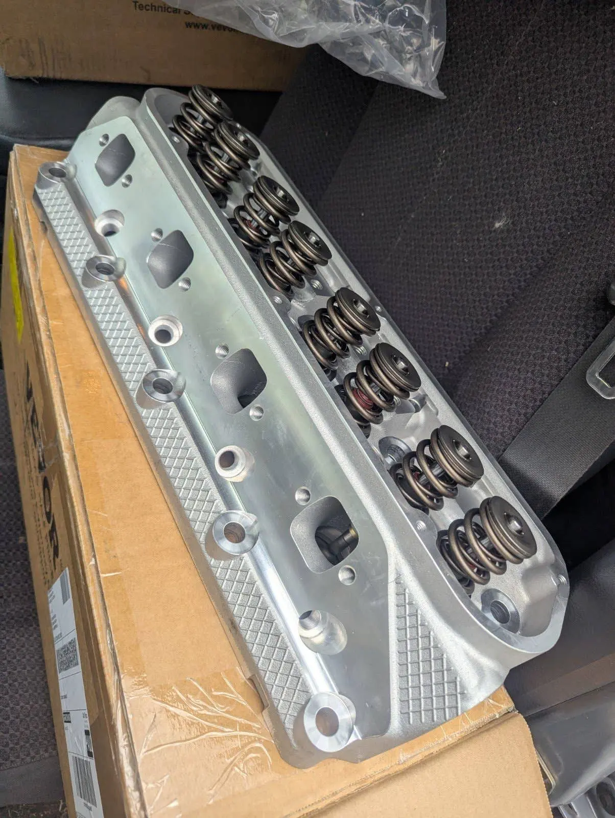

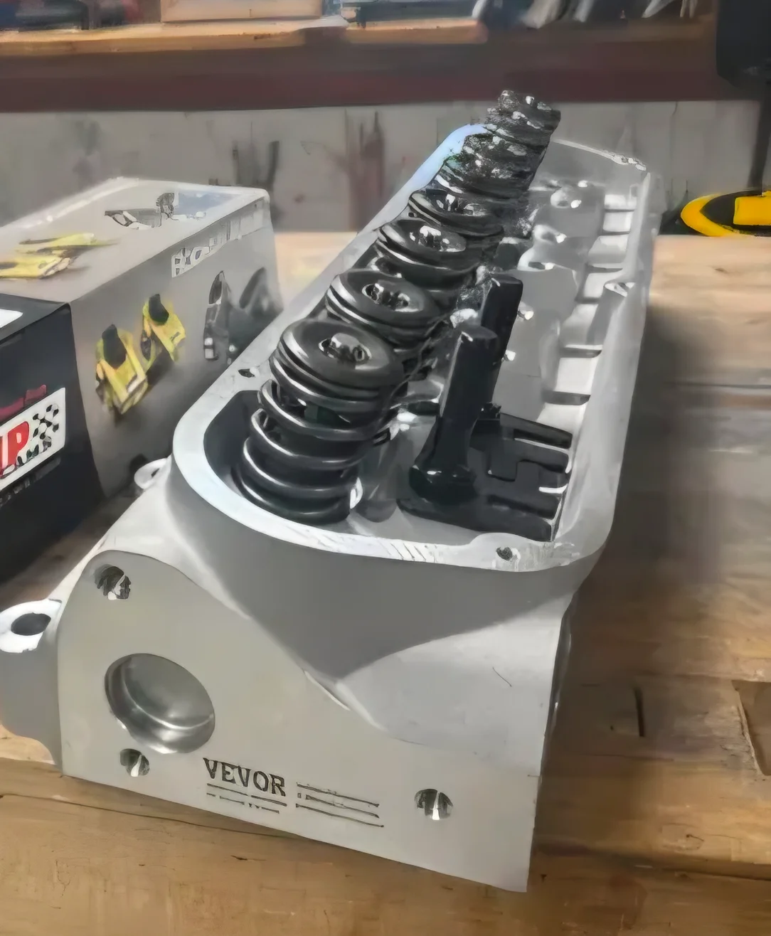

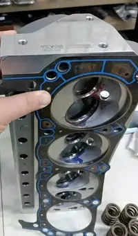

Every set I did was about $1k invested, that's using BTR chromoly hardware for locators and retainers, arp studs and afr split guide plates, then who ever had the best deal on Pac dual LS style springs, I used trickflows branded 16306-16 on the last set, same pac springs they use on the 11r heads. Then you have pushrods, head bolts or studs, gaskets, rockers etc... I wanted the 175cc Steven sun castings that looks like the sve head since I owned there other 2 before, still have the China dart clones on my beater gt I bought a long time ago just not vevor branded ones.
Best out of the box is probably the sve looking one for flow but dart clones right there with it, the dart clone down side is its a 63-64cc chamber, I ported mine so wasn't worried about how they came from vevor, was just the cheapest way to get bare castings and basic valves with a semi decent valve job all ready done on them. All these are vevor, same part number, 3 different China suppliers vevor got them from and branded, but now I only see people getting the pro comp speedmaster version which is the 1st and 3rd pic. Second and 5th are the Steven sun afr based clones, and 4th and 6th show the dart clone with the dual drilled exhaust pattern.

If the vevor heads end up around 1k and the lmr casting is the preferred cast wouldnt it make sense to just get the sve heads from lmr themselves comes with adjustable guide plates and rocker studs good springs retainers ect
Lmr doesn't build heads such I suspect the valvetrain is all as shipped from china/ Steven sun... I don't trust China springs, retainers and especially there keepers, Steven doesn't manufacture springs or retainers/keepers, he's does aluminum castings and machine work...... the 10 degree keepers on the vevor heads are ugly and I would never run those without replacing them. I have not had the new sve heads in my own hands yet though so can't speak on the actual hardware used. Only thing I can say is so many branding these import casting lie out there ass with " advertising".
Dart has the 205 version from steven sun for about 599 but only the 62cc chamber ones left and its 2.05/ 1.60 hardwares decent enough as shipped since they build the bare castings out. Would work for a n41, but too big for a stock bottom end without fly cutting the pistons.
You might want to wait for black Friday deals to see if promaxx does anything in the 1k range or lmr does a discount which seems to be rare any more., promaxx heads are Steven sun castings, max175/180 is either the 175 afr clone casting or Stevens eledbrock rpm casting I've seen both sold as the max line
There project x is the afr clone from Steven either with the 185 or 205 runner option.
So many are branding the same 5 or 6 China sourced castings now its not even funny, worst has to be monster with there frankenstein m20 heads asking $3500 for a $150 china casting after he cnc's them and loads them with valvetrain.

For a mild combo yes have them measure the springs to see if they will handle the cam, get the seat and open recommended info on specs from anderson, definitely have them replace the 10 degree 11/32 keepers and possibly the retainers if the new keepers fit them poorly.
I bought a set $500 was a steal $300 for springs retainers and locks from comp cams was a no brainer. Arrived today looks like i got the speedmaster casting, think im going to keep em and run them i cant imagine the flow numbers between the 3 are vastly different. They look pretty good for the $500 price tag no complaints here
