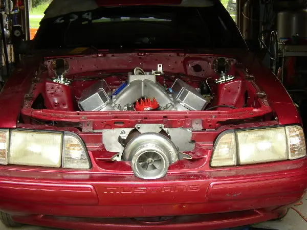

dont need a bbc when u have a bbf and a small turbo. this was my set up before i had my bike wreck. 547 ci 101mm turbo.
here....
440 SBF in a RDI aluminum block
ford racing yates SC1 canted valve heads (far from cheap... be prepared to spend more for the heads then 90% of you have in the a long block)
ford racing intake to match
14:1 compression
custom cam
thats the basic combo of the race car. thats making close to 1000NA with the nitrous cam
