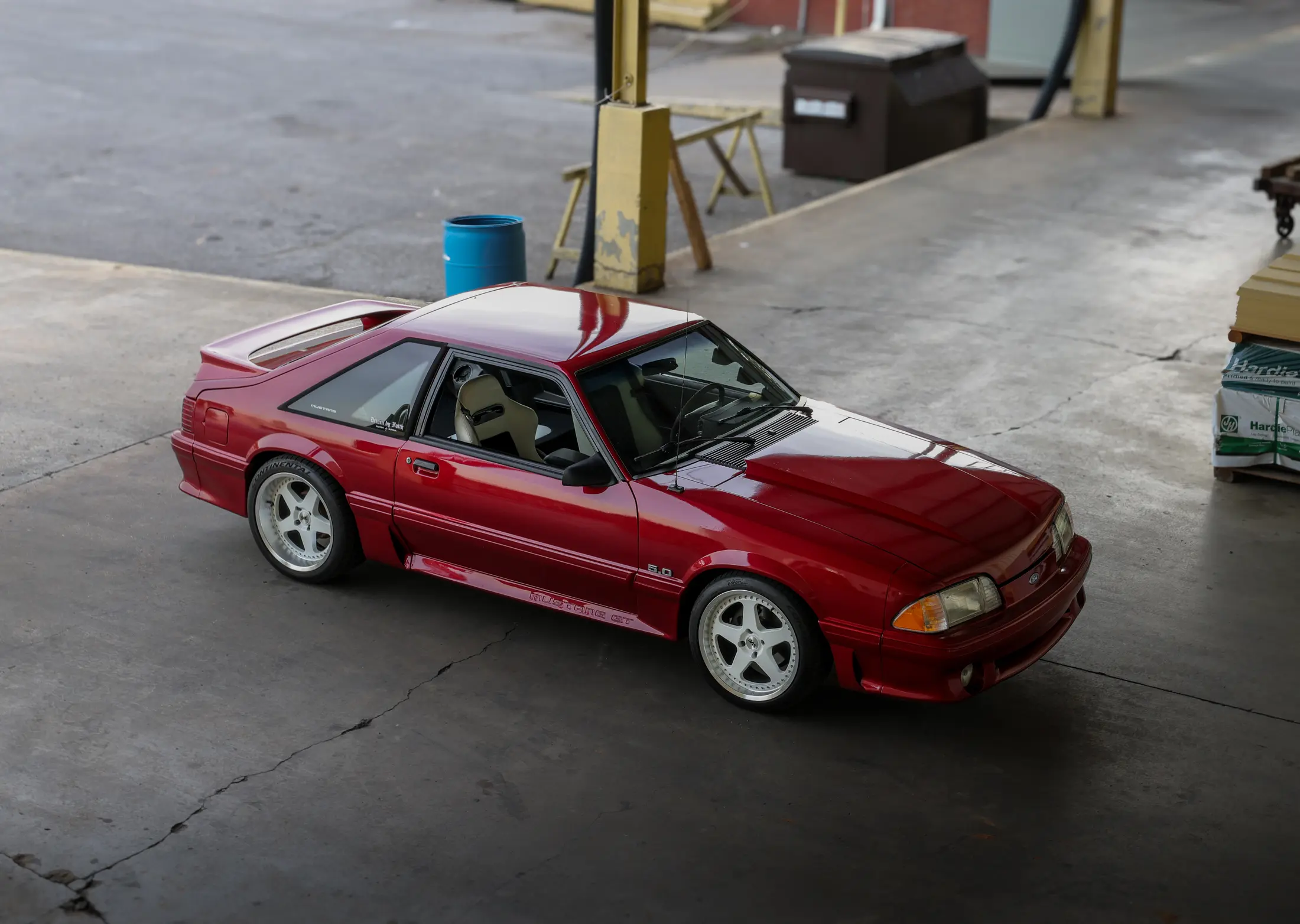

Super clean! very nice. For a H/C/I setup like you have picked out, you wouldn't need to do anything to the bottom end. They are known to handle roughly 500hp and its the block that splits not necessarily the internal components failing. The TrickFlow heads and stage 1 Cam should also work with the stock pistons.
