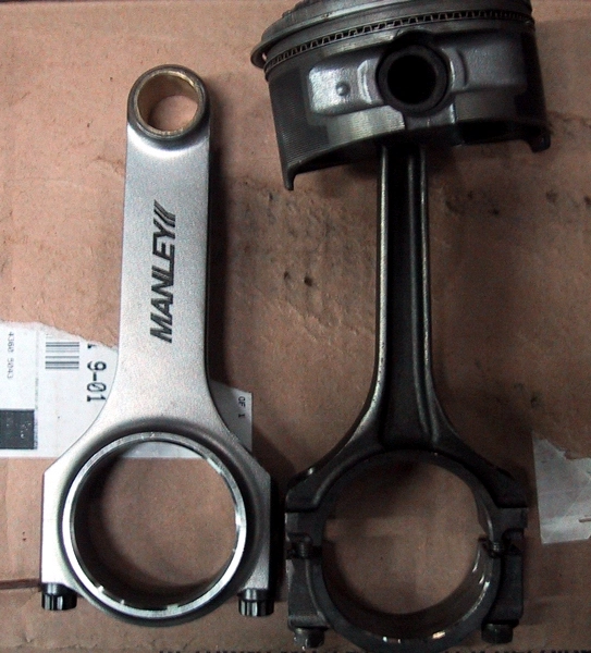

Block strength is :bs: A modular block will handle more power than you probably will ever put down. I don't think I've ever heard of a modular BLOCK failing. Cases where a rod gets thrown or piston blows apart and nukes the block doesn't count.
The lower compression ratio is a valid point, not sure to what extent though.

yeah the CR may be lower but its still packing those crappy hypereutic pistons.

The issue isnt in the block both are about the same. The issue is the stock rods and pistons. Hyperpathetic pistons and thin cracked cap rods are not the best choice for a 450+ HP motor they tend to want out of the block.
