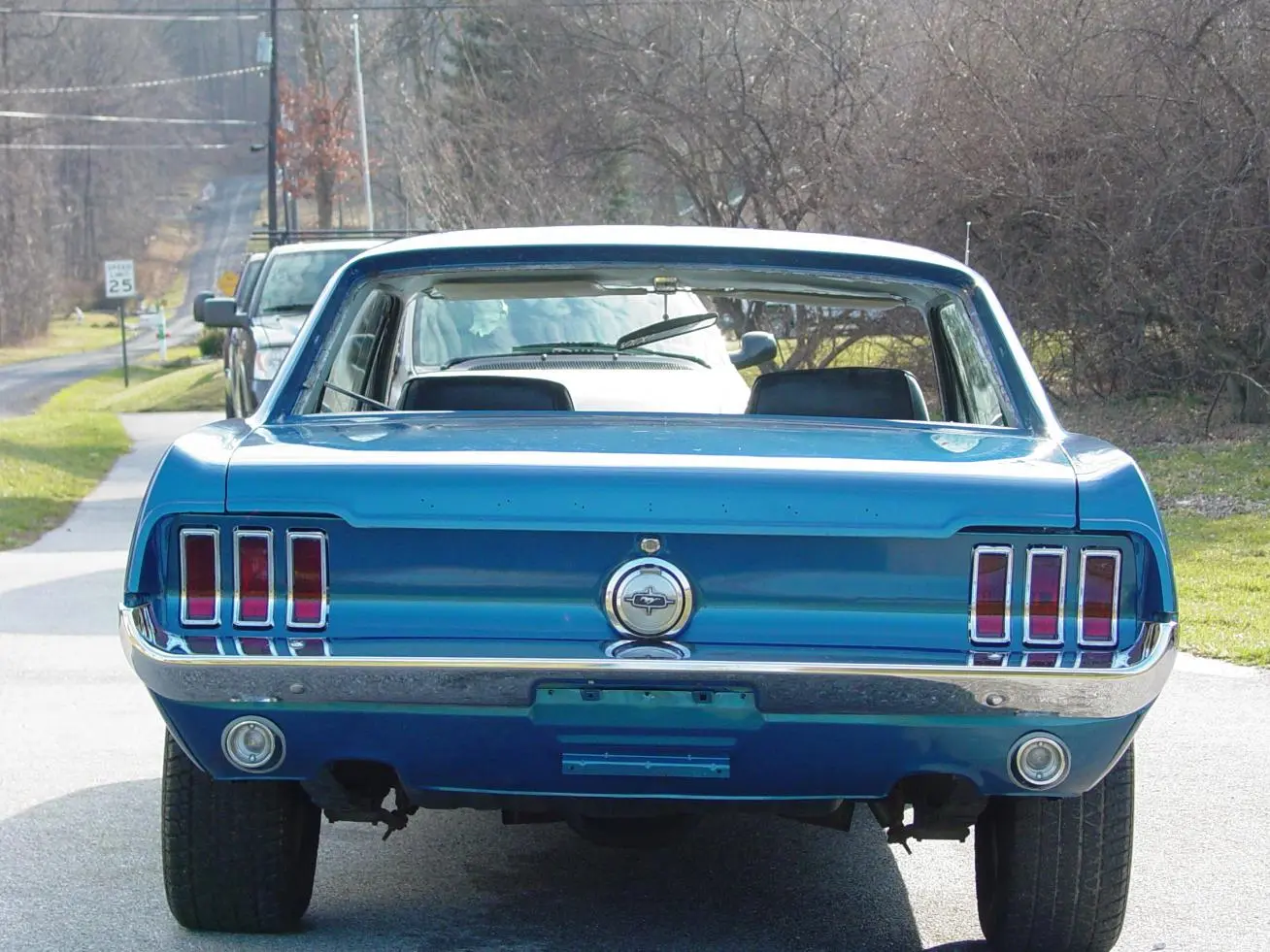

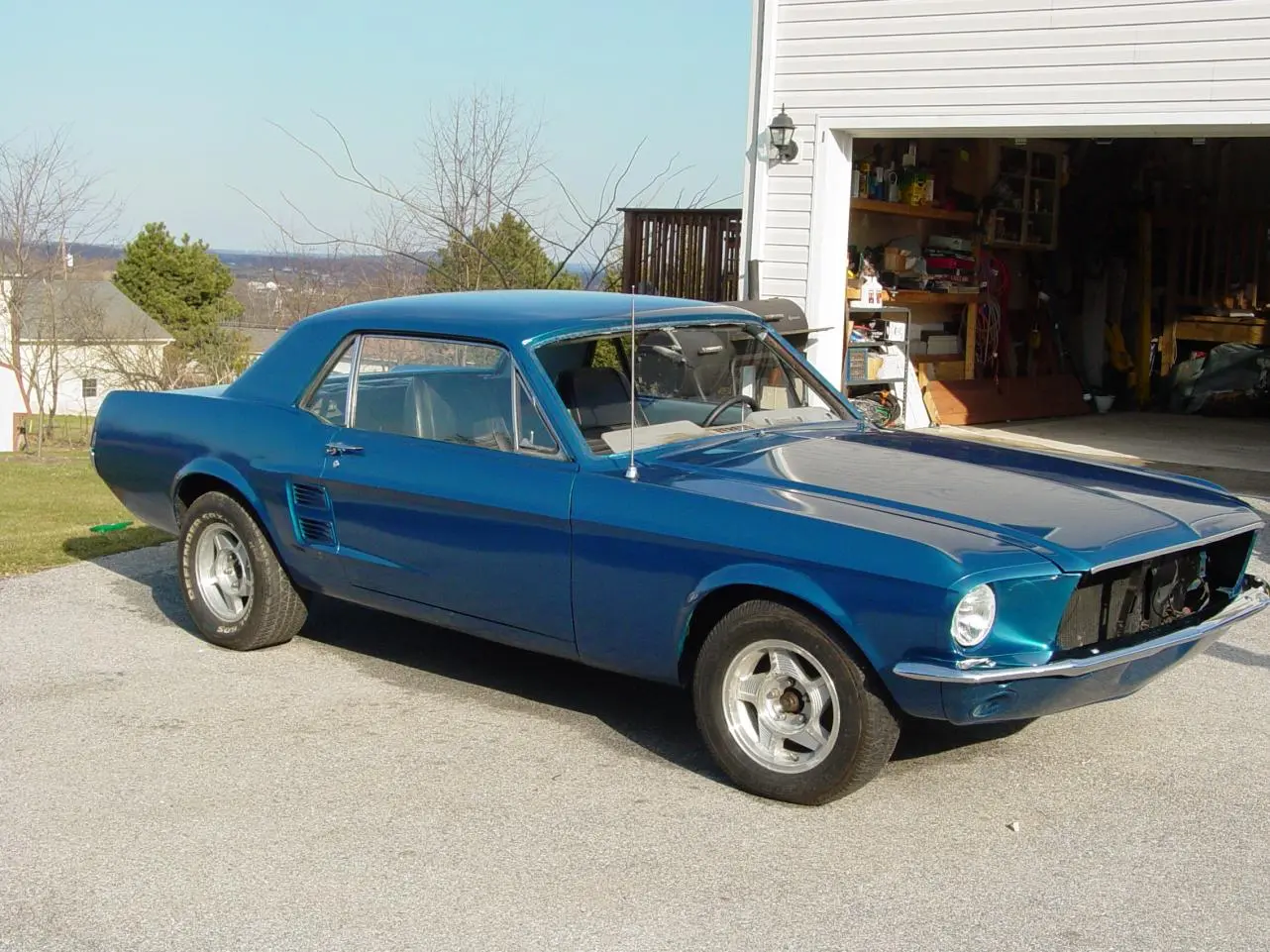

Did you think a bit wider looking 245-60-14? You can get the BFG TA in that size, they are in stock at TireRack. That is what I am getting to replace my current tires if I don't go with some new wheels. Although not sure what the stock wheel specs are for if it would fit in the well? I am running the 245's on the back and a 195-70-14 on the front. I don't think it looks bad, and it gives the illusion of the back being wider than they are.
I think it looks good.
