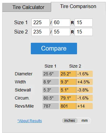

The stock 10 hole rim on an 85-93 foxbody was a 15x7. Stock size tire was 225/60/15 (unfortuately I don't think many tire companies make this size anymore). If keeping the stock wheel, the 235/60/15 is probably the closest you can get.
The aftermarket does make a 15x9 and 17x8/9 available at LMR. Some have had the stock wheels modified to 15x10 or as small as 15x3 or 4.
A general rule of thumb (but not a hard one) is to target a tire size that is 2" wider than the rim size.
So a 7" wide rim would be 228mm (9") of tire, which is why the OEM size is a 225. You can usually stick pretty close to this so I wouldn't go beyond a 235 or you start getting too much sidewall bulge and flex.
A 235/55 would be just a tiny bit shorter than stock, which might be good if you are lowering the car. A 235/60 is 26.1" in OD. Works out back, but might be tight in the front if you are lowered.

thank you! I ended up choosing 235/60/15's! :cool:
