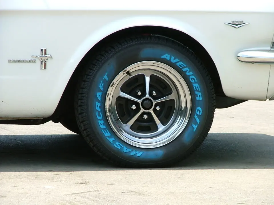

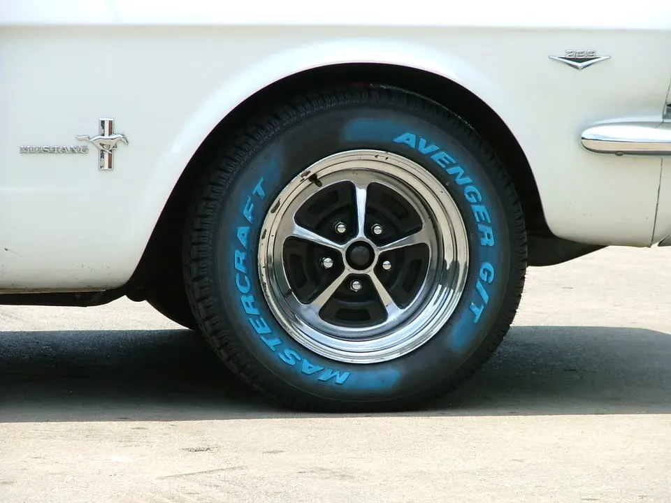

i run the orginal magnum 500's on my 65. although our body is different i run 225/70s all the way around. enough meat to firmly plant you dont but nothing overkill.
my rims arent as nice as yours may be but they are orginal.
Those 70 series look pretty good, and 225's are a fine width (although 245's in the back would be fun...I would rather achieve proper fit than deal with occasional rubbing).
