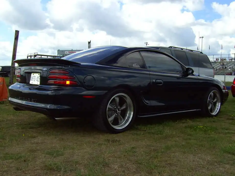

you may have some... probably alot of clearence issues. tire rub will most likely be an issue and turning radius will go UP due to the decrease in angular movement of the tire. It also may look a bit LOW RIDER like.:notnice: I think you may be able to find a tire with a smaller lip for the front but not flush like most
eg. not my car :D
