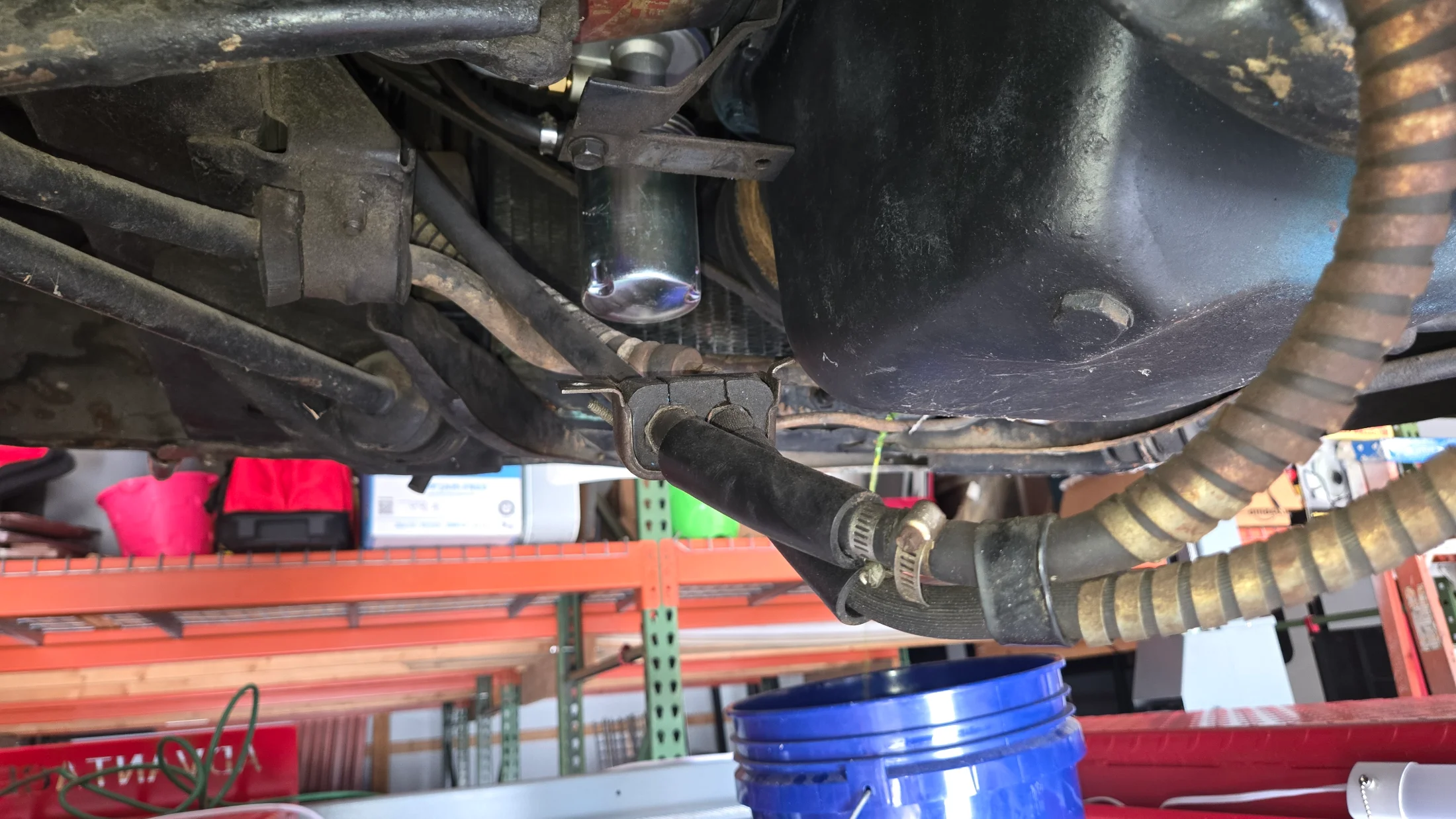

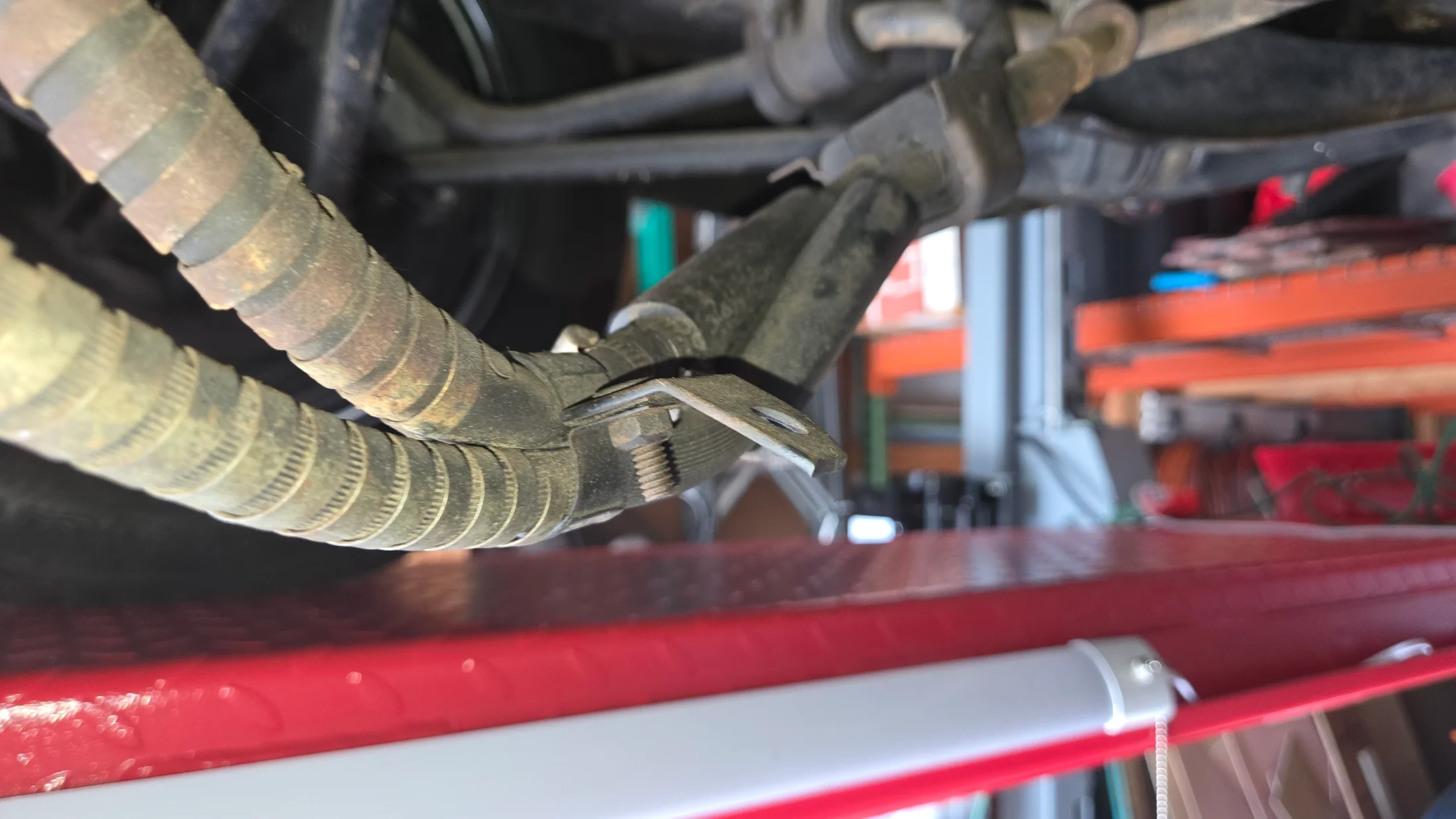

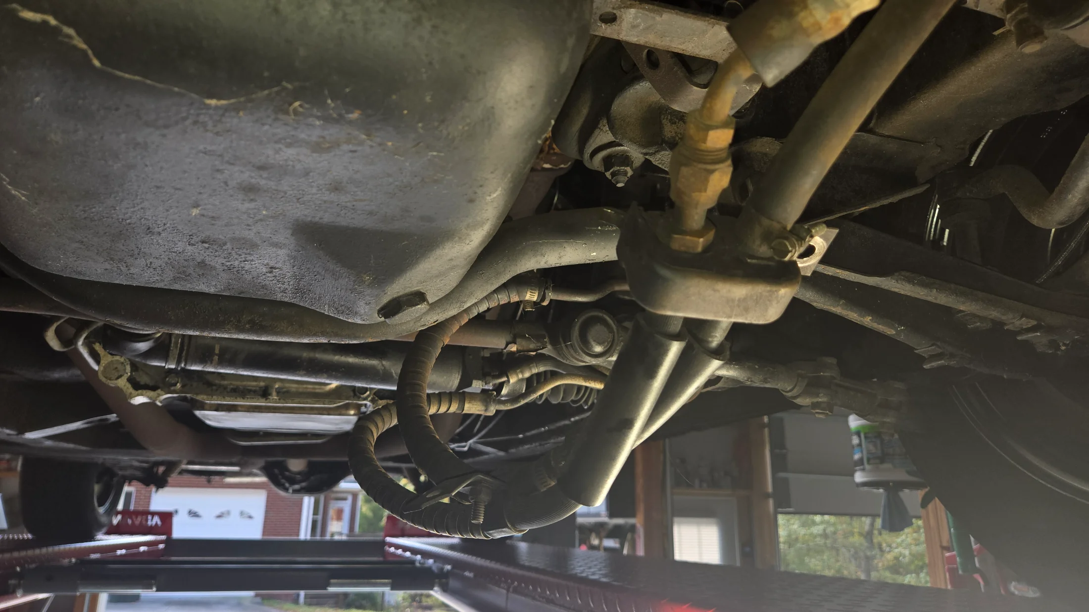

Hi all! I'm getting my grandpa's 1964.5 289 convertible back up and running. The hoses for the power steering are hanging down and I need to figure out the proper routing of them. I think I know where the big rectangular bracket goes, but I'm not about the angle bracket. Please see the pictures. Any help is much appreciated!

I determined that my car appears to have a power steering system from another car and not the factory Mustang system. I bought the correct bracket that doesn't bolt to the oil pan, but the hoses are still drooping. For now, I wire tied the hoses up so they won't get caught on anything on the ground.
