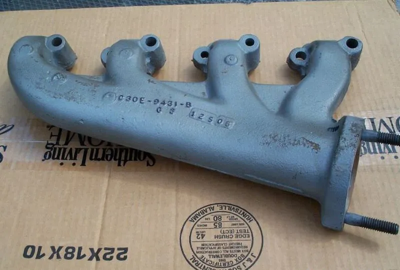

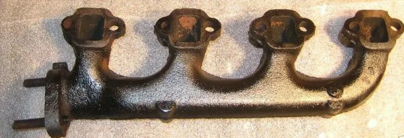

Also, I am considering the HIPO 289 manifolds.
I switched to them when I ditched my headers.
How much power will I lose if I step down from the long tubes to these?
Maybe 10% at high rpm. On the other hand, at low rpm, they'll actually be a bit better than long-tubes.
Are the HIPO's a lot better than stock manifolds or is it just hype?
WAY better than stock manifolds. No comparison. The stock ones are just straight logs. The HP is more like a shorty header.

Although they're no comparison, did you compare them to the stock ones anyway in a back to back test?
No criticism, just curious.
I know they look much more streamlined, but I'm curious how much of a difference they make. I guess enough for Ford to bother with them. On the other hand, not all factory parts are effective and well designed just because Ford bothered with them.
I have never seen a dyno test of the stock logs. They suck so bad I think nobody really wants to know.
Ford sold the HP manifolds as late as the 1980's as a performance upgrade.

I read somewhere, I think it was at mustang monthly on the web about a dyno on these. They tested the factory logs, the hipo's, and the try-y headers. The Hipo's showed 1 more horsepower but they said that it was likely due to using the same 2" exhaust.
2+2GT
Apr 25, 2009
3,333
10
79
Southeastern Pennsylvania
Dec 4, 2009
#11
  • Dec 4, 2009
  • #11
Considering the increase in cross section of the ports, I'm gonna be skeptical of that number. A clutch fan will give about 5 hp, to give some context for my impression. 2" exhaust is not so restrictive for a 289 CID engine. The 67 GT500 428 dual-quad engine came with 2" exhaust, fer cryin' out loud.

The hipo manifolds will probably hold gaskets better, but I wouldn't rule out shorty headers. They don't give up that much to longtubes. Heck, even the stock shorty headers from a 5.0 Mustang wouldn't be too bad.
