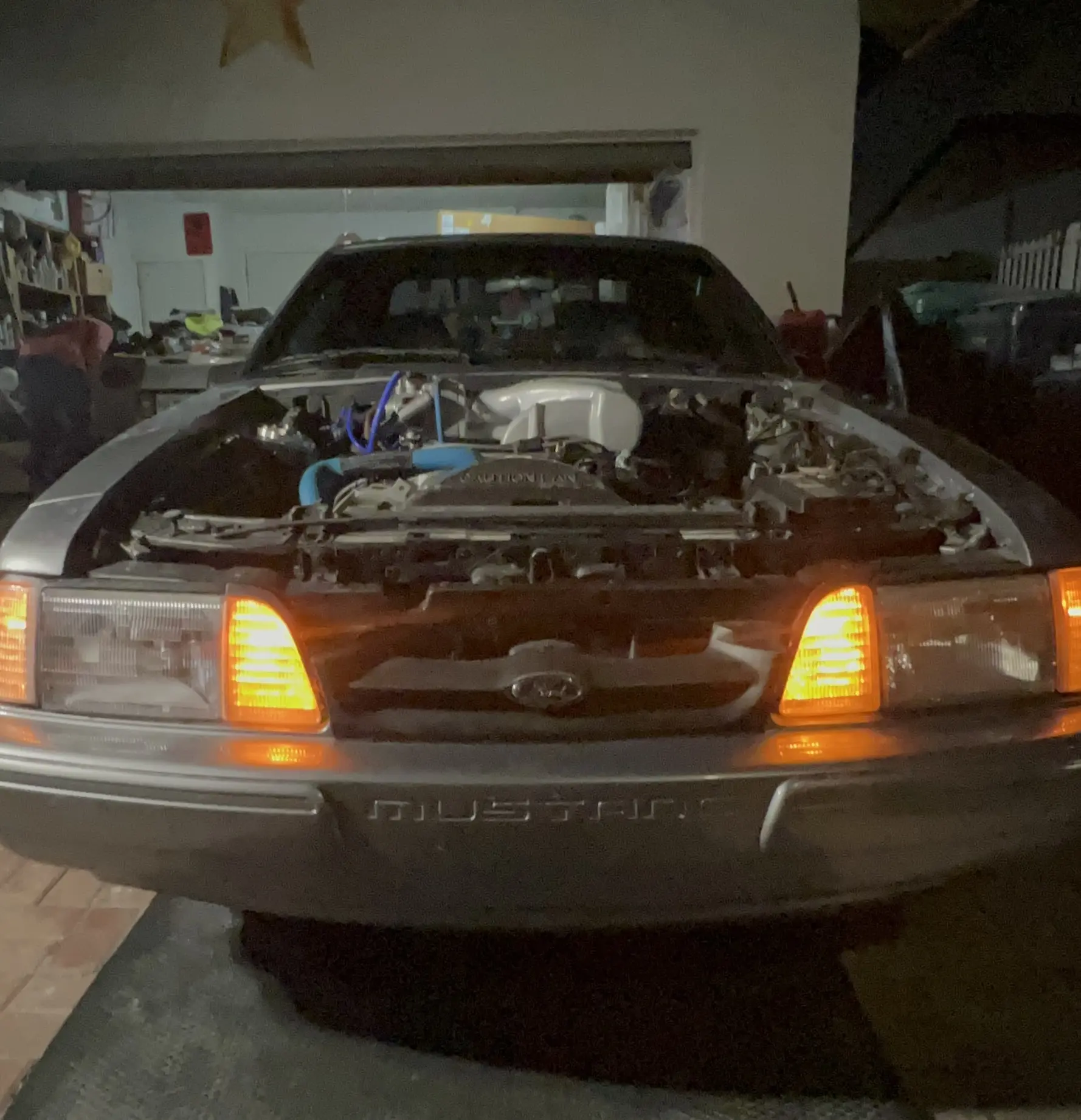

long time no talk fellas, I know I haven’t updated the thread in a while, but long story short I ran into a friends mechanic who offered to work on the car, but on his spare time.
3 months later….
The foxbody is finally back from the mechanics and so far, the motor swap was successful.
I’m having issues uploading videos on my phone. Will attempt to upload again on a desktop computer later.
Good side,
Since the motor swap, the car has no more vibration & zero miles
However, I’ve encountered a new concern where the car is running rich on fuel. I’m going to try to upload a video later, demonstrating black smoke when giving throttle. (It’s good to note, the car is currently running on stock 19lbs fuel injectors and not 47lbs)
In addition there’s a separate concern with the idle, which might be a mix of the E303 cam clashing with speed destiny & no mass air sensor. .
I’m going to try to Band-Aid the idle problem tomorrow, in hopes it can be driven but I believe my next step will be to purchase a aftermarket tuner. (More than likely Holly.)
I’m also running into a problem where when I attempt to drive the car it wants to shut off on me…
Again for my visual learners I’m going to send a video later today bear with me, please.
Thank you

Make sure he hooked up vacuum to the MAP on the firewall and there's no vacuum leaks, good idea to kind of treat them like old carb cars and check with a decent gauge or smoke test it... Lots off ppl forget about the MAP on the old Sd stuff, or leave it off because there used to mass air on these cars and it could cause some of the issues your having, but pretty easy to check. Might even be worth throwing fresh o2 sensors in it if they used the old stuff. SD should be able to idle that combo fairly well, timing and fueling wouldn't be perfect but enough to drive it until you switch to something better.

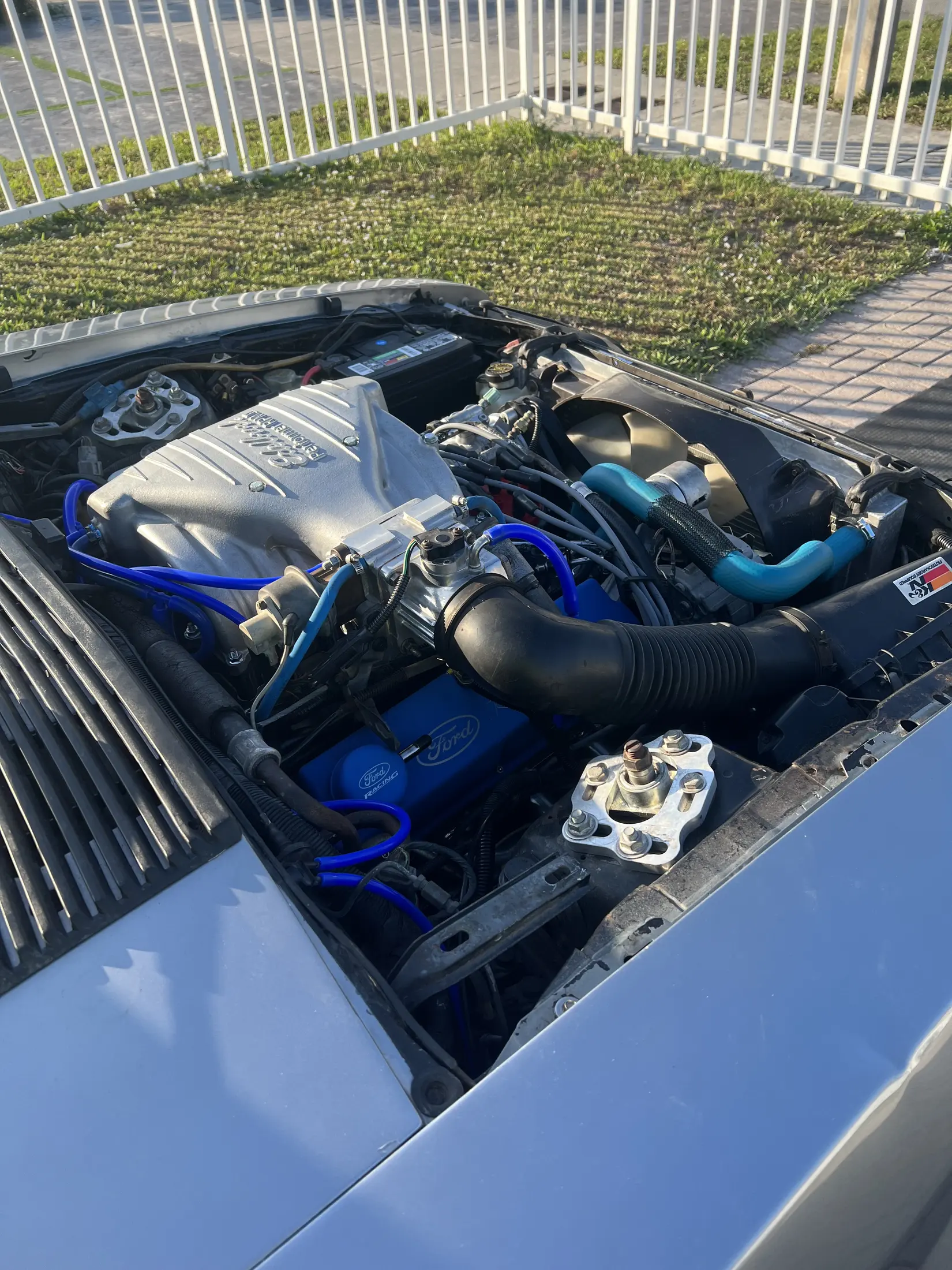

If anyone has an RPM 2 manifold, can you guys tell me what hood are you using because my stock hood doesn't have clearnace now.... I'm thinking of swapping motor mounts, and maybe get away with a 2" Cowl hood..really trying to avoid the 4" -___-.
Stock hood should fit, im guessing they used a spacer and taller valve covers though that raised it up. I like harwood for bolt on hoods but I'm biased and those things are priced stupid now + freight.
Running an RPM II with a 1” spacer due to tall valve covers to clear the Jomar valve girdles. Have a 2” HO Fibertrends and have right at 1/2” of clearance.

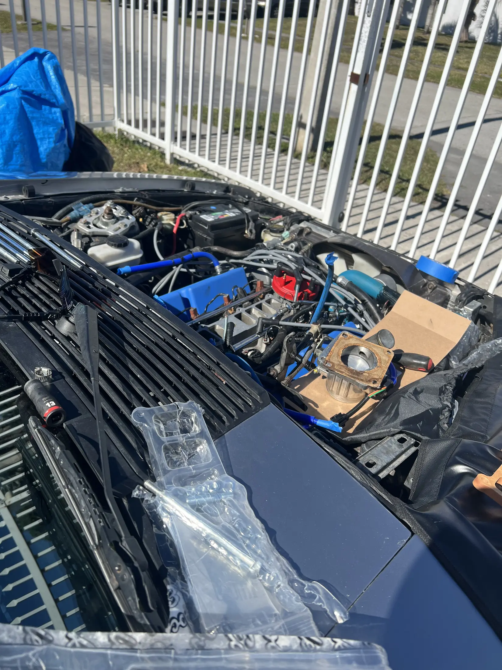

Currently working on the following:
  • Installing the adjustable fuel pressure regulator ( I'll check fuel pressure at the same time)
  • Installed the new intake spacer (still didn’t give me the clearance for the stock hood), waste of time lol
  • Purchased a timing gun to time it properly - Im hearing it's recommended to try 12 or 14??
  • Removing the fuel injectors to have them tested, if replacements are needed.
  • Checking TPS voltage since I recently swapped the TPS sensor and did not check the voltage after the fact.
@rednotch – Had I known the taller valve covers were going to cause this issue, I would’ve avoided them and gone with short covers . That said, I already bought a 0.5" spacer, but even with that, the tall covers won’t allow the throttle body to bolt on. Because of that, I’m hesitant to buy a 1" spacer since there’s still no guarantee I’ll have enough clearance
So for now, the hood is on the back burner. The stock hood won’t fit unless I swap valve covers, and honestly… F$%K that I'm loving the blue covers .
@Mcmahst – I have a friend who’s going to run a smoke test for me. I’ll update the thread once that’s done.
@General karthief – I'm hoping the smoke test shows me a leak, cause I can't find them. I'm also considering the Holly X once I save up. which should control the idling. I'm just trying to band-aid the issue without an MAF / nor a Computer for the time being.
