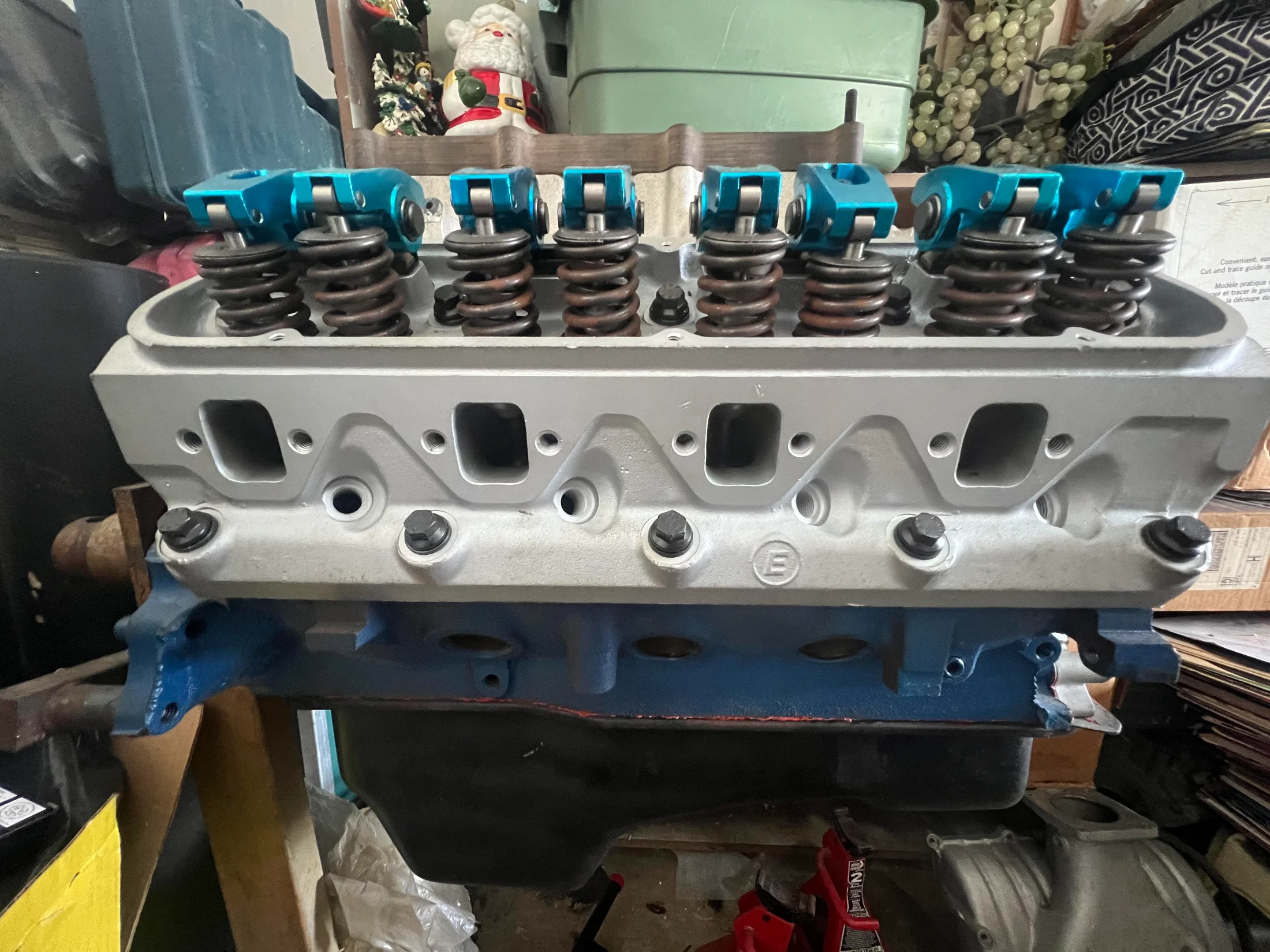

Hello Everybody,
Introduction
I've recently picked my project car back up. A 1988 LX 5.0 Mustang that’s been in my family for over 30 years! It was also my first car back in high school (2012), and it holds a lot of sentimental value. Now, I’m aiming to finally complete the build over the next few months.
I started this project over 10 years ago and picked up various parts along the way. Unfortunately, I didn’t keep the best records at the time, but I’ll list everything I know as clearly as possible below.
Let me know if anyone wants more info or has advice on next steps. Open to all feedback. Especially around prepping a long-stored motor or if transitioning from speed density to mass air flow is recommended or needed? Especially if I want to add an entry-level Vortech system. I also have no clue what kind of fuel injectors I should get.

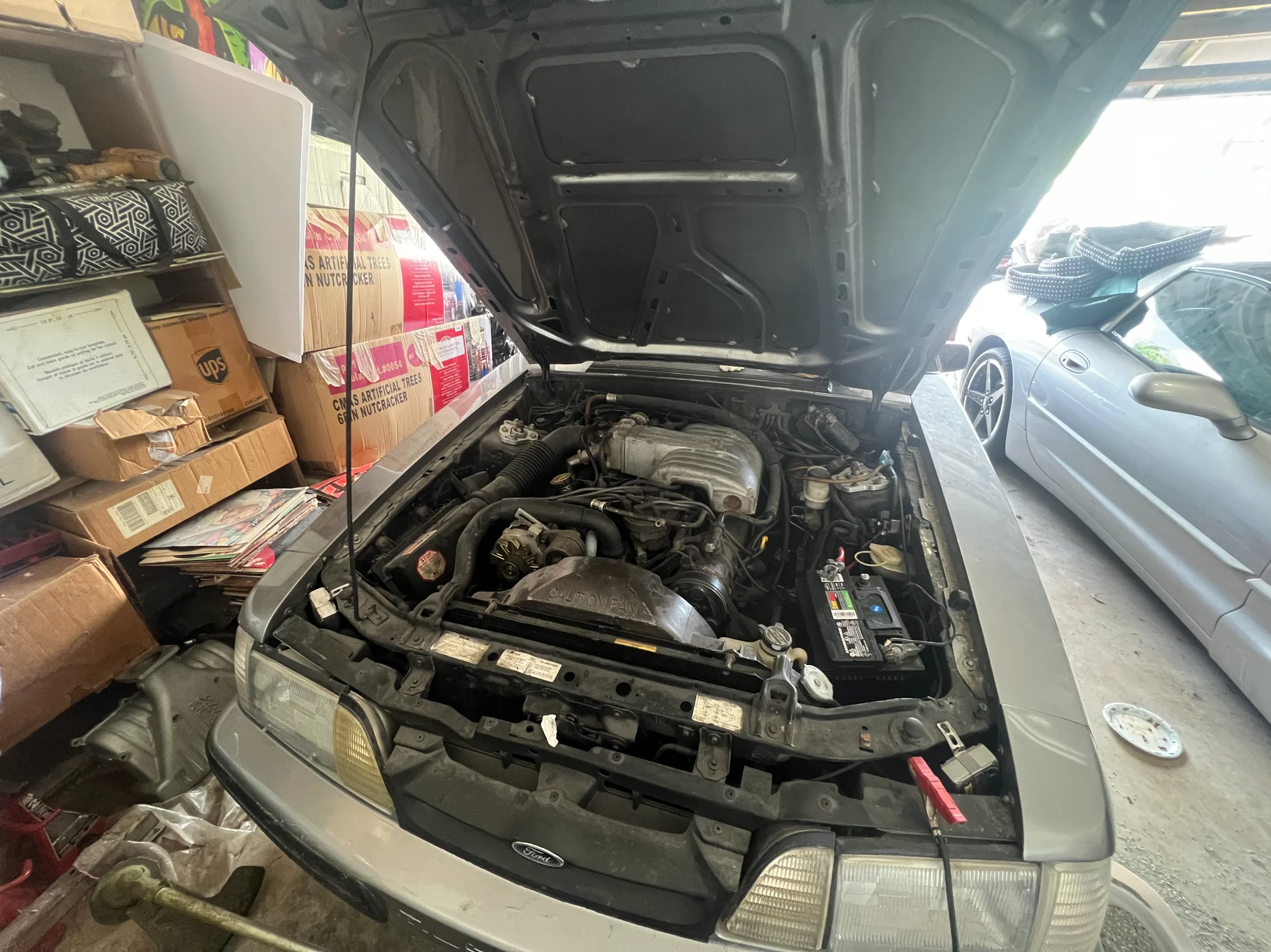

Background on the Car:
This ’88 LX 5.0 has been in my family since day one, bought new by my dad in 1988, and only passed between him, my uncle, and me. It was my first car in high school back in 2012. It's been sitting for over 7 years, and I’ve recently started bringing it back to life.
Last month, I changed the fuel tank and pump, topped off all fluids, and was able to get it running. To my surprise, it fires up on the first or second crank!
Thanks for reading!
Car Details
  • Year/Model: 1988 Ford Mustang LX 5.0 (Hatchback)
  • Color: Light Spiral Gray
  • Mileage: 100,000+ miles
  • Computer: Speed Density (no mass air conversion)
Current Motor Build Status

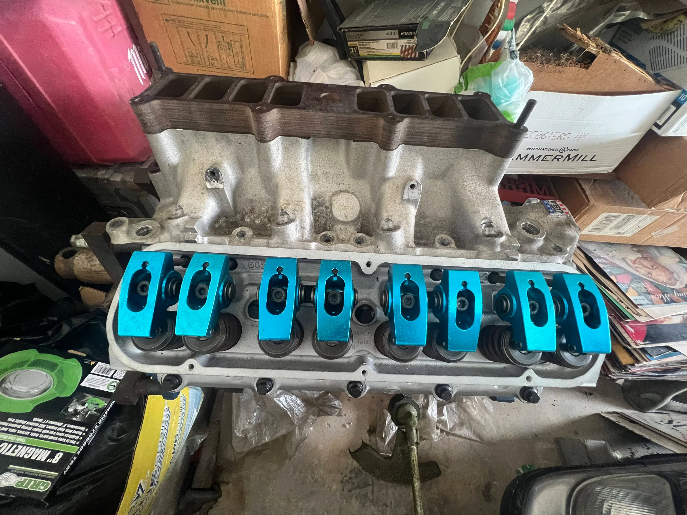

My goal is to build the motor with an eventual plan to add an entry-level Vortech supercharger. Here’s what I have so far:
**Weekend cruiser

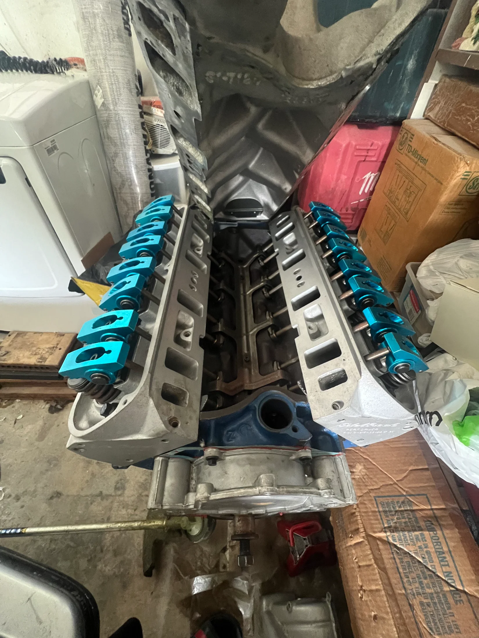

  • Block: Used Ford 302 block
    • Sent to the machine shop years ago for cleaning and boring
    • Now a 306 (bored over)
    • Fully assembled and torqued but it’s been sitting in the garage untouched for the past 7+ years
Parts Installed (As best as I can remember)
  • Cam: Mild E303 cam (by COMP)

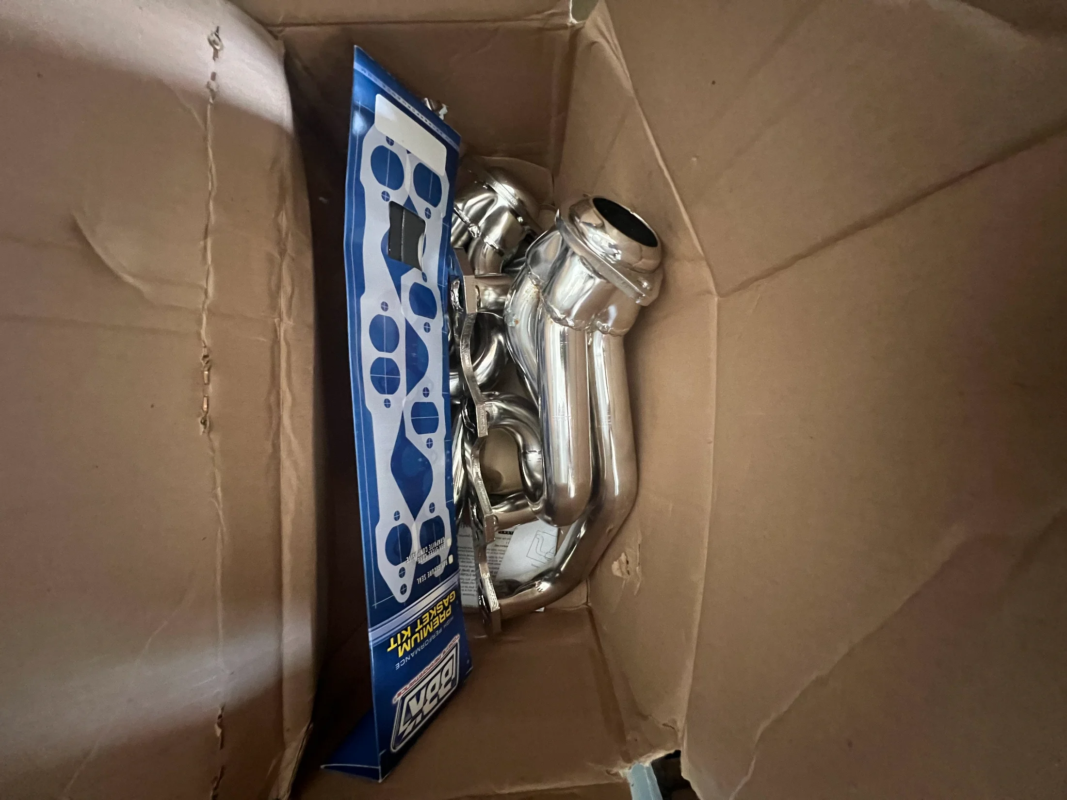

  • Headers: BBK equal-length shorty headers

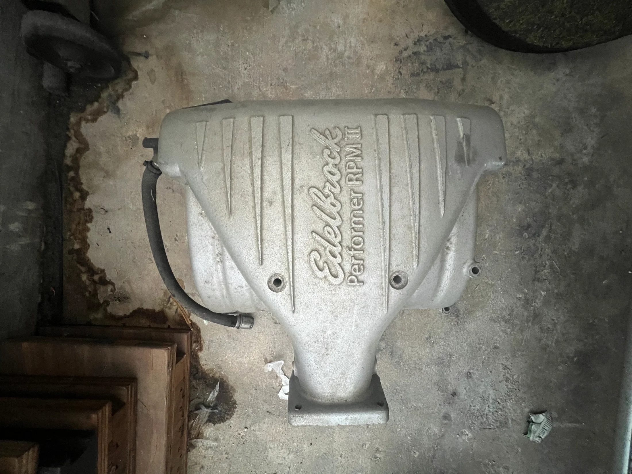

  • Intake manifold: Edelbrock Performer RPM II upper and lower

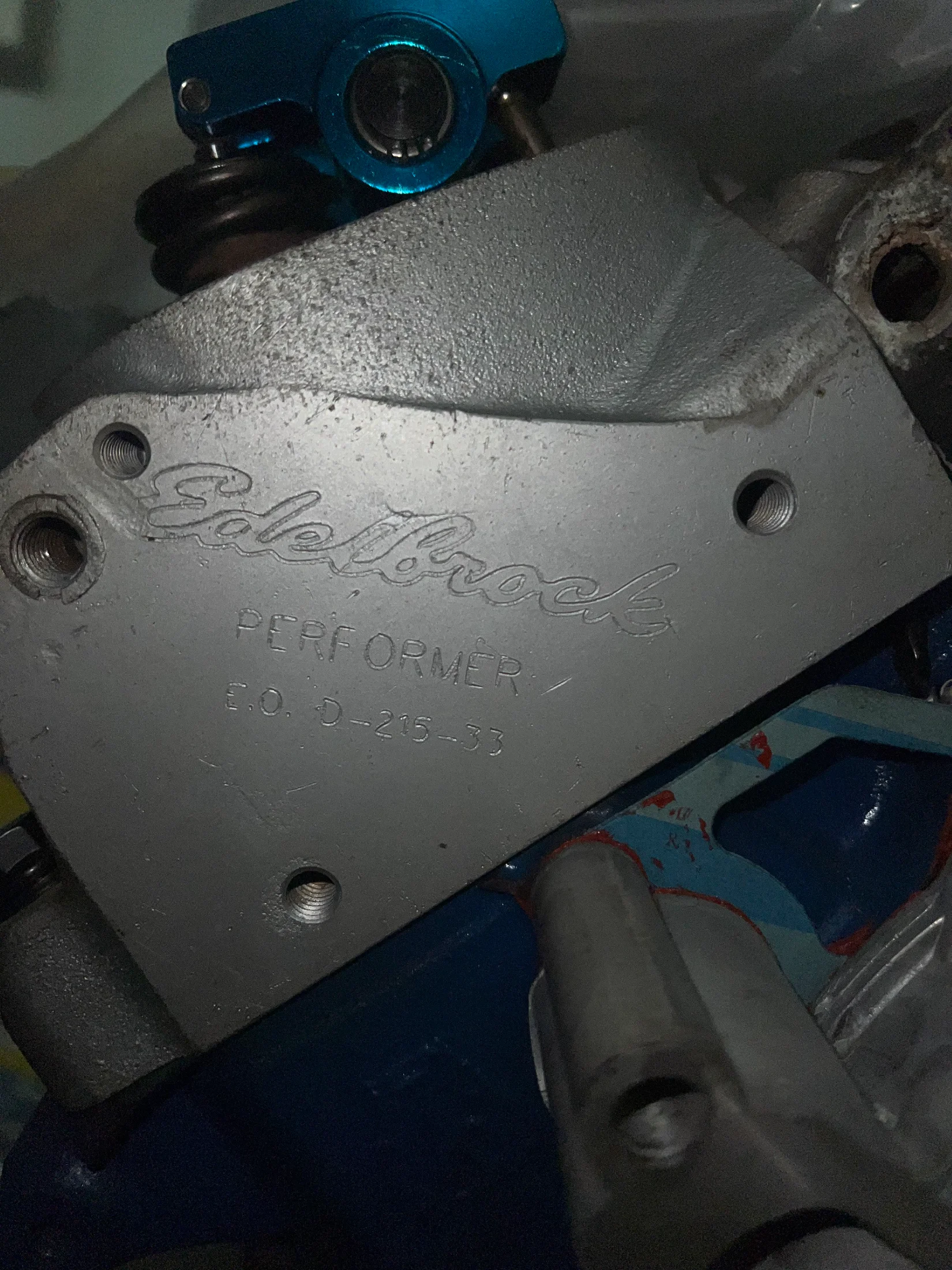

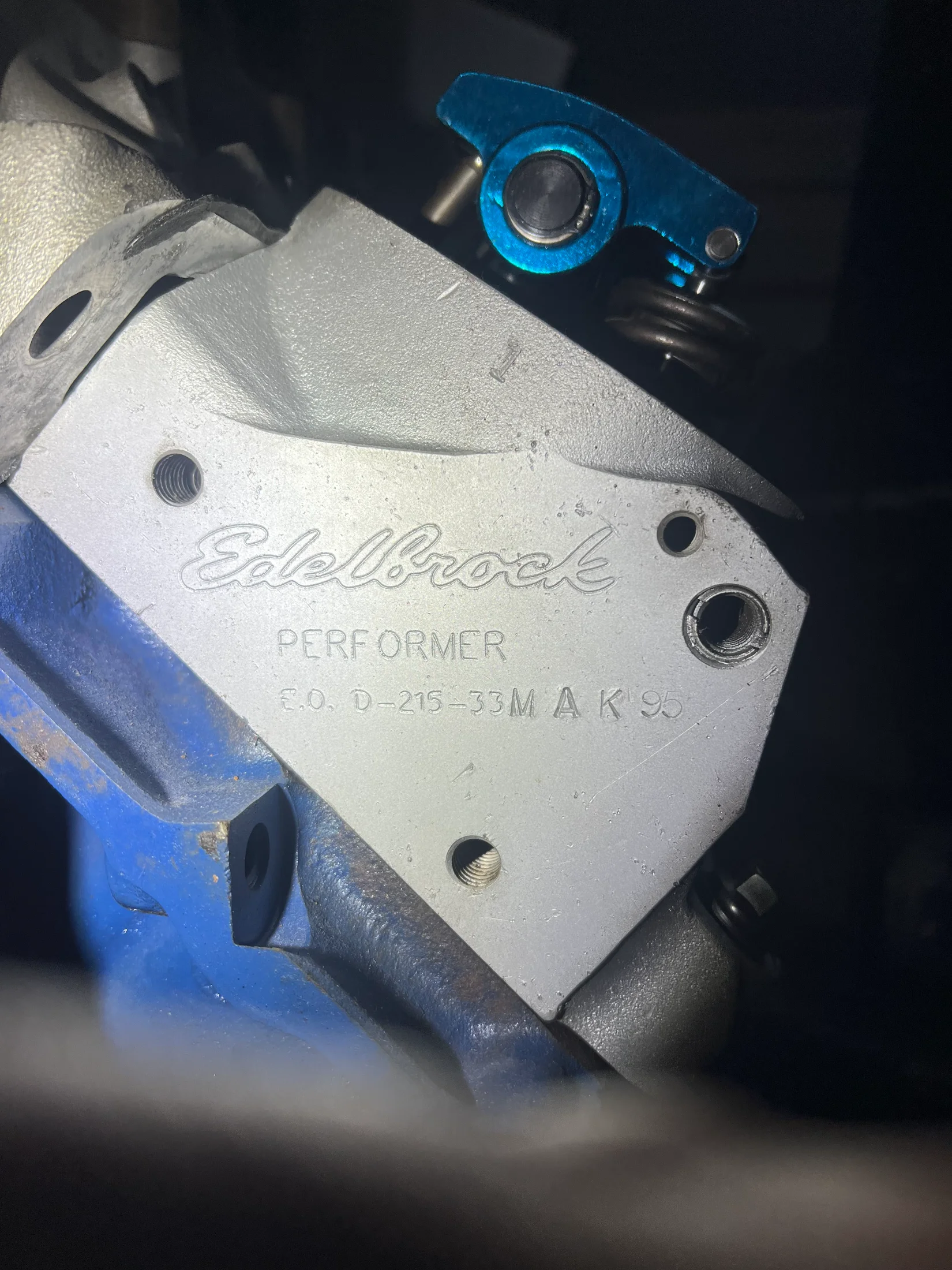

  • Heads: Edelbrock Performer heads (Part #: 6025, CARB #: D-215-33 MAK 95)
  • Pistons: Flat top pistons (brand/specs unknown)
  • Rockers: Blue roller rockers (brand/specs unknown - The heads of the bolts are stamped with TUZ, 12.9, but I can't find them online)
  • 255 LPH Fuel Pump (Jegs)

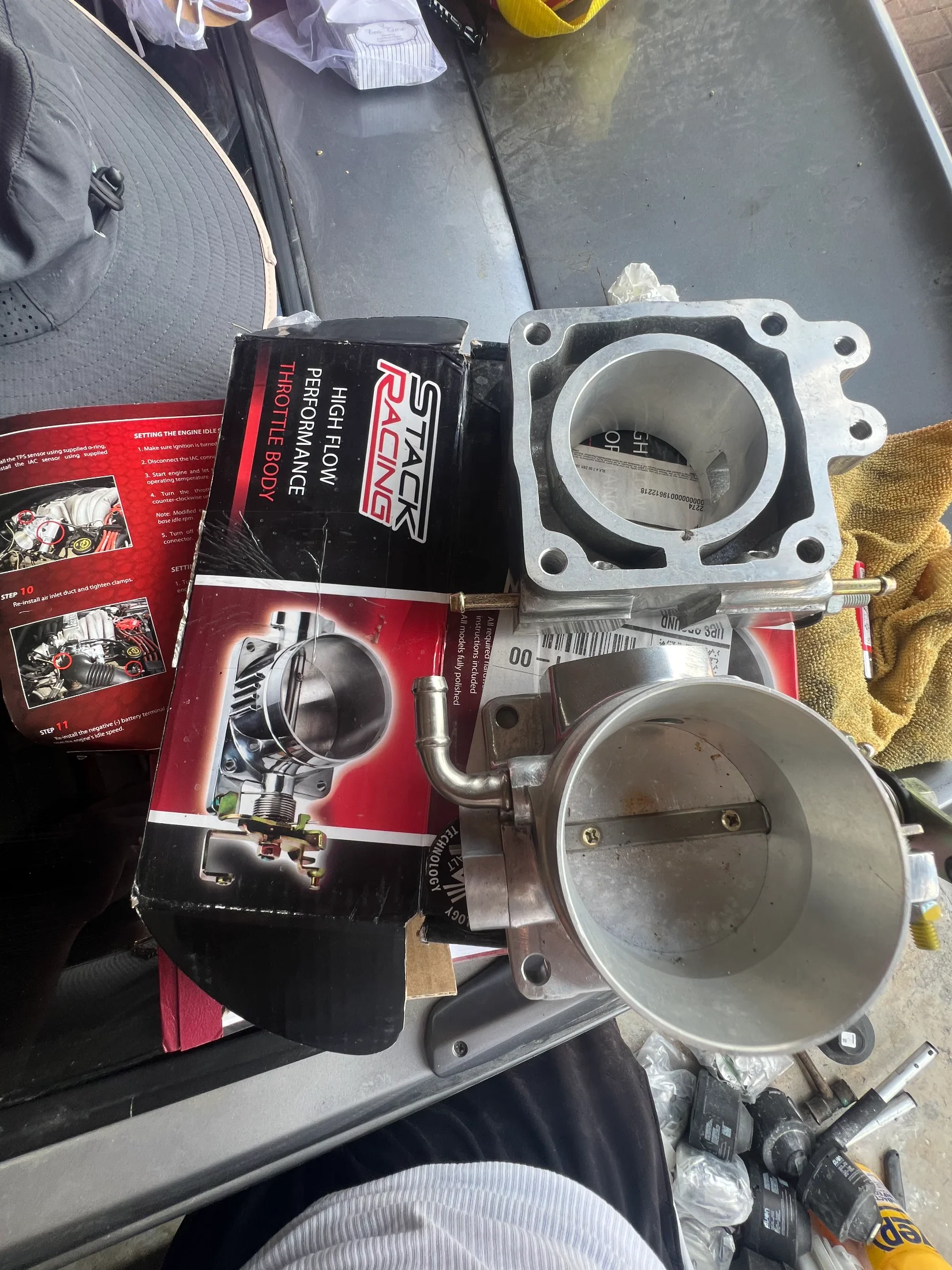

  • Throttle Body w/ spacer 80mm (Stack Racing)
Suspension
I changed the shocks and struts years ago, but I cant recall the brand. Nothing to brag about. if anything i would love to get adjustables or go sliglhy lower. This can be done later down the road.
Gears
Rebuilt stock T5 tranny with stock gears. ( I would love to throw in 3.55 gears later down the road.)
Stock Clutch system - This will be swapped for a hydraulic clutch system. I hate the fact that the stock clutch feels like a workout for my left leg lol.

Appreciate it Gkomo
On the first crank, the fuel pump didn’t engage. Based on our past experience, we already suspected the pump had seized, and sure enough, when we dropped the tank and exposed the pump, it was completely rusted out. womp womp lol
I ended up ordering a full fuel tank kit along with a 255lph fuel pump. It took us a day to install everything, but once it was in, the car fired right up on the first spin. I took her for a quick drive around the block and then parked her back in the garage. It was definitely a nostalgic moment.

That said, I do have a few concerns, and again, I'm open to all feedback.
  1. The motor was assembled by a mechanic about 7 years ago, and it’s been sitting ever since. I’m wondering if I should have someone go through it possibly even rebuild it before the motor swap take place.
  2. I’m unsure what size fuel injectors or fuel rail setup I should be considering as I build toward that low-boost setup. I already have the 255lph fuel pump installed + I know i'll need a fuel reglator if i want that perfect tune.
  3. I’m also debating whether I should keep the original Speed Density system or upgrade to a Mass Air Flow (MAF) setup. I’ve heard mixed opinions, so I’m not sure what direction to go there yet.
  4. Would a stock T5 tranny be able to handle this kind of HP / TQ in mind (400-500 HP)?
Personally, I'd dump the stock ECU completely and go aftermarket. Especially if you're going to boost it eventually. I currently have a 306 on a Megasquirt ecu with the HO Vortech V3 that makes 10psi. 47lb injectors, 255lph Walbro pump and Kirban regulator. Stock rails and fuel lines. Never been dynoed, but probably low 400's to the tires. I also have a TKX transmission, but ran a T5 behind it for quite a while with no problems. I do race mine occasionally, so I did go for a heavier duty transmission. It's been a solid setup for the last seven years or so. Tons of street miles and lots of 1/8th mile passes on sticky tires.
First thoughts off the top of my head:
1) 3.55 gears are a great choice. I have 3.73's and wish I would have gone 3.55's.
2) Full length subframe connectors are a must. Maximum motorsports, Kenny Brown, or Global West and all with the optional seat brace.
3) Lowering springs, lots of choices out there but the only ones I have any experience with are the H&R Super Sports and they were awesome.
4) The stock T5 will live at those levels but no sticky tires and get a good shifter like an MGW or the like with positive stops.
5) If you do not possess the ability to tear a motor down and inspect main and rod bearings then that is a hard stop and take the motor to someone that can do a tear down and inspect all of that and then put it back together. Worst case is you are out the cost of his/her time, gaskets, and some assembly lube. Should not be any reason to pull the heads or anything like that. May be able to look down the holes in the valley of the block and see the condition of the cam lobes and get an idea on the condition of that. Hopefully they cylinder walls are not rusted but if they are a quick hone should do the job.
6) Stock fuel rails will work just fine and you may want to get an adjustable fuel pressure regulator.
7) Injector size is up to you but if you want to get a Vortech and you are looking at 500 fwhp then you will want somewhere around 42 lb/hr injectors on gasoline. Google "injector size calculator" and run your setup on several of them.
8) The 255 lph pump will be just fine on gasoline.
9) I would make the change to mass air but that is just me as speed density will work as well. I think mass air on drivers and speed density on race cars but that's just me.
10) You may want to rethink the 80mm throttle body with the Edelbrock Performer RPM II upper. The opening on the upper where the throttle body mounts is only 70mm. Can be opened up to 75mm with little issue but I think 80mm may pose some issues. Also, you just do not need 80mm (70mm NA or boosted will make 500+ fwhp) and the tip in may suffer do to how lazy the air will be coming into the intake. You do not have a "USA" lower it is an Edelbrock Performer RPM II. Look at the number above and to the right of the "Made in USA" logo and you will see 31-7120 which is the same part number on mine and the one in this eBay add:
11) The heads are Edelbrock 60379's. The 6025 casting was used on several heads. These are not killer heads or anything but waaaay better the the stock piles of :poo:. Flow data is as follows (got it from Edelbrock's website):
Cylinder Head Part # .100" .200" .300" .400" .500" .600"
#60379 62/56 126/101 179/133 220/152 238/163 243/169
I probably could come up with more but its not my build.

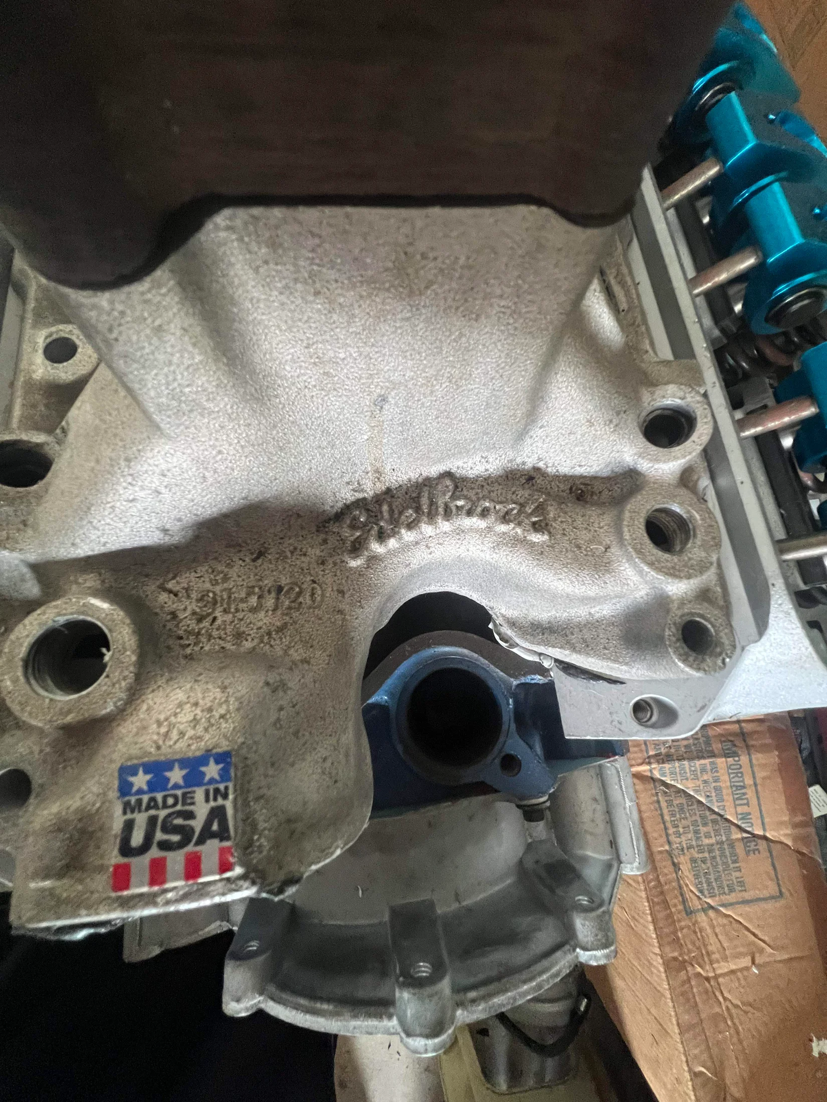

Thanks for the help and suggestions, really appreciate the detailed feedback.
Good point on the standing motor. I agree , it's definitely worth the time and money to tear it down now and do it right the first time rather than risk issues later.
The fuel pressure regulator is notedm ’m considering this one (Fuel regulator).
As for fuel injectors, I was leaning toward 40 to 50 lb/hr , sounds like that should be safe for tuning headroom, especially if I plan to boost later down the line?
I also went back out and re-measured my throttle body , turns out it's actually a 70mm, not an 80mm. So I’m glad you pointed that out.
And thank you for the clarification on the Edelbrock Performer RPM II manifold — I’ve updated my original post accordingly. I didn't realize the "Made in USA" cast marking wasn’t the actual model ID.
