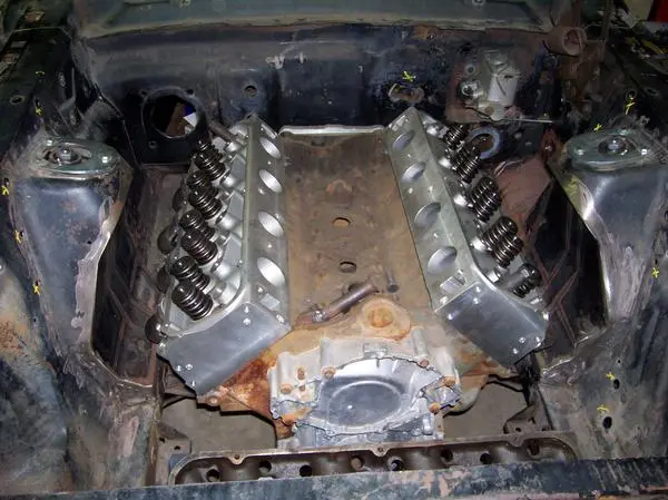

You'll have to either cut the shock towers back or do a Mustang II front suspension conversion to make it fit.
Option #3 - replace the shock towers with '67-'68 pieces. That'd give a "factory" appearance, and with a hot FE under the hood, it'd probably be wise to replace the radiator support with a '67 piece, too - a big-block radiator will definitely be needed.
That won't work. The 67-70 engine bay and chassis is wider than a 65-66. It's not just the towers that are different, the whole chassis is wider.

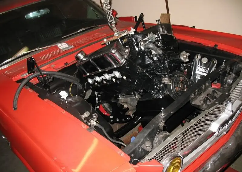

Hi, I'm from Australia and I thought I would reply to this topic, even though it isn't a 427 side oiler, my father is currently building a 66 GT Coupe with a 514 big block using the rrs kit. Here is a pic

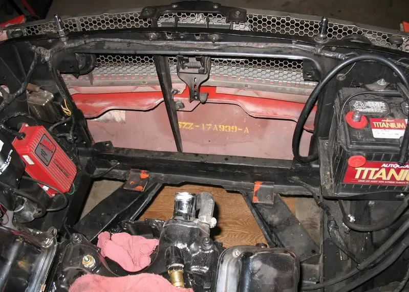

Although this isn't the whole engine bay, from personal experience I found that the 67-70 radiator support has the same exact widths between the front frame rails AND from apron top to apron top (where the fenders bolt) as the 65/66. Same overall height too.
I found this out when I grafted one to my 65' when I upgraded to the 24" wide radiator for my 393w. Mine was spec'ed as a 68' core support. Here is the final product:
This does make me curious about the general engine bay width of a 67/68 (not counting the shock towers.)
Note: The apron is not a bolt-in swap nor is it a direct replacement for the 65/66 due to other differences, such as battery placement, hood bumpers attachments, latch attachments, and some other cosmetic differences. I've purposely made mine look stock and had 2 afternoons involved from start to finish, including R & R' ing the front grill, valences, and bumper.
That the radiator support interchanges surprises me. I know the track width between these cars is different, the 67-70 being 2" wider. Just where the difference in width was accomplished, I always assumed was in the frame rails. I think I'll measure the width of this on my 77 Comet and see how it compares.
D.Hearne is right. The 67 is 2 inches wider. I guess it just means that Ford engineers cheaped out to use the same radiator support and found the 2 inches of width in the towers. (This doesn't supprise me about Ford.)
