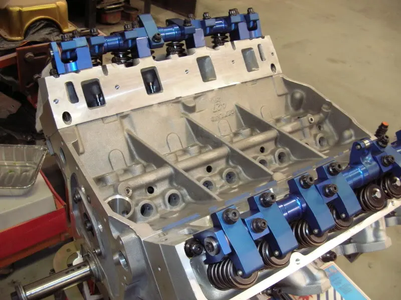

You said Genesis Sideoiler. Aluminum or iron? If aluminum, don't worry about the weight.
289 - 460 lbs
351 - 510 lbs
427 - 650 lbs
Aluminum block saves 82 lbs
Fe intakes are massive, an aluminum intake saves 55 lbs
Aluminum heads save 38 lbs
Total weight savings is 175 lbs
Engine weight is now 475 lbs

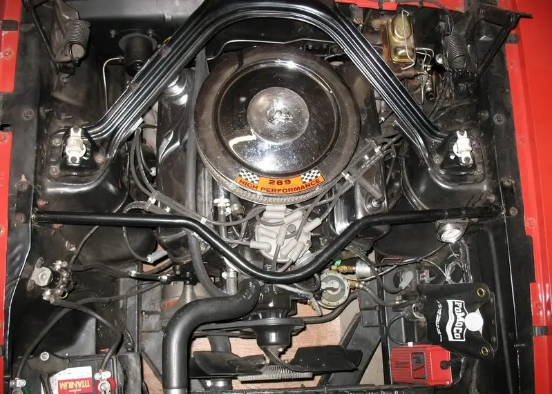

I measured the ID from the apron to apron, up high where the Monte Carlo bar is and got 40".
I also noted that the area where the battery is notched more and the top of the apron is about 42" wide there.
I also found an engine compartment pic of a 67' and it has a similiar notch out for the battery.
Another shot of the 67' engine compartment:
The area of the shock towers where the upper control arms are mounted are not as bulged as the 65/66. The towers almost appear to be vertical to the ground, whereas the early model has a definite V shape that protrudes more into the engine compartment.
Here is what I believe is a 70' (Cleveland motor) and it has the same general apron top appearance lines as the 65/66:

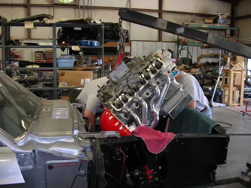

To set the record straight, engine bay is same width in 65-68, shock towers and LCA from 68 can be used in a 65 to allow BB to be installed with factory look.
First off, many of the earlier posts have referred to this "427" as a "big block". It is an "FE", NOT a "big block!" That being said, anyone here who has never experienced the thrill of a "WELL BUILT" 427 under their toe, simply knows not what they're missing.:nice: If all was aluminum except the block/crank it would likely be a similar in weight to a stock small block (351 would weigh more), maybe a tad less than a small block with it's cast iron intake. An all aluminum block, heads and intake would weigh much less and one of the most important added options would be a roll of paper for your buds when you take them for an "ALL OUT" ride!:eek: Anything is doable it's simply a matter of skills and/or money. I you have someone else do the majority of the work it will cost several boatload$ of CA$H, on the other hand, if you are skilled at welding and fabrication the cost could be minimal, except, of course, the price of the engine.;) If you actually do it, please come see me to give me a ride. I could use a good, immediate bowel movement.:oops:
