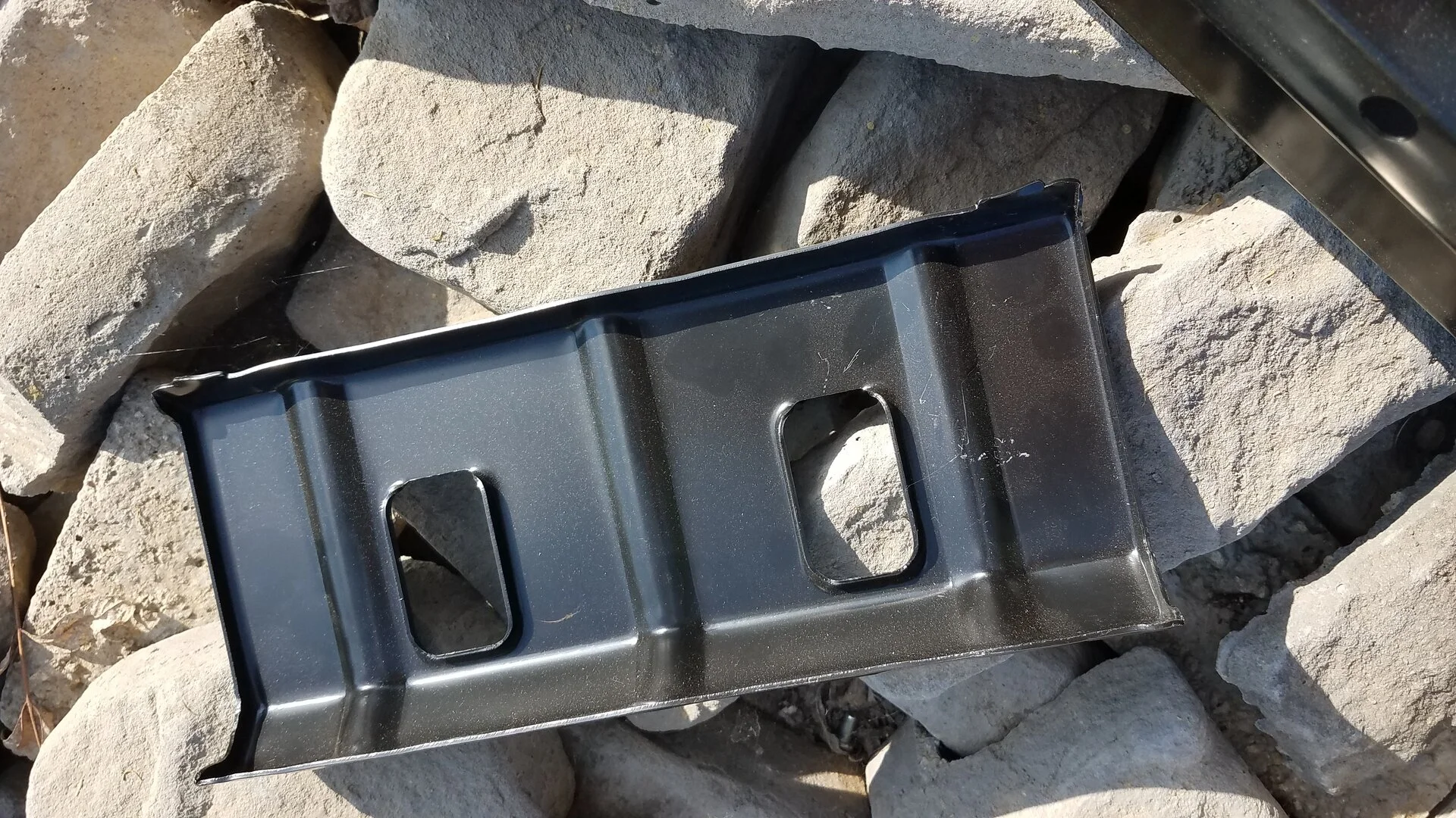

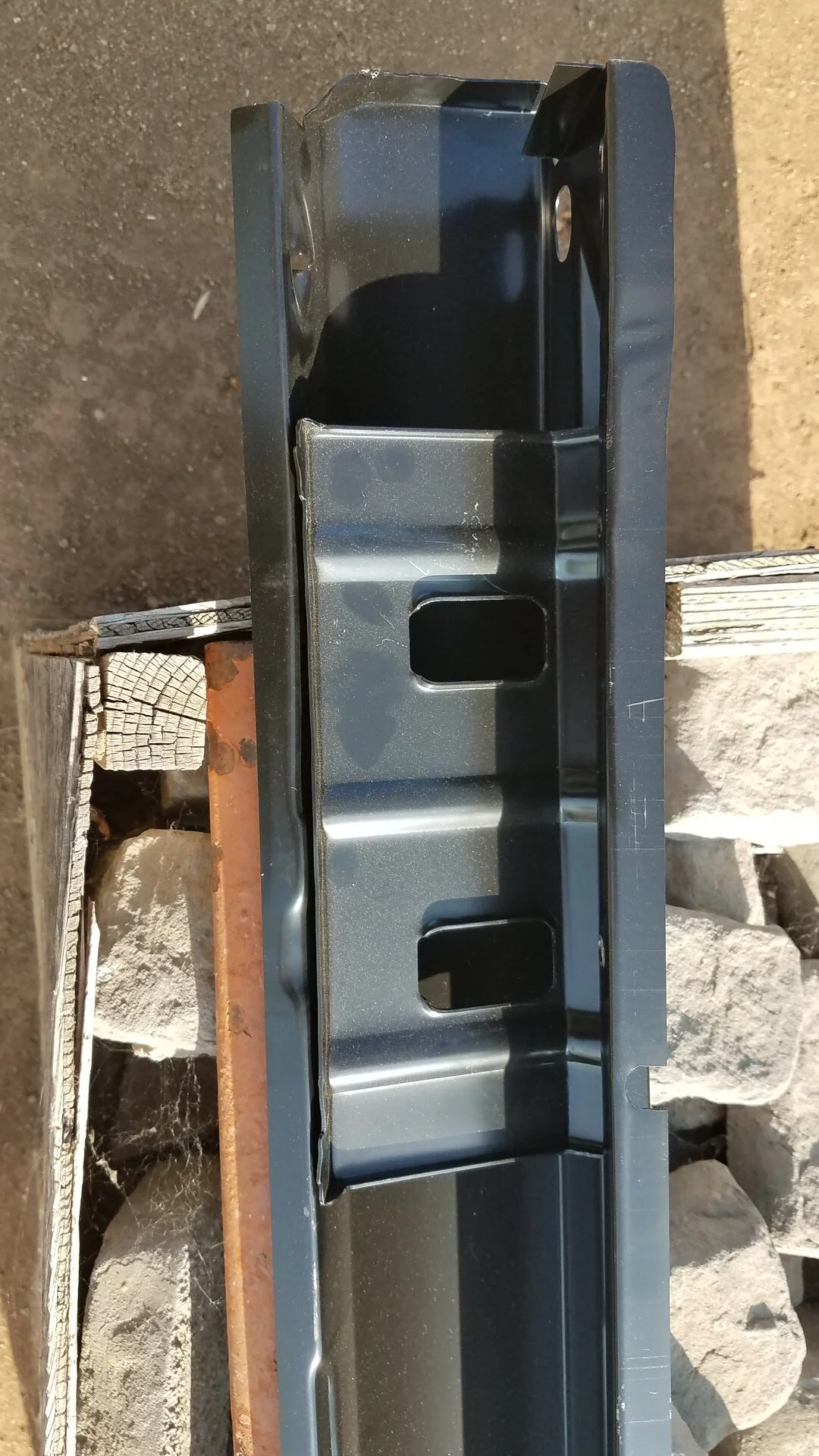

I always lift from the torque boxes but with wood between them and the jack to spread the load . The original lifting point is the pinch weld at the rear but i have seen the pinch weld bent from doing it in the incorrect locations
Jim, thank you for your comment. If I lift the car by the pinch welds designated by Ford I will make sure that I do it with a support that has a groove to protect that pinch weld, but my main concern is that I want to avoid flexing and twisting the car. permanently
The jack reinforcement plate inside the rocker isnt much in strength ,it probably 16 gauge ,the torque boxes are at least 12 or 14 gauge ,and with a wood block to spread the load it is actually the strongest area for a jack . I have seen torque boxes where someone has used a bottle jack with no block to spread the load and it makes a nice dent in the bottom

What year is your Mustang? The old ones will cave in just as easy as the new ones. I use a hockey puck or a rounded block of hardwood for my floor jack. The pinch welds will bend over if abused. The plates are an alternative. I try to jack from the subframe when I can

Its a 1965 FB. I will jack the car with 4X4's with a groove to protect the pinch welds that Ford has designated for lifting the cat. I have a QuickJack so the car will be lifted evenly on all four jacking points. I need the space to upgrade the steering. suspensions and brakes to discs
