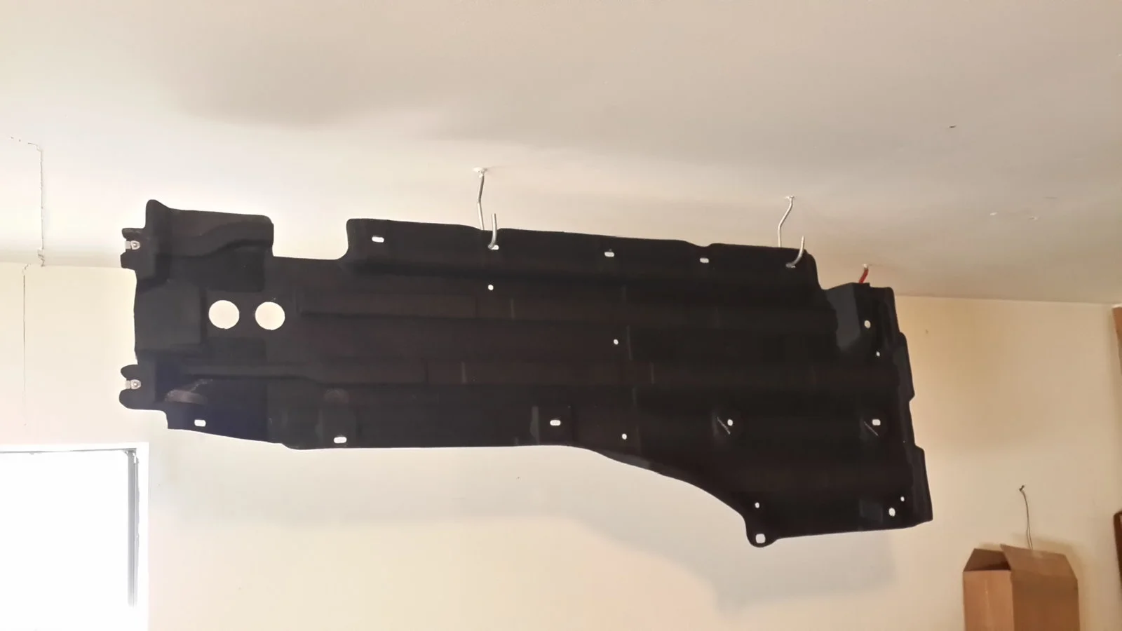

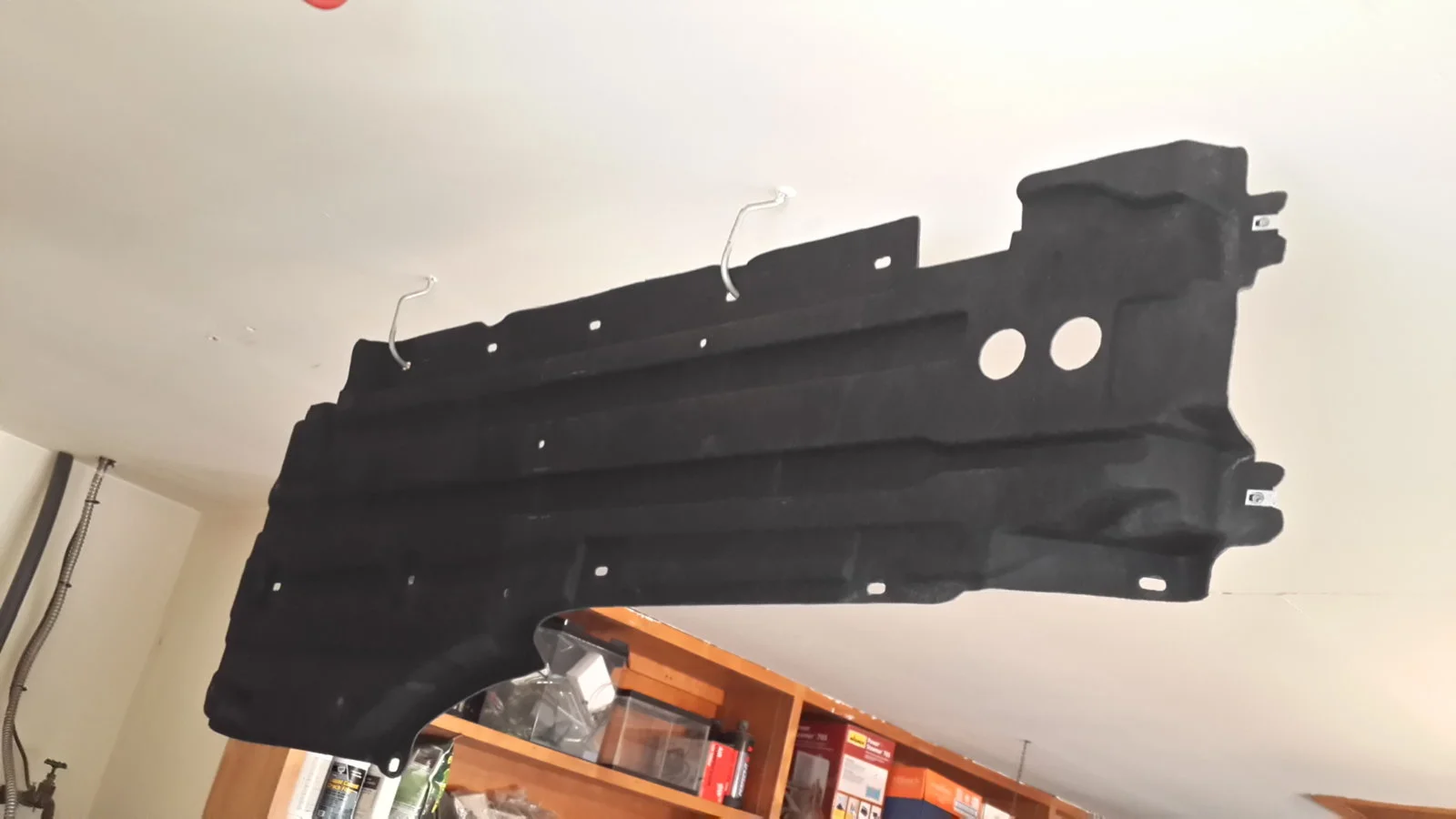

90sickfox: Thought I would have to pull the interior carpet to remove what I thought were screws holding the panel from inside the car. They were in fact welded studs on the bottom of the floor pan with "quick nuts" on them. I ended up removing the panel. According to people I queried about this panel it either serves as an "aero-panel" for drag/gas mileage purposes or it serves as an "sound insulator" (more likely) due to it being made out of felt instead of plastic. I managed to remove the panel and took pics of it hanging in my garage. My BMR Jacking rails are now installed.
What confuses me is....why did your Ecoboost not have one of these panels??? :shrug:

I don't know.... very good question. My car is a base model and brand new. I'm the first owner and no work has been done. I'm ordering the same jacking rails you have. How was the install ?
Install of the BMR jacking rails was easy after the felt panel was removed. I did have the car backed up on ramps and jackstands supporting the front of the car. It would have been very difficult to install the jacking rails without the car up in the air...
