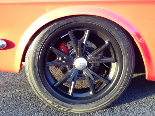

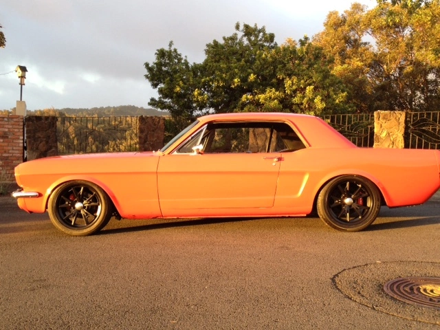

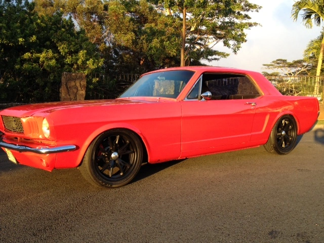

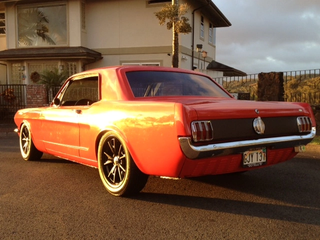

I lowered the car approximately 4" all the way-around: Stock Suspension with Koni's and Cut Coils up Front and De-arched Maier Racing Leafs and 2" lowering blocks in the Back.. Tire Size: 205/50 No Rubbing unless I hit a BIG bump while turing hard.... the suspension is very "stiff".
