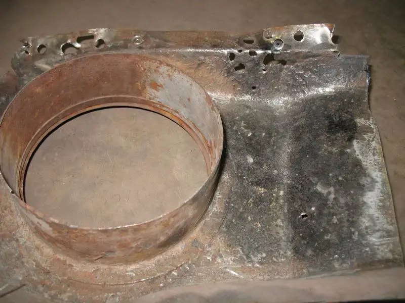

I too wondered about the condition of my cowl (65' Mustang.) I knew that sometimes the floor was wet on the driver's side, but assumed that it was the old cracked windshield gasket. Since the car was garaged 95% of the time, I wasn't too worried.
This was a car I bought in Louisiana over 3 decades ago and the outside body had rust only at the front of the doors. I had replaced the floor pans 7 or 8 years ago for rash that it had when I first got it. A generous coating of Rustoleum back then preserved it in the condition that it was for many, many years.
Finally after driving the car on and off for over 30 years it was time for a repaint. Since I do all the work myself, I decided that it would be wise to visit the cowl area as a preventative measure. Although the hats were fine (actually great), there were holes that I didn't expect at the front of the cowl:
Needless to say, I was glad that I did some exploratory surgery prior to the repaint. All told I will have a little over 50 hours in the repair (and this isn't the first car that I have done.) I may have also gotten carried away with the paint/body work, but having this car so long, it is like a family member to me.

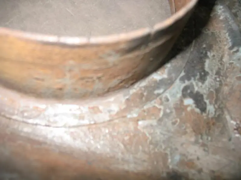

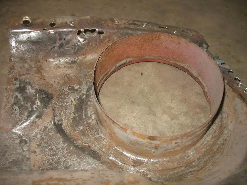

I too wondered about the condition of my cowl (65' Mustang.) I knew that sometimes the floor was wet on the driver's side, but assumed that it was the old cracked windshield gasket. Since the car was garaged 95% of the time, I wasn't to worried.
Finally after driving it on and off for over 30 years it was time for a repaint. Since I do all the work myself, I decided that it would be wise to visit the cowl area as a preventative measure. Although the hats were fine (actually great), there were holes that I didn't expect at the front of the cowl:
Needless to say, I was glad that I did some exploratory surgery prior to the repaint. All told I will have a little over 50 hours in the repair (and this isn't the first car that I have done.) I may have also gotten carried away with the paint/body work, but having this car so long, it is like a family member to me. You can see some of what was involved in my car here:
65' Mustang GT body restoration. - Ford Muscle Forums : Ford Muscle Cars Tech Forum
All I needed were the 2 patch panels and they came from CJ Pony Parts--they have free shipping which was a big plus. The patch panels were made in Canada, which are supposed to be the "better" ones to use.
I reused my upper cowl, but it too had some hidden rust under the factory seam sealer. I simply cut out the few holes and welded in fresh metal. The short connecting panels that join the cowl to the engine compartment aprons were also reused.
I bought a $4.95 spot weld cutting tool from Harbor Freight and it was great. I was able to complete the whole job with just the one. Cheap and highly recommended by me. There were 167 spot welds to break, plus I used the tool to create holes in the new metal when attaching it in place. It still has life left in it.
I could have bought the whole cowl, but was concerned that they are prewelded together. I wanted to be able to treat the inside area to my liking. Besides, for my 65, the price was several hundred $$'s cheaper for the patches, plus the repairs are hidden. The rest of the inner cowl was sound and did not require much work.
You have to be careful welding as the firewall insulation is flammable, as are the wires. I gutted the interior, except for the headliner.
