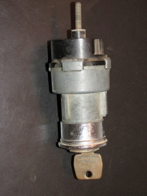

horse sence 15 Year Member Nov 29, 1999 12,345 8,231 233 Wile Coyote's stunt double Sep 9, 2014 #4 Sep 9, 2014 #4 You may be able to find a mobile lock smith that can do it where it sits
horse sence 15 Year Member Nov 29, 1999 12,345 8,231 233 Wile Coyote's stunt double Sep 9, 2014 #5 Sep 9, 2014 #5 It would be easiest to remove the key switch and take it to a lock smith. the outer ring spins off the front and the entire switch comes out the back of the dash .
R rustaddict Active Member Aug 23, 2014 218 55 38 Sep 10, 2014 #6 Sep 10, 2014 #6 I can handle that. I didn't figure it would be that easy.
horse sence 15 Year Member Nov 29, 1999 12,345 8,231 233 Wile Coyote's stunt double Sep 10, 2014 #7 Sep 10, 2014 #7 Very simple ,just remove the front ring ,and a 3/8 nut on the back that holds the plugin to the switch and pull it out .
