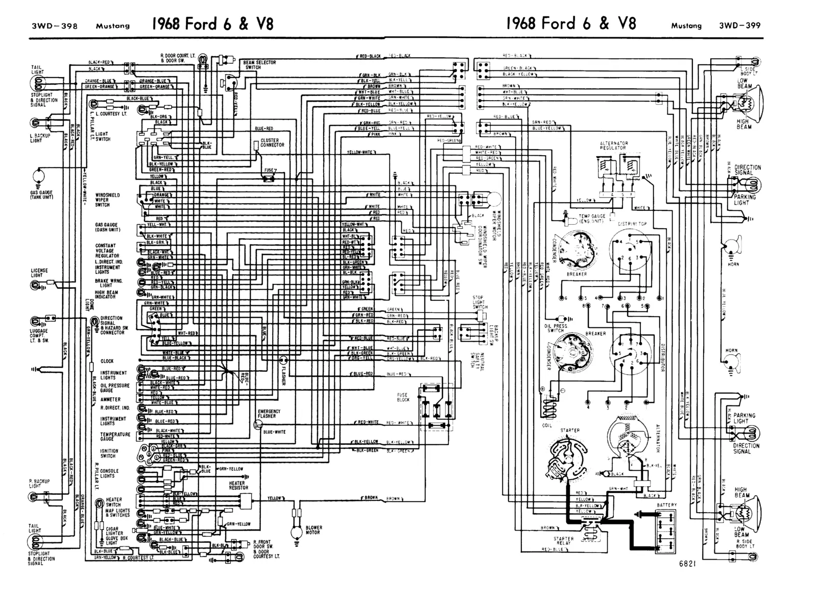

Wiring is simple in these cars. Here is the diagram. DO you have a test light? if You want a blow by blow, email me and I'll talk you threw the whole car if you'd like.

GROUND WIRES are a big deal with these cars. Make sure the engine is grounded to the body, frame, and alternator. Motor and trans mounts isolate them from the car...so we add heavy wires to make sure it is grounded. The alternator is motor mounted but the battery is body mounted, so make sure there is a good electrical connection between them. I usually add extra grounds on older cars because the gauges are usually grounded to the body. Body to motor grounds are often a problem with intermittent troubles.

I added two more body grounds. One to a bolt behind the grill. Another to behind the starter sylonoid. It has one to the starter, front of the engine. Back of the intake manifold to the firewall. I've cleaned all these grounds that I've mentioned a few times.
