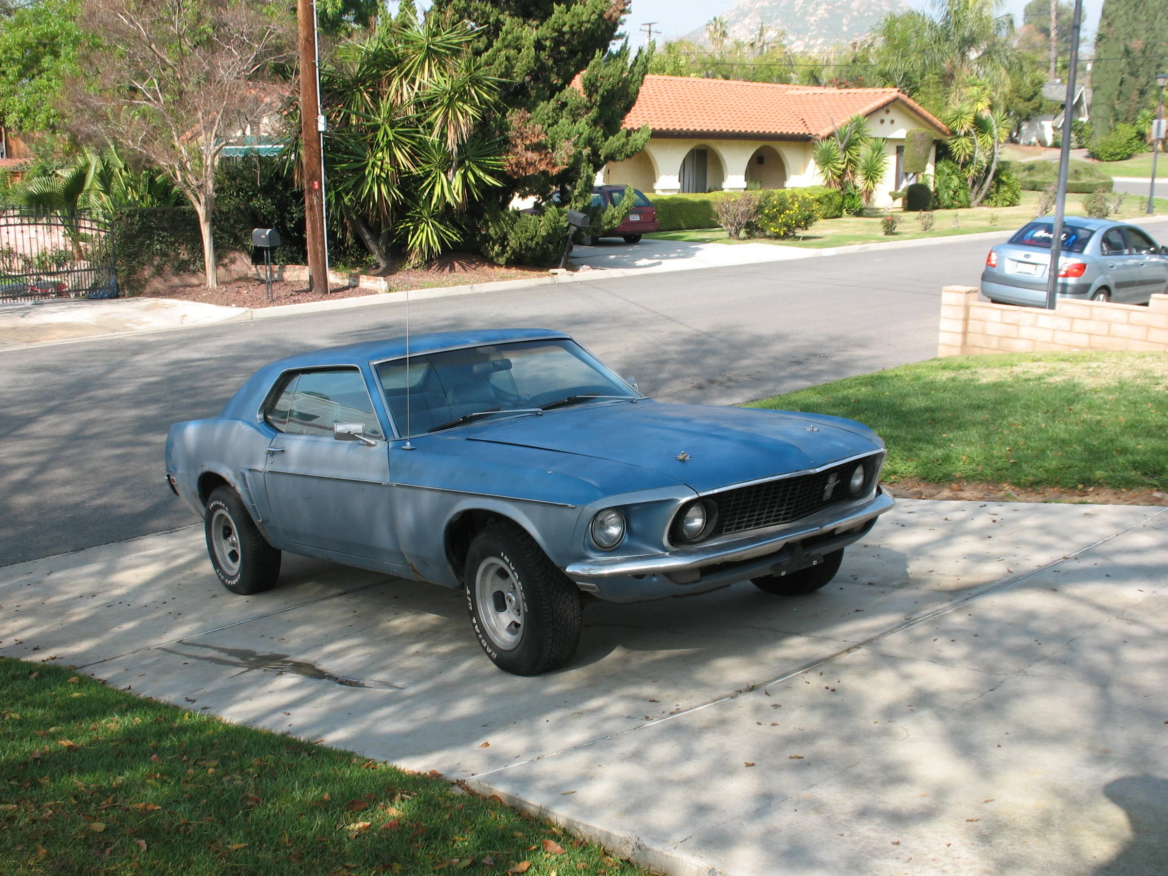

I have a 1969 Coupe, 302V8. I was gifted the car by my Brother-in-Law prior to his passing back in 2010. It fired up nicely, and had a new C-4 transmission installed and a new gas tank in 2009. Electrical working, New tires & Brakes. Front end seems to need some work. In all, a working machine. It has rust and the body needs work, paint, interior work, etc...
It has basically been garaged now for the past 8 years and was last started up about 4 years ago. Now I am prepared to spend some time with it. First thing obviously is to get it running again and I am prepared to do that, as that will get it back to where it was 8 years ago when I took possession.
My plan is to get it as mechanically sound as possible before I even think about the body, then the inside. A weekend driver and a nice classic musclecar is what I would like to end up with.
I'm just looking for advice on basically anything that would help me plan properly and move forward with this.
This was the 1st pic I took in 2010 and it's unchanged.

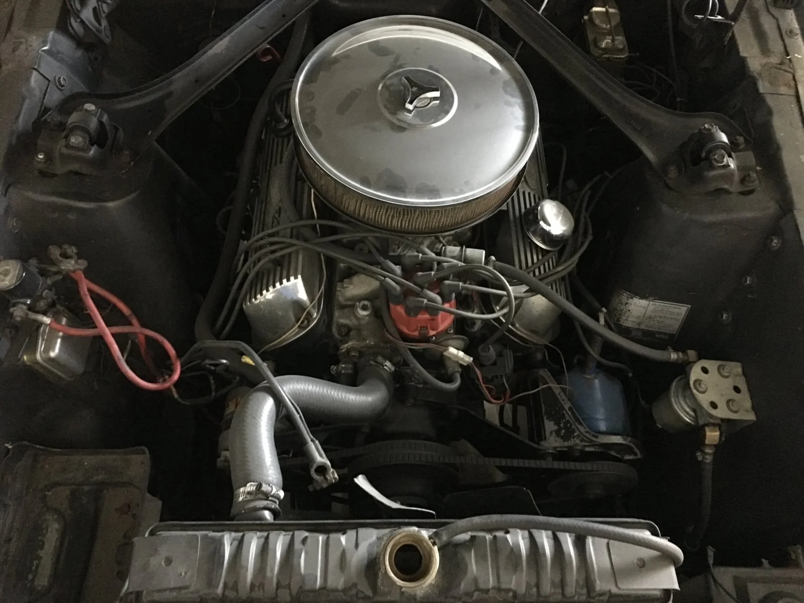

Next question - does anyone see anything odd or weird about my engine? Not sure exactly what I have here that was after market or added on.

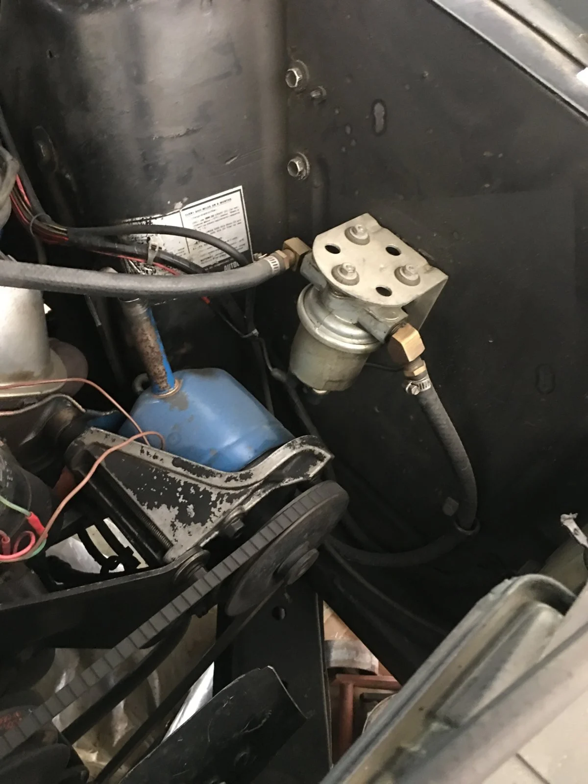

I keep answering my own questions - lol - I just changed out all the plugs as it was going to need it anyway. It fired up just fine - as long as I hand added some gas to the carb- but I'm not getting fuel just yet
- I assume this is the culprt? How can I service/troubleshoot it? Electrical is working fine - I can hear it humming when I turn the ignition on,

take the line off that goes to the carb and see if it pumps fuel, if it dose the issue is in the carb,(stuck float), if it doesn't pull the tank line and drop a line in a coffee can of gas and see if it pumps, if it does then you have a clog in the filter, the strainer in the tank, or maybe an issue with the pickup tube in the tank.
No fuel going to carburetor so I removed line from carb to pump, no fuel dripping from outlet of pump. Pulled line from inlet of pump, no fuel there either.
Can I safely blow air from the line to the tank to see if there is a blockage? Pump not making any noise now so I'm thinking bad pump for sure. Nice 20 gal tank is new (when I got it).
Sorry for all the questions - can I buy one of those Delphi Fuel Pumps from AutoZone and just replace the bad one - Looks like a simple 12v/ground hookup, fuel in/out connections and will fit on my mounting plate.

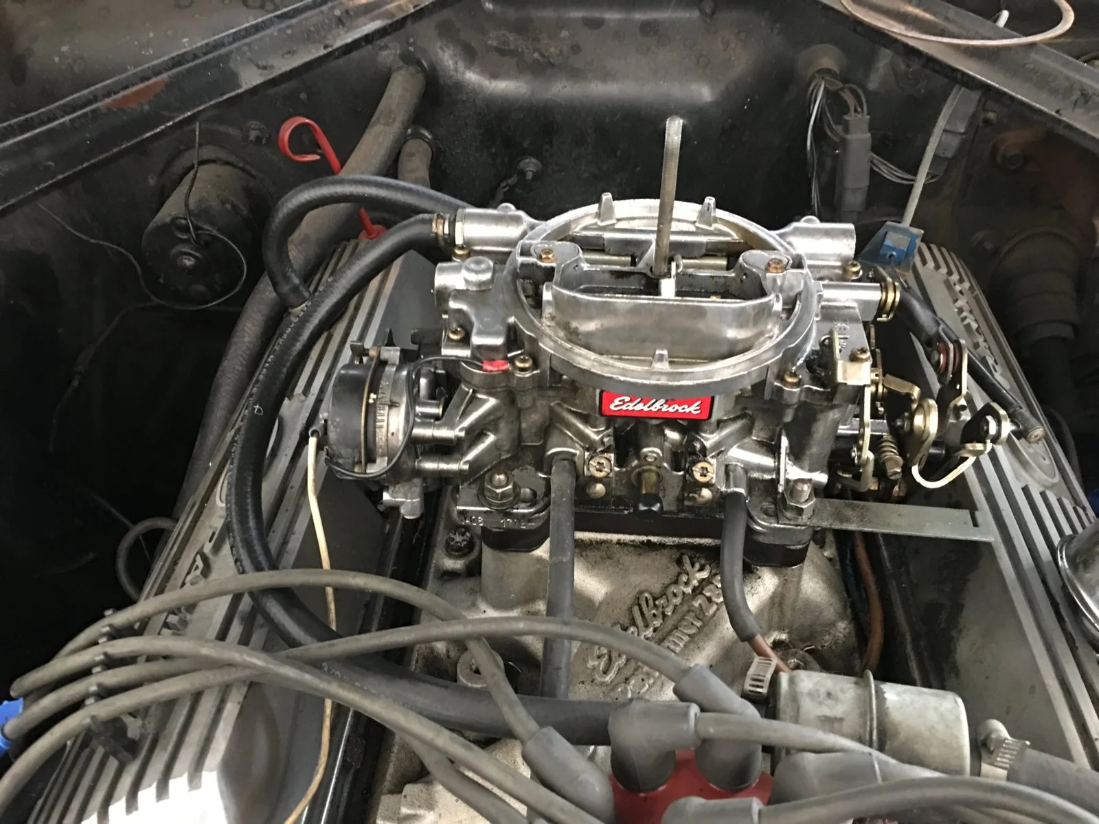

Making progress - installed a new Holley (RED) Fuel Pump and it's working perfectly and the gas is flowing - I double checked that! - so I got gas going to the intale of the Carb - but no luck running unless I prime it at the card and then it only fires until what little gas I poured in is expended.
Time for me to learn Edelbrock Carb troubleshooting. Any pointing to some basic info on this is surely appreciated.

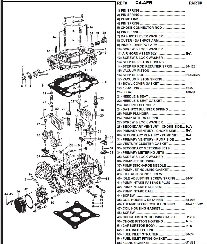

You can try tapping on the top oof the carb inline with where the fuel enters, right below that is the needle valve that allows fuel into the bowl. IF that doesn't work you'll have to gently remove the top of the carb so you don't hurt the gasket, and see if the needle valve is stuck. Here's a diagram of whats inside.

I cleaned out the whole carb and got it to fire up but only for about 10 seconds.
The Edelbrock 1604 suggests no more than 6.5 PSI (optimum is 5.5) but the Holley Red Fuel Pump is preset at 7 PSI. Would that cause a problem? It looks like the old Carter ran preset at 6 PSI. For $35 I'll add a regulator but not sure that even in the equation yet.
