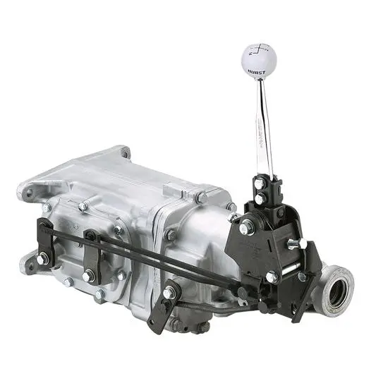

This is a common problem- The Hurst Super Shifter works extremely well, because the control rods are straight. However, this requires the shifter to be offset to the left, requiring cutting of the tunnel, and the straight rods require removal of the upper-left portion of the transmission crossmember.
This is a Muncie, but you get the idea:
Exactly! it also requires the end user to pound the transmission tunnel up where the super-shifter linkage would normally have pressed against the tunnel (I properly dollied it back to shape, then used all metal as seen in the pictures to smooth out the pitting). All repaired.
