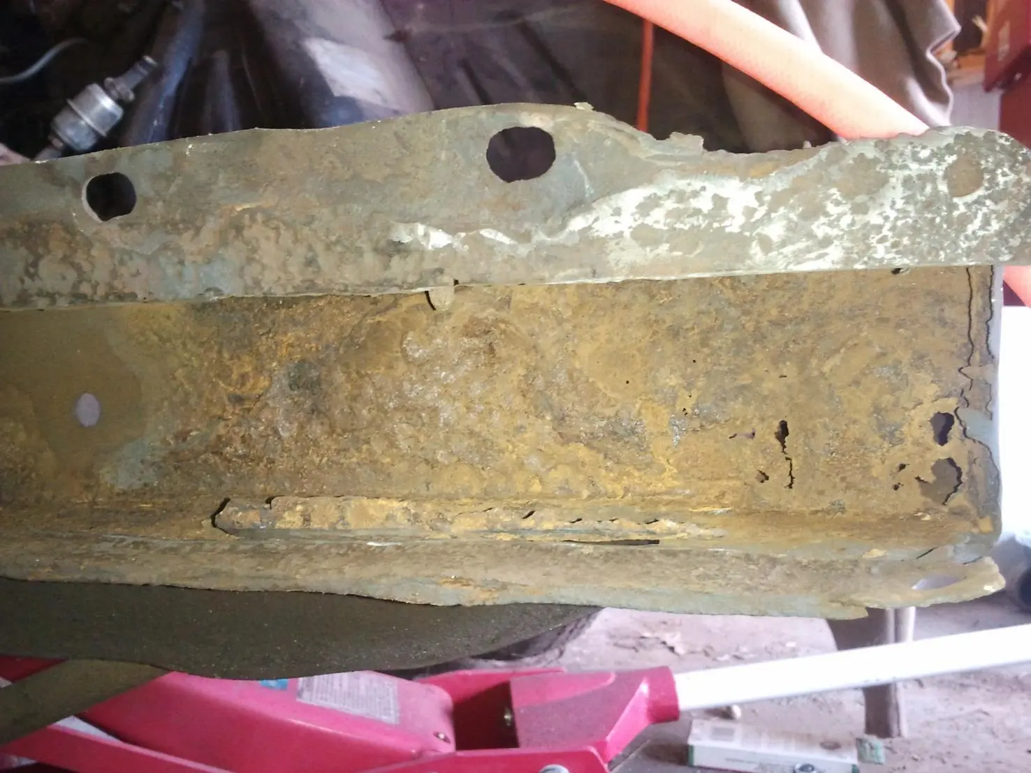

ok got a question about rust and frame rails... I have a little rust problem on my passenger front frame rail. I thought it was just on the outter were the bumper brackets mount when my welded nuts came off during disassembly... I purchased an outter frame rail patch to fix it and finally got around to doing this and found some rather disturbing stuff... (pictures below) i realized the bottom of the frame rail was also suffering from the cancer as well as the very front of the inside portion. my big problem is the amount of rust scales and flakes that came off along the inside of the rail behind my cut. I went back a decent bit from the visible rust on the outside but this is what i found... do i need to replace the whole thing or open it up further back the same way i did at the front and clean it out epoxy prime it? thanks for your help in advance!

Consider this, if you've lost 50% of the original metal thickness to rust, what percentage of strength do you think you've lost as well?

I think I would start with a frame fixture and build up from there...I had a 67 fastback that I sold in 1989 and the frames in front of the shock towers were so bad the bumper would not mount because the nuts were gone, upon further investigation I found rust nearly as bad as yours. Back then it was a death sentence for a car owned by 19 year old with no garage, but now I think I could fix it....with a jig (and the internet).
thanks for the help guys. I wish there was a way to determine how much rust is on the inside of the frame rail since the outside doesnt look bad but it is pretty eaten up on the inside on this one. i have a little rust on the floor pans that needs to be addressed as well as a few small patches on the doors and quarters and b post area... guess i need to get to stripping and cutting out and burning in the new...

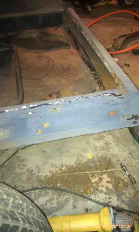

well i finished teardown and found the whole floors need replacing along with that right frame rail... so i ordered and everything has arrived!! soon i will tear into it and get to cutting and replacing... any suggestions for bracing for all this removal and ideas for the best way to get that frame rail out and new one in? thanks for any help yall can give! i will be puttin some pictures up in the next couple days
