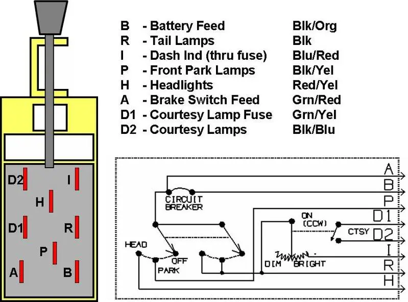

Not sure how close the 1970 switch is to a 1966 switch...but:
you will use some variation of this...the "I" terminal is power for the instrument cluster...do a continuity test between that terminal at the harness connector on the switch side and corresponding wire at the connector on the cluster side. This will tell you if there is a break anywhere in the wiring. If there is continuity, then the problem must lie somewhere in the cluster itself.
