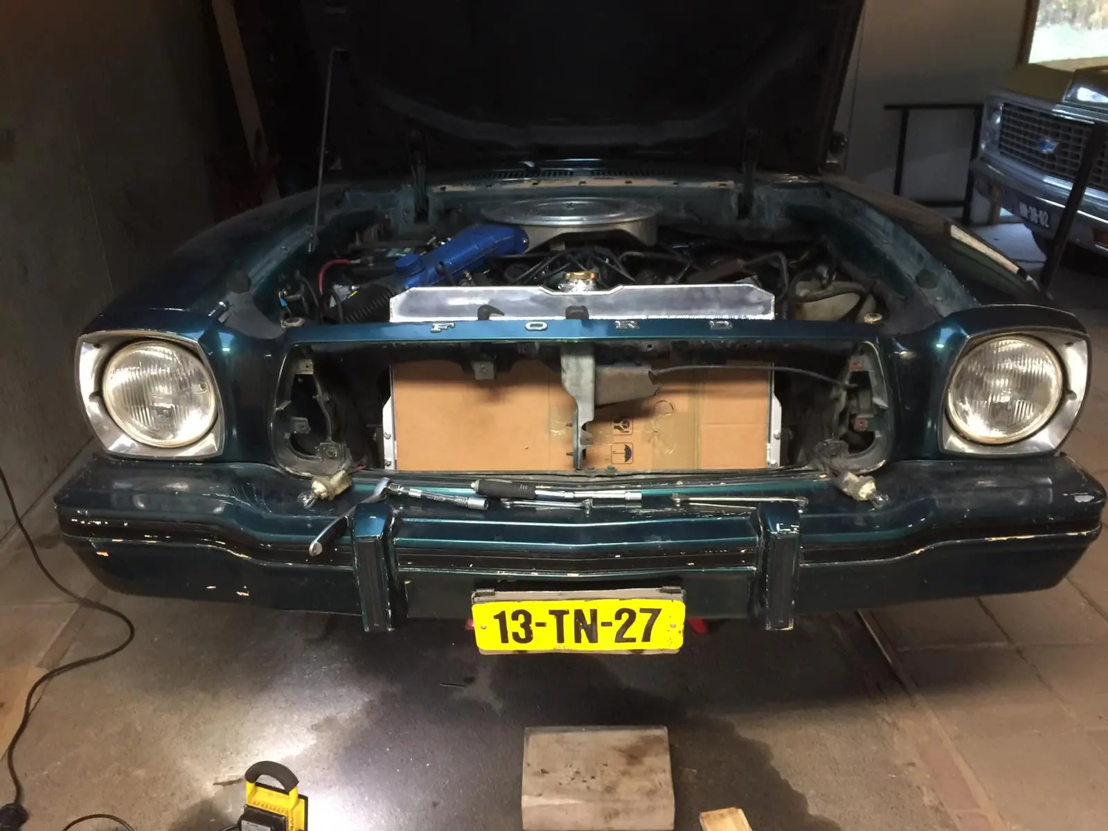

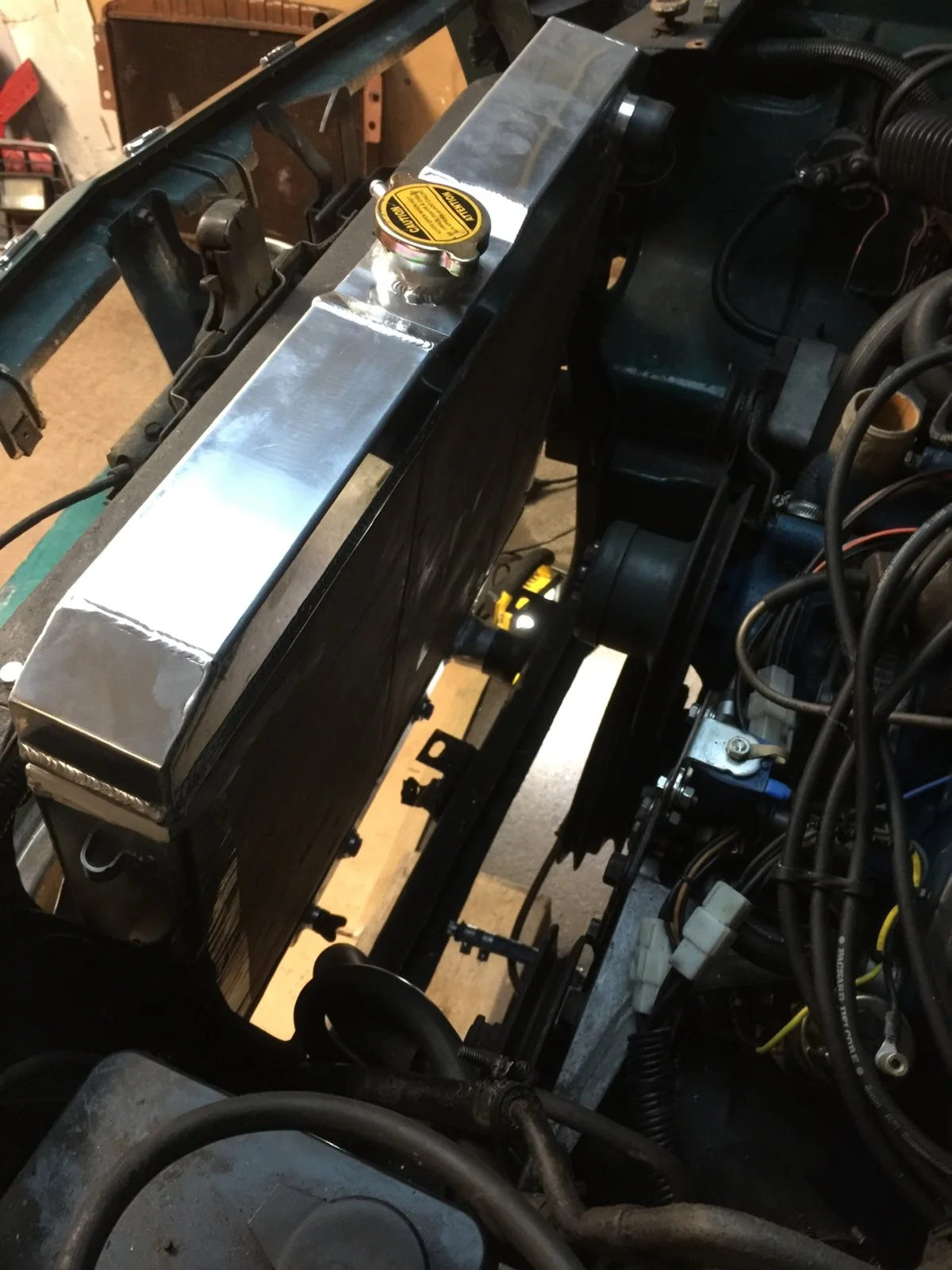

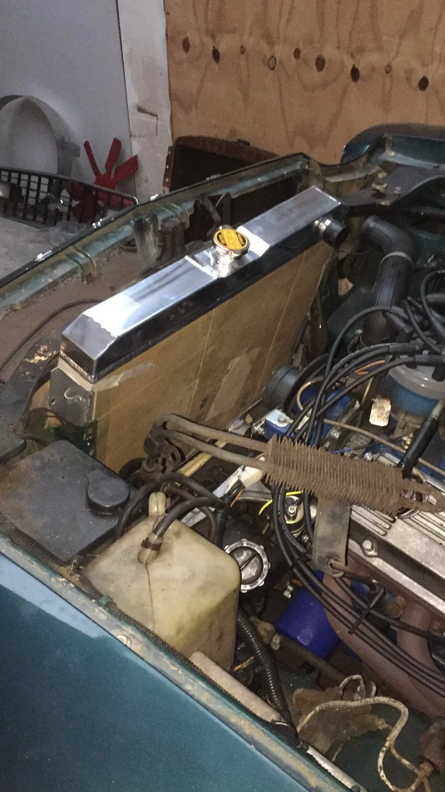

We have bought an universal radiator.

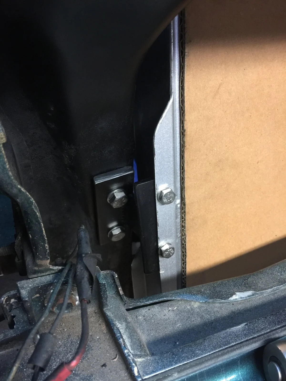

It was slightly bigger than the stock one, we had to trim the body a bit where the radiator mounts and a bit if the radiator flances aswell.
Also did we to make new mounts and a new different Lower hose.
It is an aluminium 3-row radiator with an intern transmission cooler.
