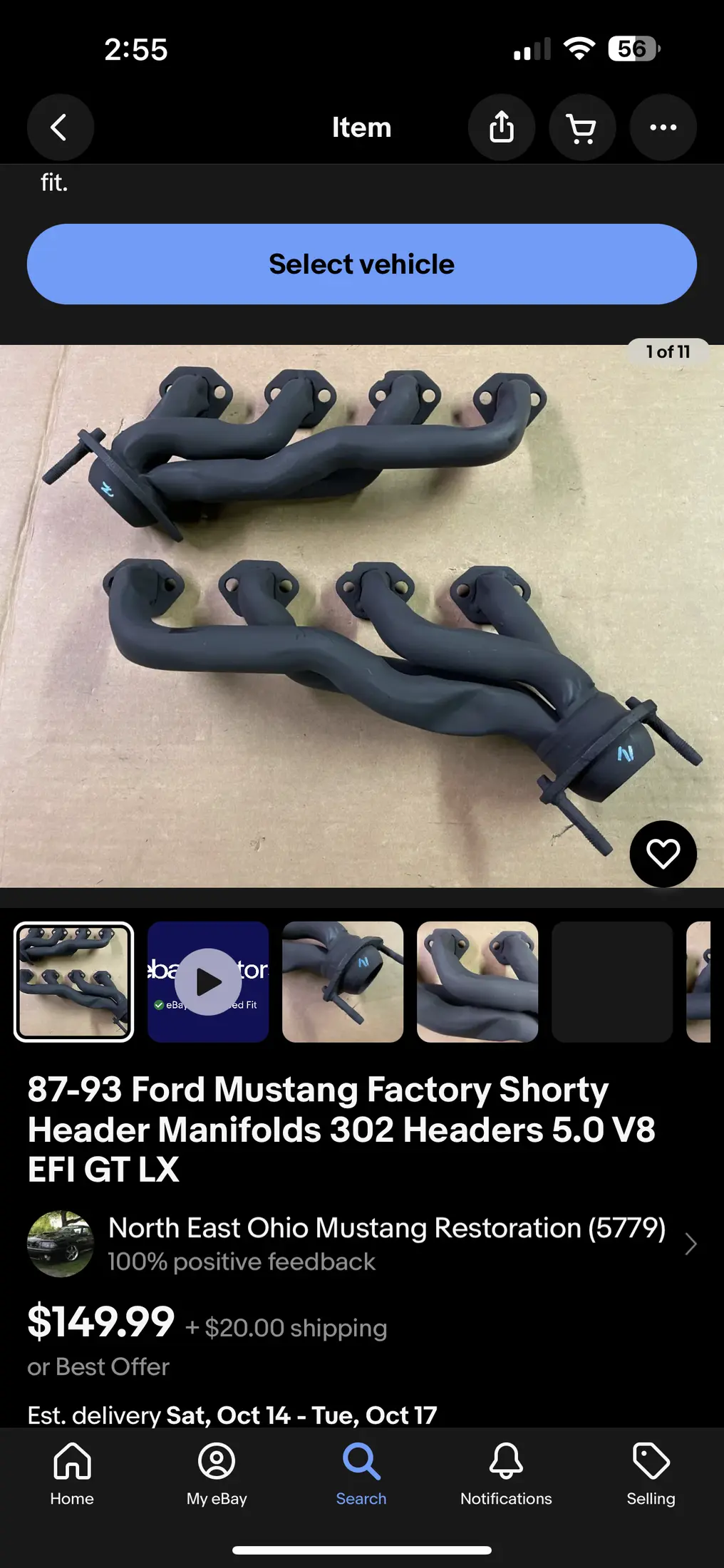

Looking at putting a set of original Ford exhaust manifolds on my 1986 GT convertible. Searching around for used sets, there seems to be several different part numbers. Did the convertible use the same part numbers as the hardtops?

As far as I know, there is no major difference in 86-93 headers. Any variation in engine mount angle is accounted for in the ball-and-socket type connections.
There might be some minor revisions, such as exhaust stud clearance, or surface finish and such, but for the most part all 86-93 headers are lumped together in the same group.
After 1991, all of the V8 Mustangs used the convertible mounts. The old ones were discontinued. I swapped from the old style to the vert mount and it made zero difference in how the exhaust mounted up.
That's correct.
There were basically 3 versions of Ford's "headers" used on FoxBody Mustangs:
- the '85 set, which had the stove pipe shrouds and the funky heat riser valve in the driver's side collector. It was also the only set with a 2-1/2" outlet.
- the '86 set, which which eliminated the shrouds and riser valve. They also changed to a 2-1/4" outlet at that point.
- the '87-'93 set, which incorporated "minor tube reshaping to simplify their interchangeability with the 5-liter-powered Lincoln Mark VII".
Source - The Official Ford Mustang 5.0 Technical Reference & Performance Handbook

If he wants to replace the ones he has with stock ones because the current set is rusted and looks like hell, aren't originals going to look exactly the same?
Not necessarily.... his current set of aftermarket headers are, most likely, made from cold rolled steel, which can certainly turn into a rust magnet (no pun intended). Since they were "cheapies" (his word), I'd assume they were not hi-tech (ceramic or better) coated.... probably just had a coat of high temp paint, which doesn't last.
A factory Ford set, being made of stainless steel, has a much higher chance of being in better shape. They would probably clean up pretty good with a Evapo-Rust bath too.
Honestly, i don't think i've ever seen a set of stock headers that looked good. My guess is you can clean them, but it will happen all over again anyway. Not sure i'd pay to have factory headers coated either. Personally i'd buy a set of 304 stainless headers to replace them, but that's me.

Blast them, high temp paint and call it a day. Eventually they will look like the backside of your ass but you’ll have some time.
