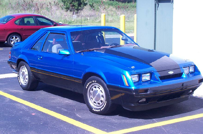

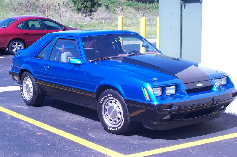

How could you NOT love this?

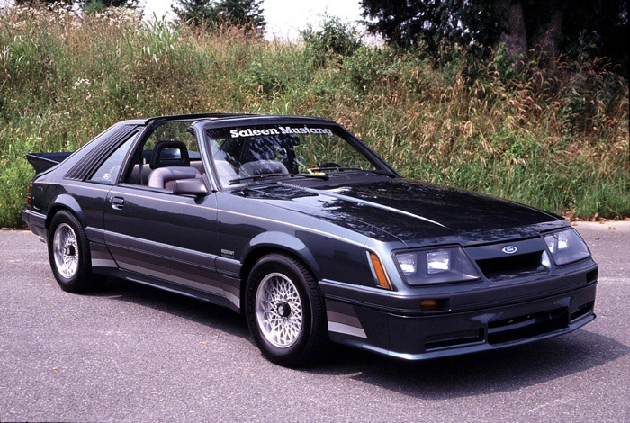

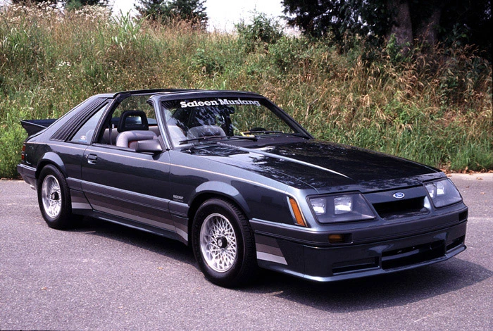

Heres my pacecar:
:bang: :bang: :bang: :bang: :nono:
