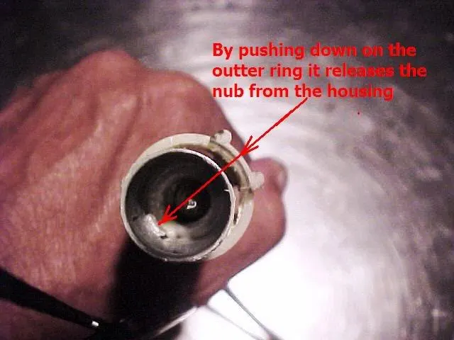

5.) The speedo cable is secured in the speedo head by a white plastic clip. Depress the clip or squeeze it and pull the cable out of the speedo head. This can be tricky, but it will come out if you have the white clip depressed enough.

Thanks for the info. I can’t seem to pull the cable out of the back of the speedometer? tried and tried the cable itself looks fine no kinks, going through the engine compartment haven’t been able to get underneath to check the transmission driven gear yet. but short of seeing kinks or damage do you think i need to pull this out of the speedometer?
