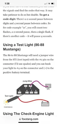

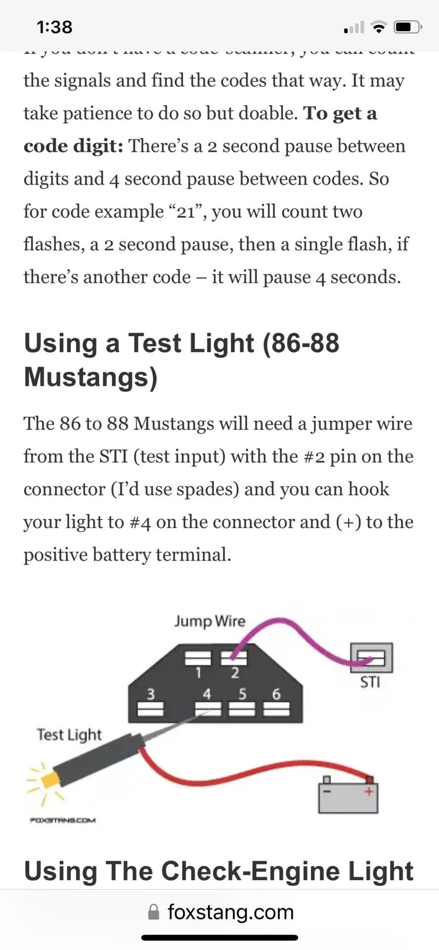

I’m using a multimeter with this wiring diagram

That method works fine, but interpreting the sweeps can be a little confusing. That’s why I usually recommend the innova 3145 reader as it gives you hard numbers.

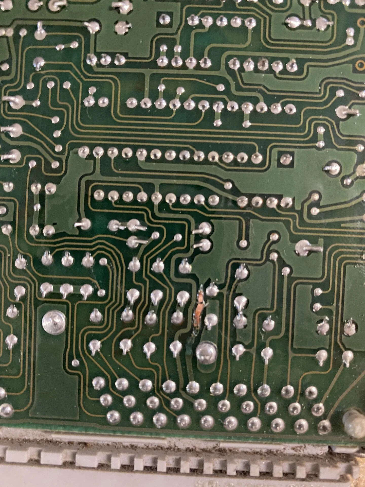

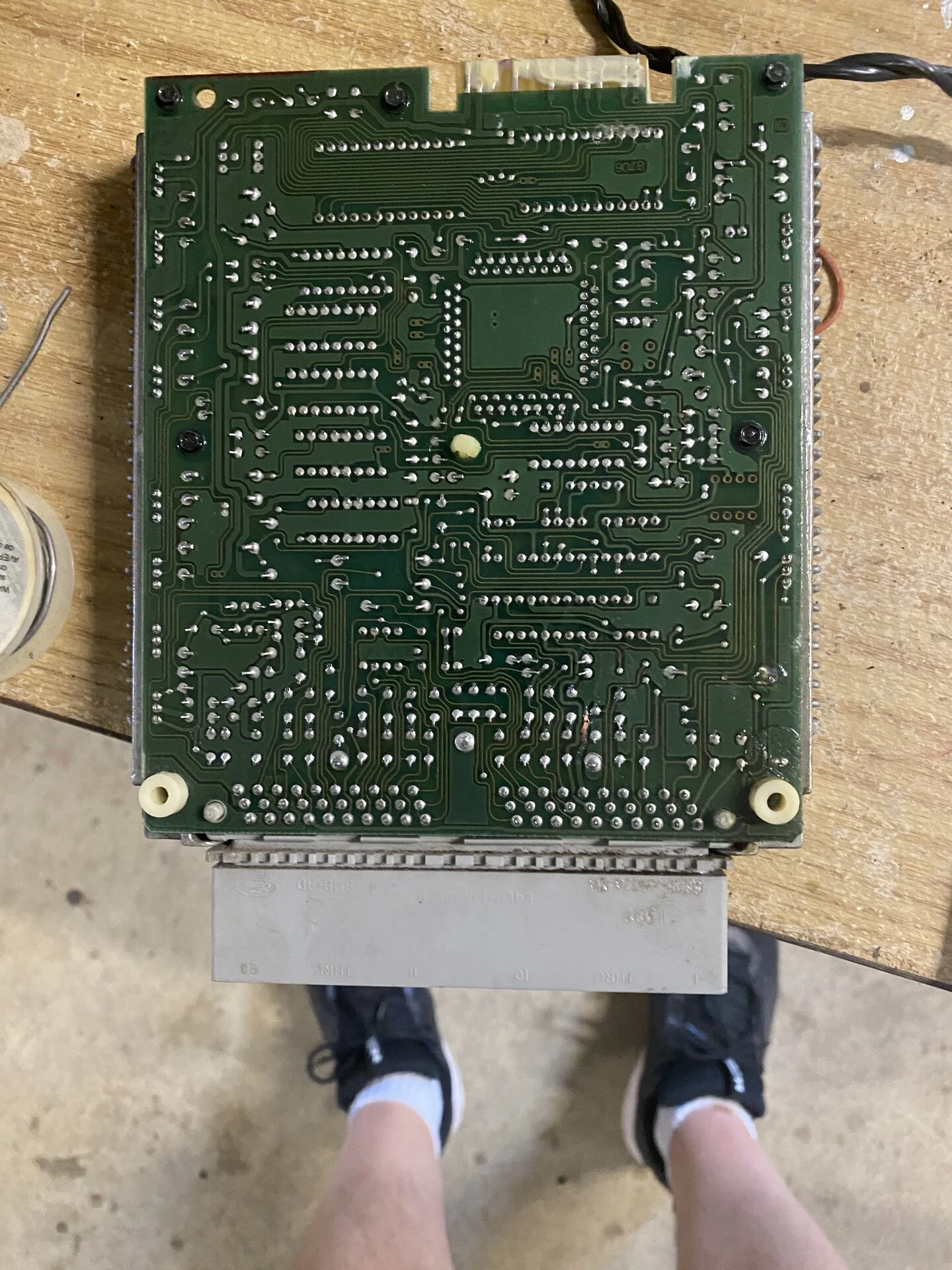

Thanks for everyone’s help but we found the problem. We took the computer out and opened it up. There was a lead that was broken, we soldered it back together and that fixed the problem. Thanks again for your help. I hope this feed may help someone else in the future
