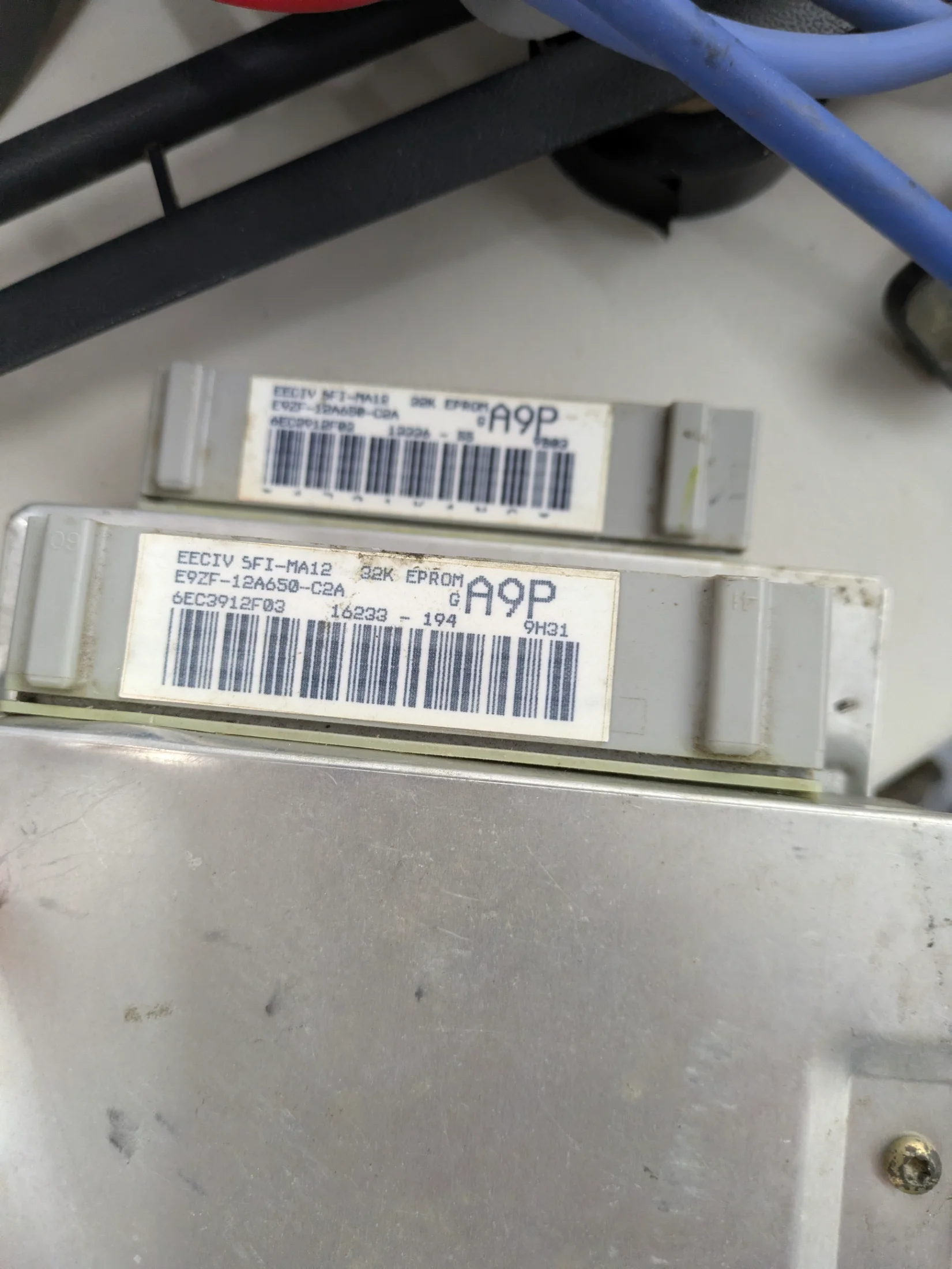

He does not have the original speed density harness so I am stuck with the car as-is. He has a spare PCM and spare engine wiring harness as well. The spare PCM give the same results.

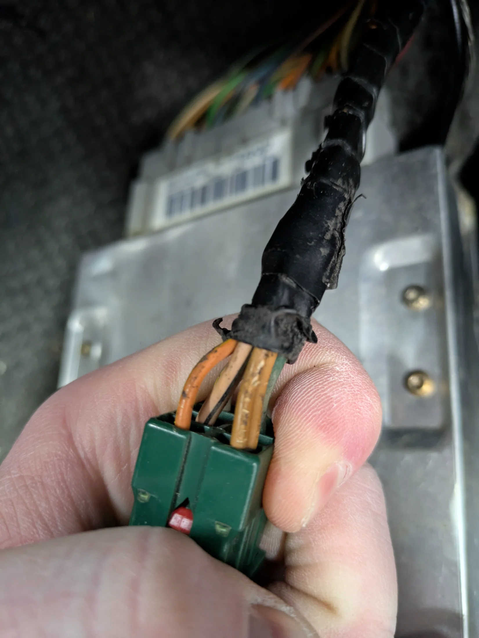

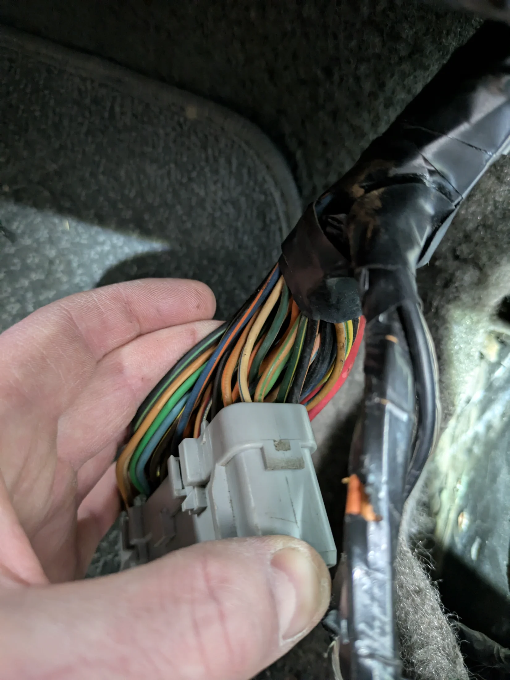

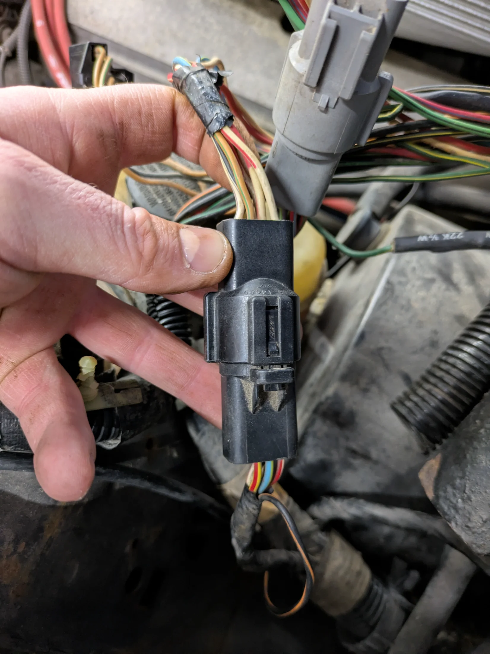

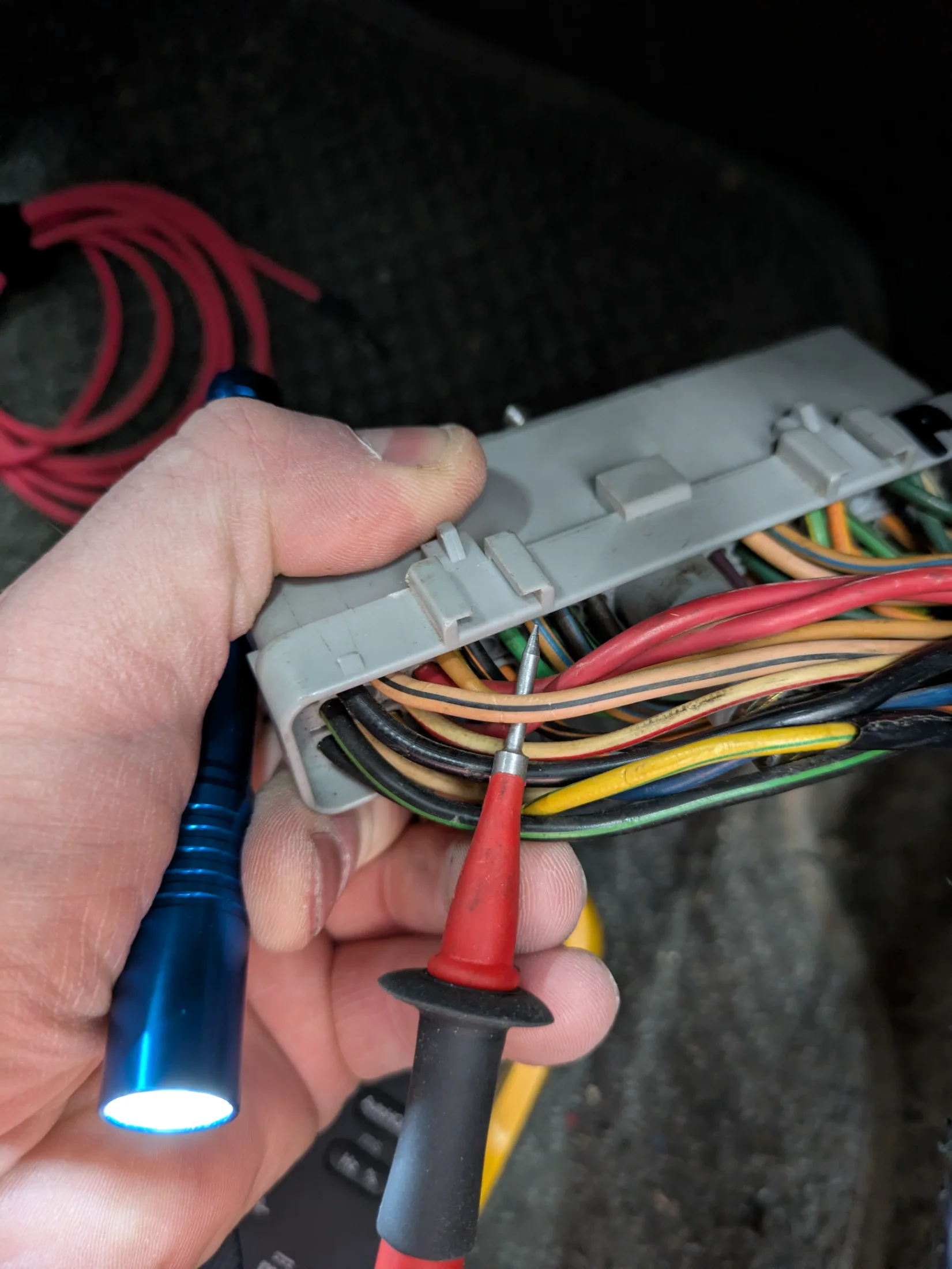

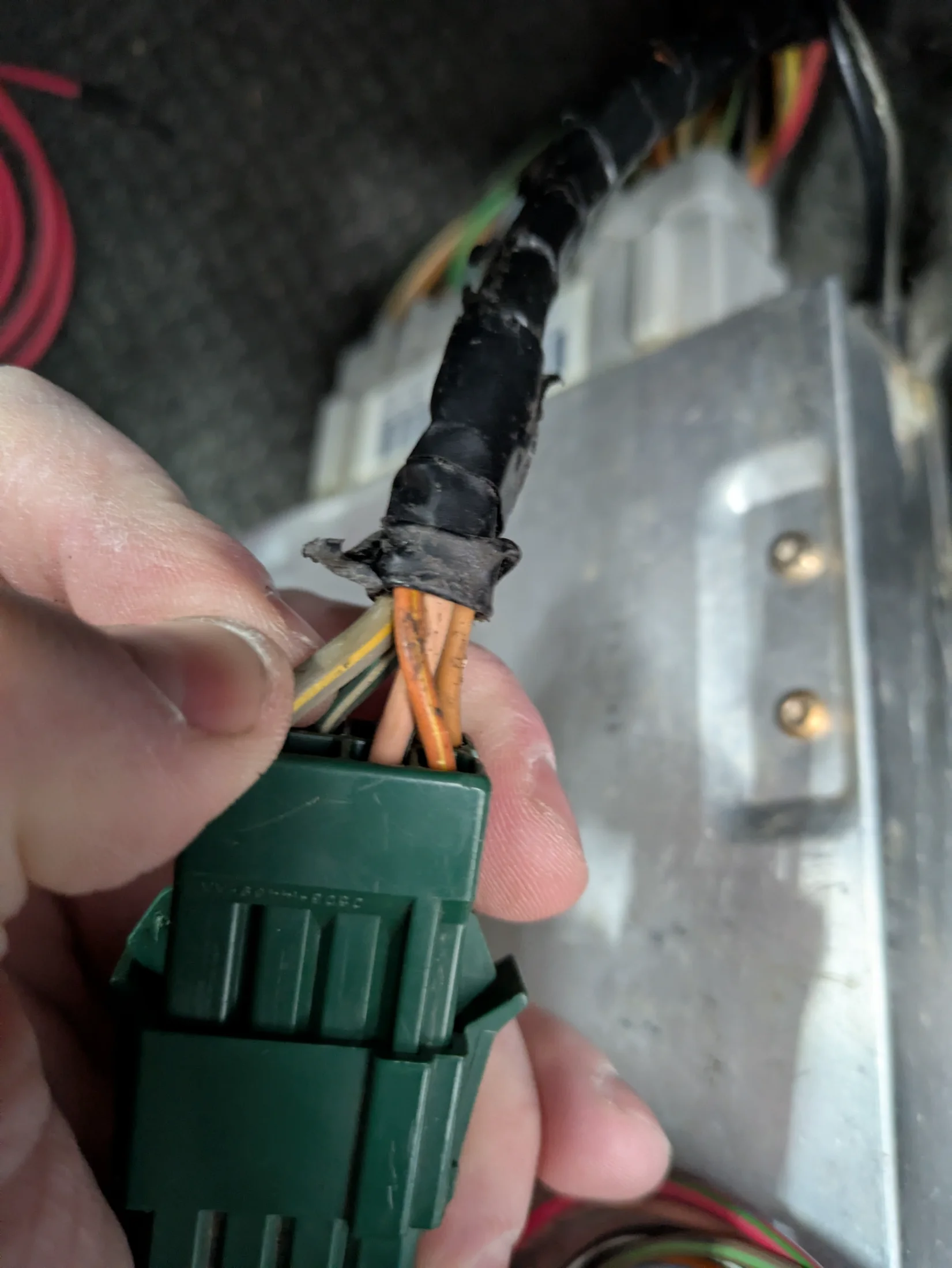

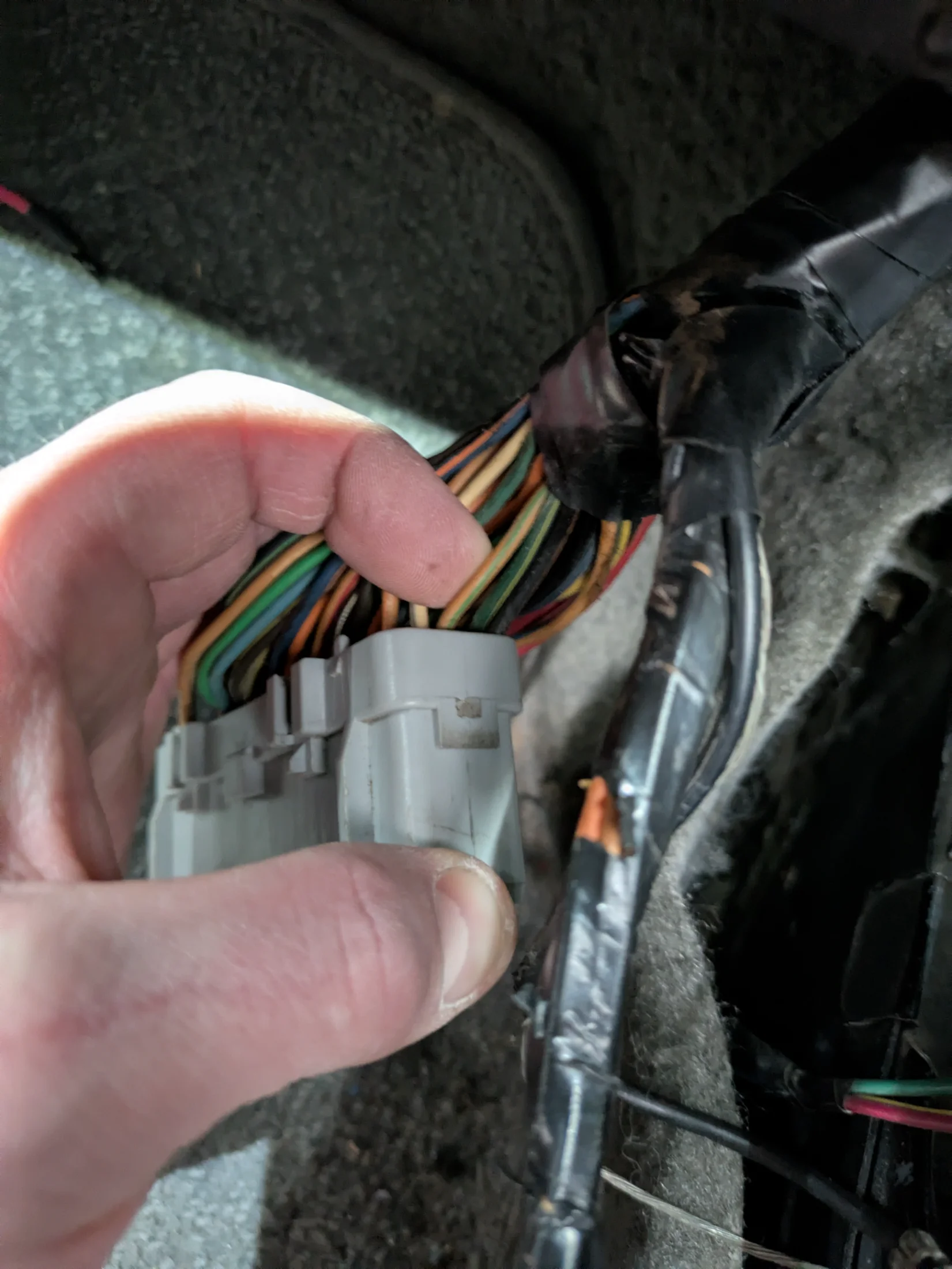

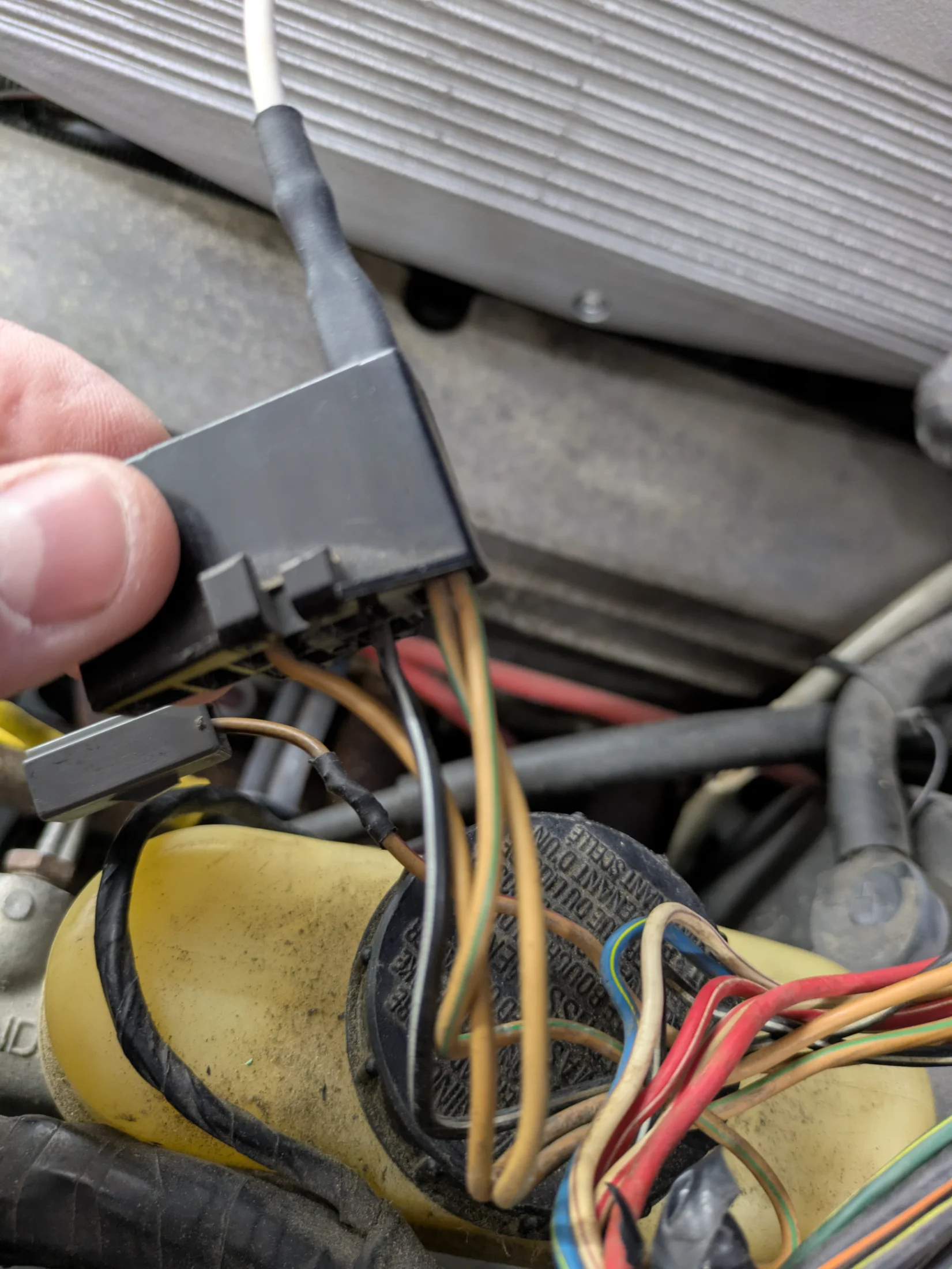

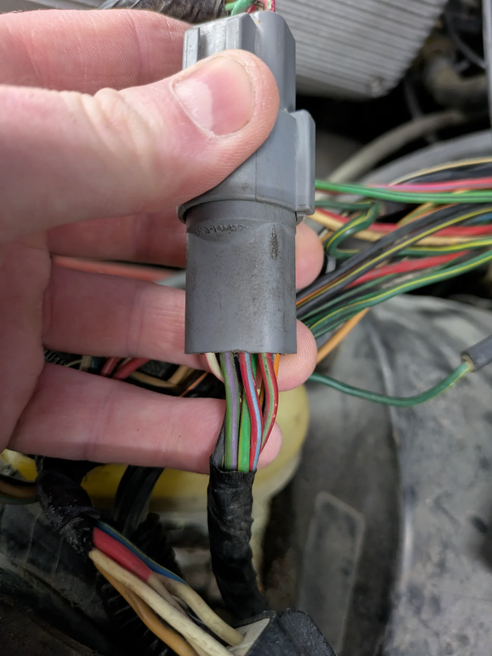

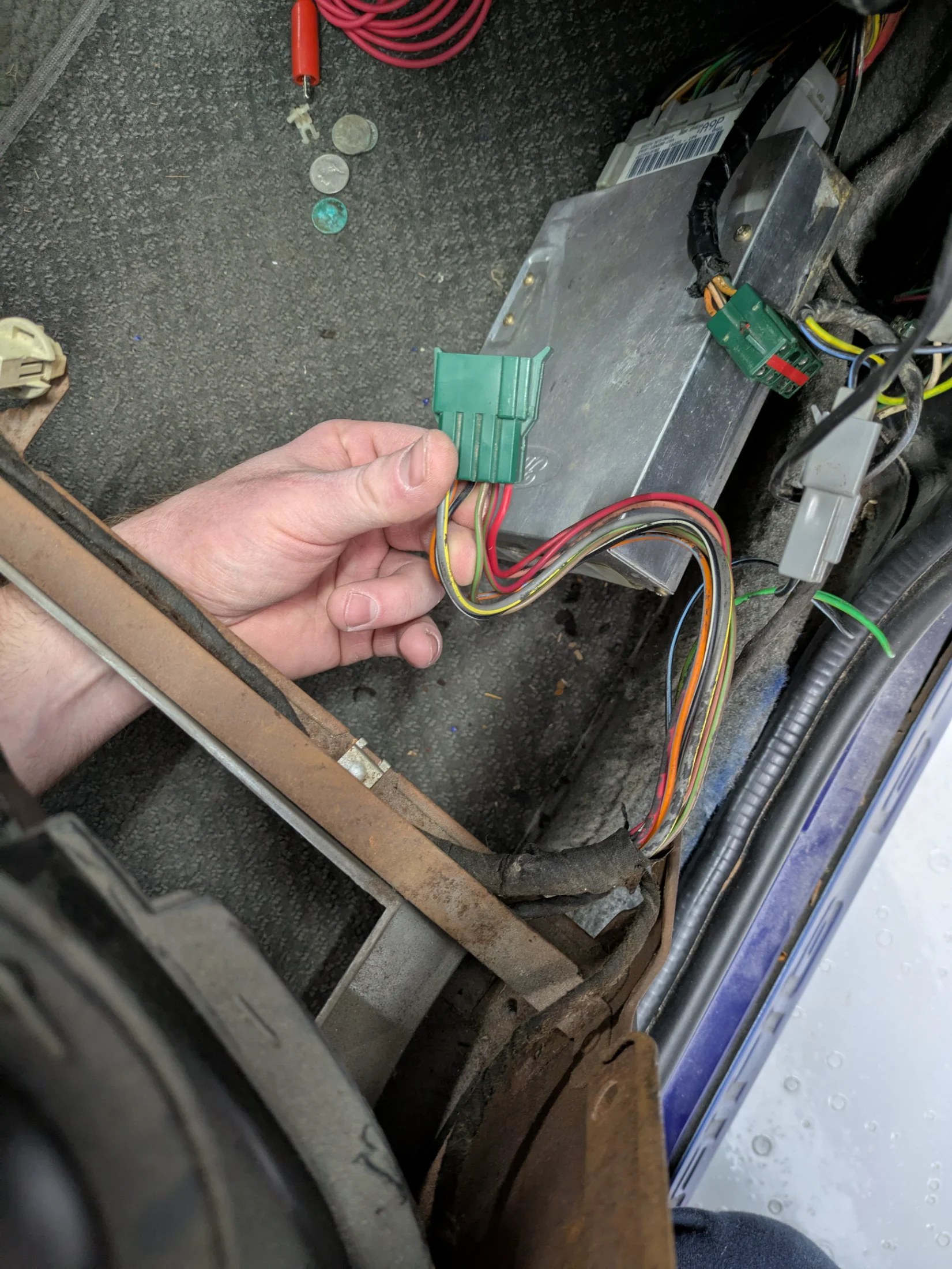

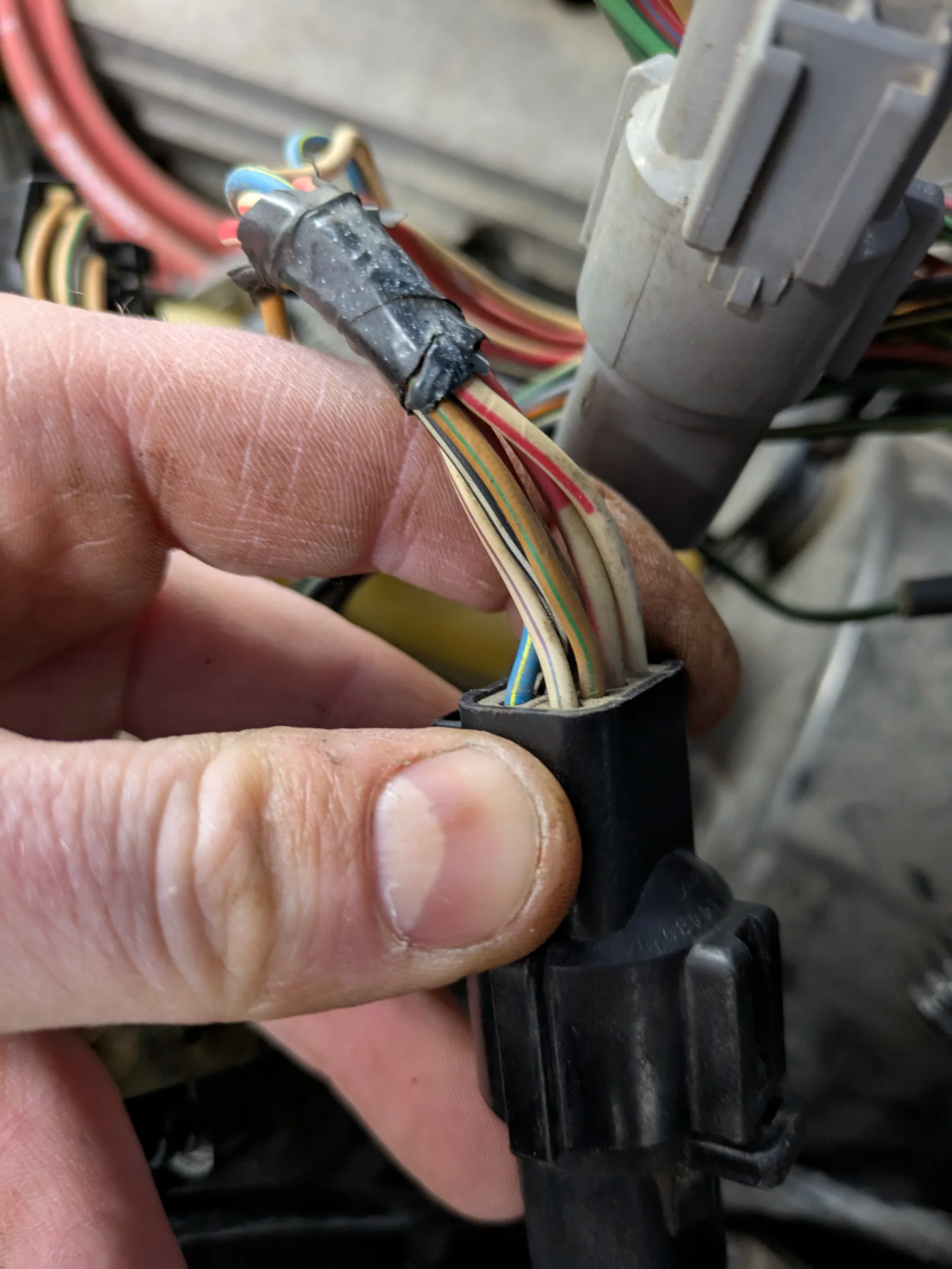

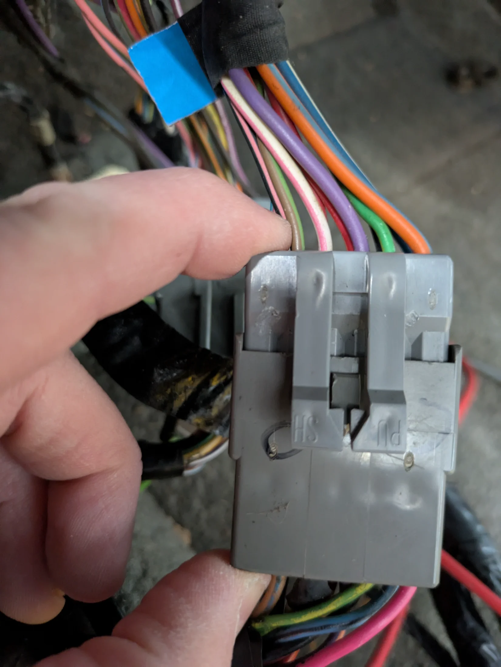

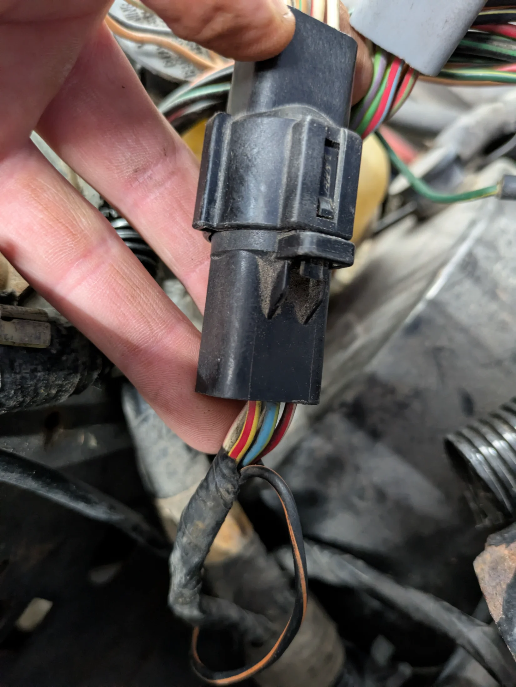

So, just a recap of the two current issues:
1- Low voltage to the fuel pump relay control: Dropping 8vdc between the firewall and driver kick panel. Possibly a pinched wire from previous work or on it's last leg since the dash was moved out when the EEC/Engine harness was replaced. I have not isolated the exact failure point yet, but I might cut the wire and run a dedicated power wire from the splice in the engine harness to the relay depending on the root cause of the next issue.
2- No relay ground control/fuel pump- No continuity to EEC pin 22, has continuity to pin 19.
I traced this back today, it has continuity from the relay connector to the 12 pin grey connector at the driver kick panel, the color changes from tan green (or tan blue) to dark grey (maybe dark brownish) with green tracer. It runs under the dash across to the passenger side kick panel green connector. From there, the PCM/Engine harness changes color and runs to pin 19 on the EEC-IV connector.
Pin 22 on the EEC is the proper color and has continuity to the VIP/DLC connector under the hood.
At this point I am 99% sure the engine harness is not compatible with this car's dash harness. I need to source a replacement 1987 GT engine speed density harness and get the MAF wiring upgrade kit in the link above.
Thoughts?
Here is the second portion of why I think the harness is incorrect... From the VIP/DLC connector the tan/green wire runs to the black connector by the booster. Then swaps to yellow/red. That wire then runs to the cruise control module under the driver side of the dash.
