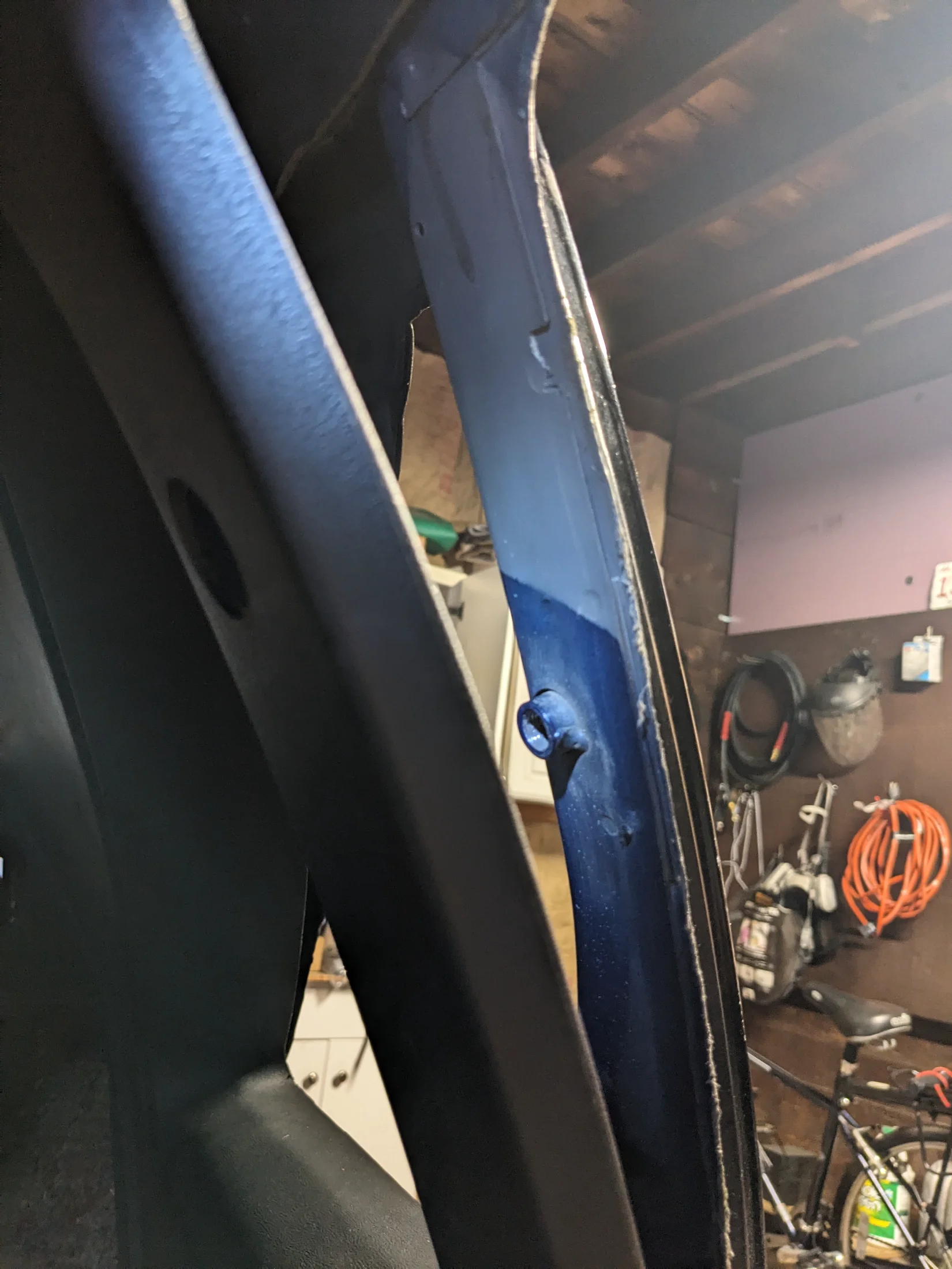

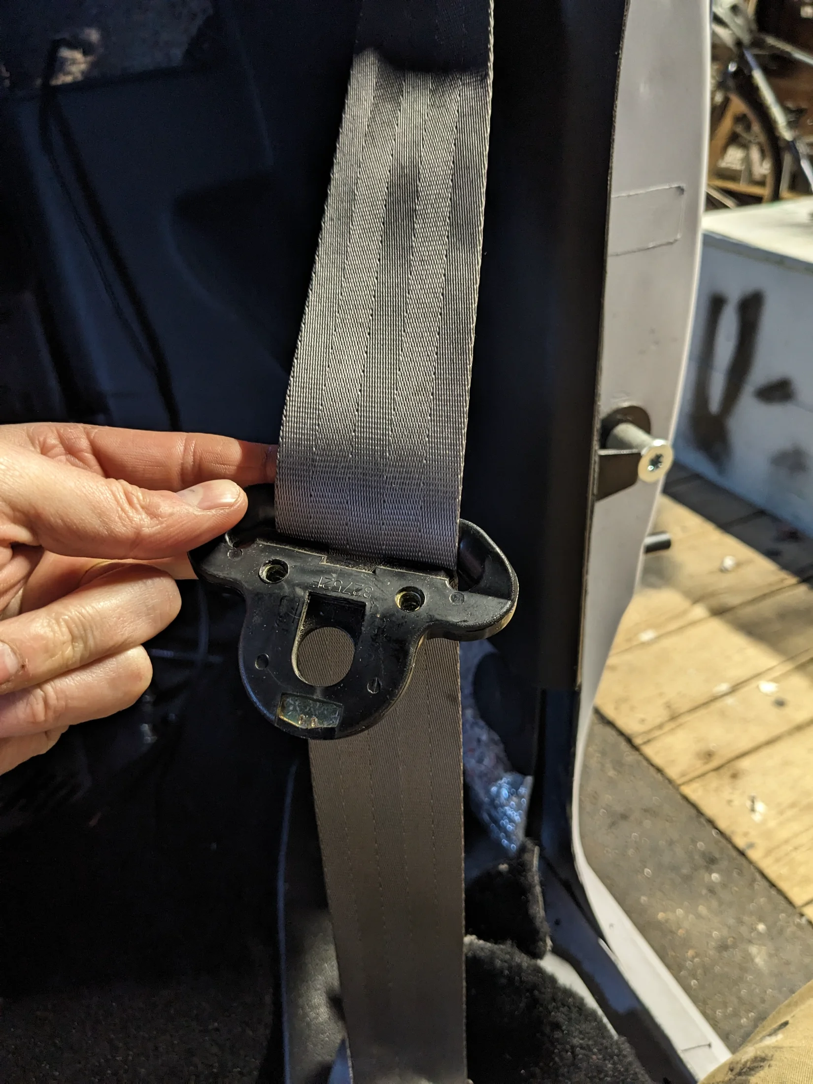

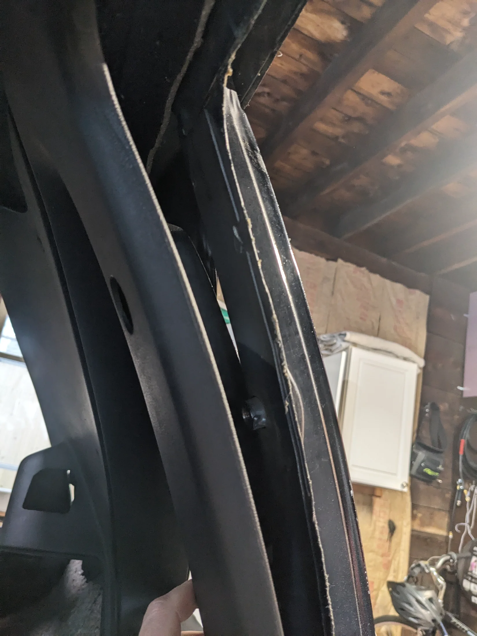

Unfortunately car came with most of the interior already apart so not sure about a few things that don't seem to be lining up.
The hole in the interior side panel doesn't seem to match up and be close to where the connection is for the belt on the body. Scratching my head on it as it's pretty far off and panel seems to be right where it should be per pictures.
Not sure if anything changed between years or if something's missing?

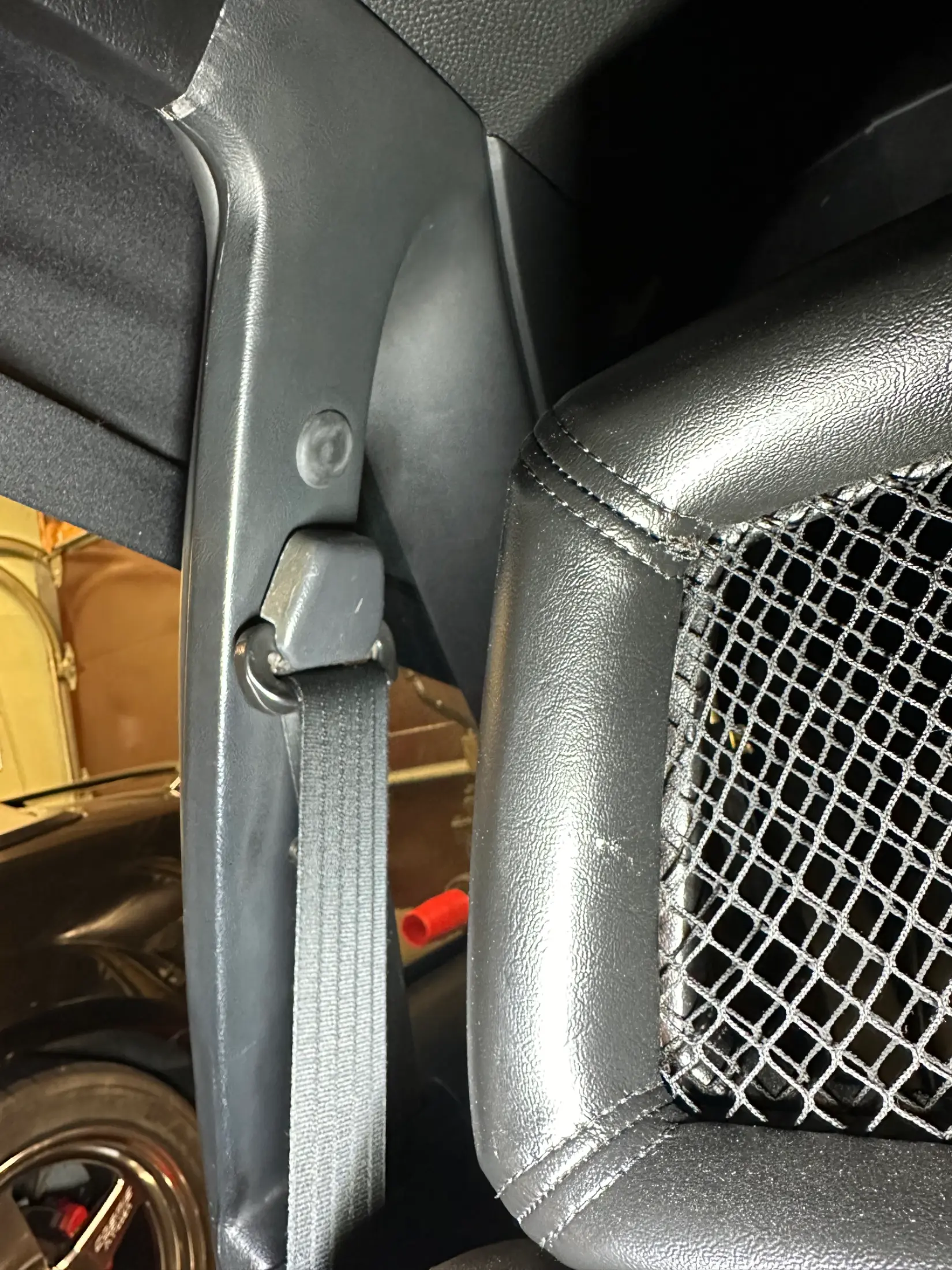

Ok, thats what I thought you meant. Are you even sure you are working with all original interior pieces? I had a look at mine and I just dont see how this is possible unless it was pieced together from other model years
Yeah like I said when I got the car it was torn apart so my original thought was maybe some sort of change in the year. Everything fits perfect with exception of this hole for the belt so it just wasn't making sense.
I actually just found some information online after changing up my wording of the search. Assuming that this person is correct then this would all make sense. and sounds like I need some different interior panels for my 1988.....

Looks like you have 90-93 interior panels.
This is one of the changes that was made within the 87-89 and 90-93 interior spans. The front seat belt shoulder mounts are about 2" higher than pre-90 cars. You can see this in your photos.
Really the solution here is to do cleanly drill a new hole at the proper level so you can mount the belts in the original location. You can likely source a rubber grommet to fill the open higher hole.
But for the most part an 90-93 interior in an 87-89 is straightforward. It will all swap in with a few minor concessions.
I have a 90-93 interior in my '88 if you need any specifics
