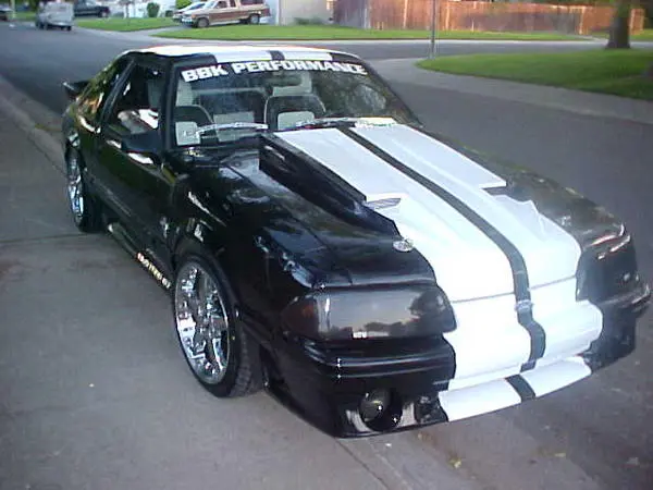

Well where do I start! This car has been a 10 yr dream of mine and I finally found the right car at the right price. However the engine has a knock which I'm not worried about I will pull the oil pan and check for play in the rods! I worry more about what the hell I'm going to do with the motor! I will be removing it in the coming weeks but I don't know what to go with? First off I will tell you what is on the motor when I purchased it then I will go into detail of my plans. The car has brand new interior plus alot of upgrades.
Current motor!
Stock 302
GT40 Aluminum heads
GT40 upper and lower intake
K&N Filter
E303 Cam
BBK headers
H-Pipe w/cats
Flow masters
3.55 gears
Center force clutch
MSD ignition
Option A
Hone the cylinders if possible, new rings and possibly new crank shaft since it knocks I hope for only a polish. I have heard not to turn them just buy a good one and have it pollished. New Rings, and bolt her back togeather!
Option B
Bore the cylinders and put a stroker kit in my reasearch tells me to go with a 331 since I want to drive her and it has to pass CA smog! I would go the extra mile with forged internals.
At the same time I will rebuild the T5 tranny just to be safe! I want a reliable build. The car has been sitting for 3 years and I'm not sure what else is going to pop up so I figure around 1500 for the motor and thats if I spend the money on the stroker kit. The best machine shop in town want 500 to prep the block other want 225. I would rather spend the extra money and get a block back that has been throughly gone through! Whats everyones take on this! Reliablility and power!! That is CA smog legal!
