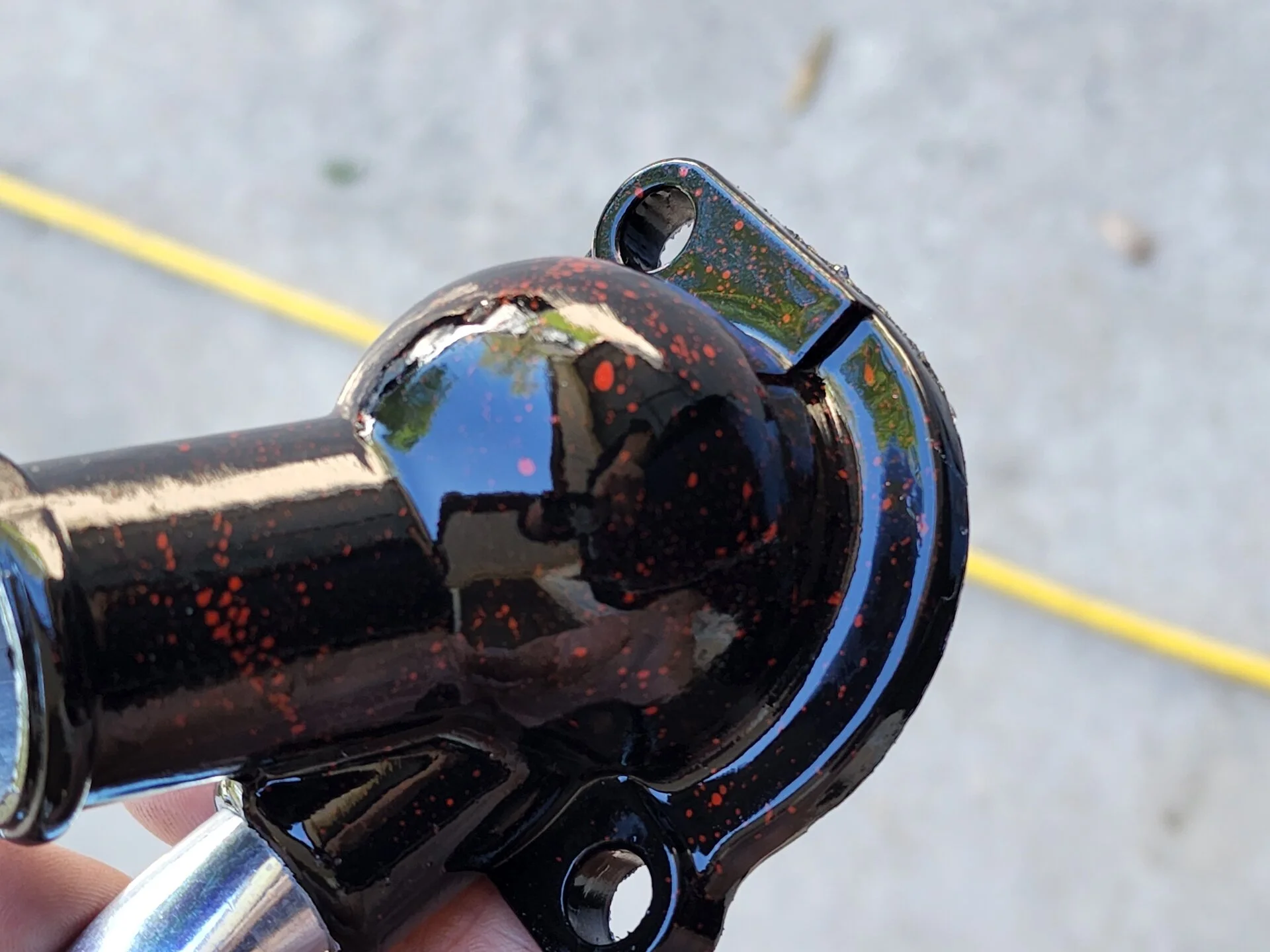

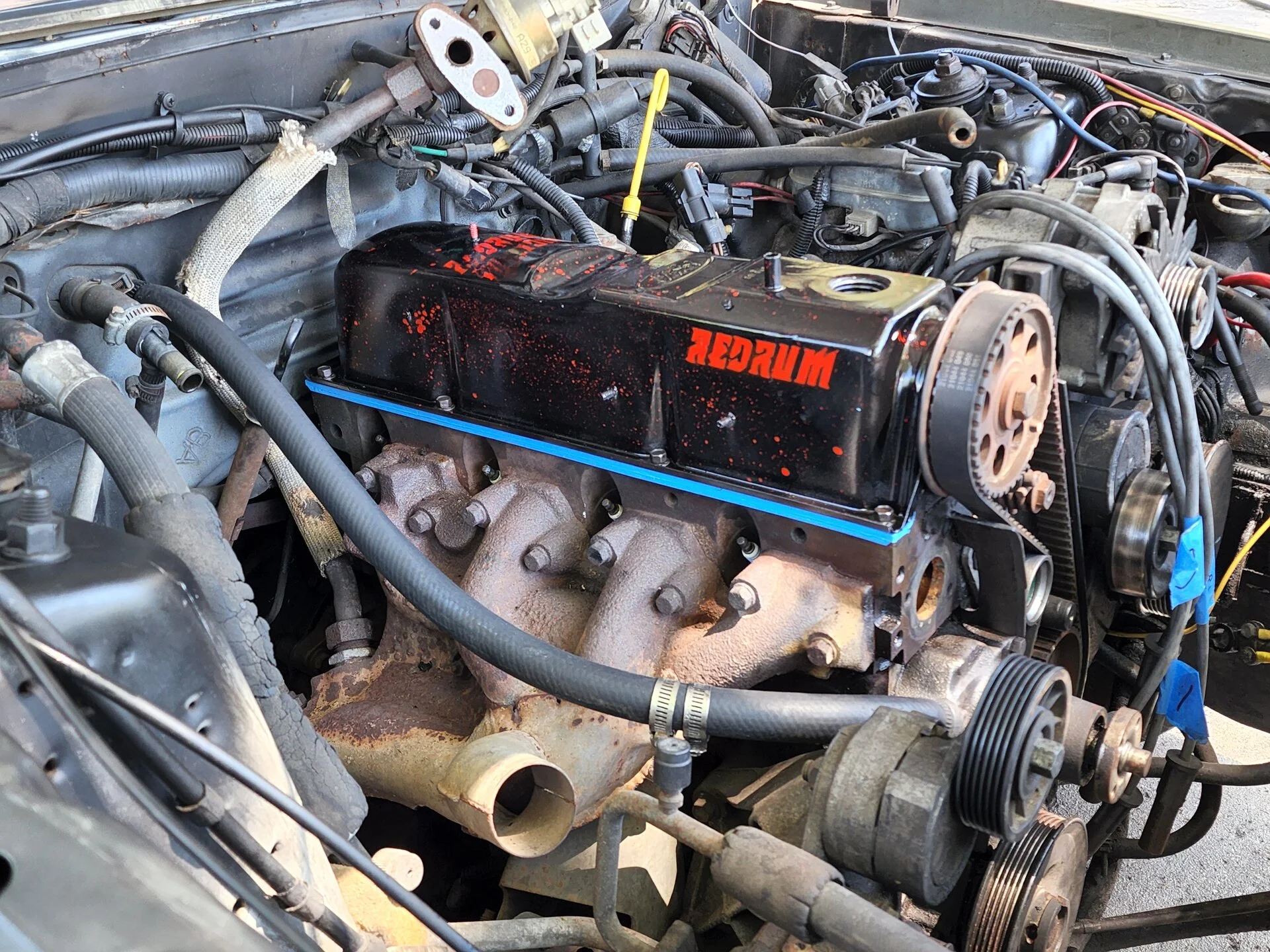

What up! Here is a photo of my valve cover I just finished painting. Can't for the life of me find the torque specs and pattern for it. Anyone got the info?

5-8 lb-ft / 62-97 lb-in
The book didn't specify where to start or direction
Turn the bolts in a Clockwise direction. :rlaugh:
Since it does not say, make up a star pattern. It’s less likely to warp something than going around the edge in an in line sequence. The torque is low enough and the gaskets soft enough that unless one bolt is way over torqued, it will not likely make a big difference. Still, use best practices.
Appreciate the help.

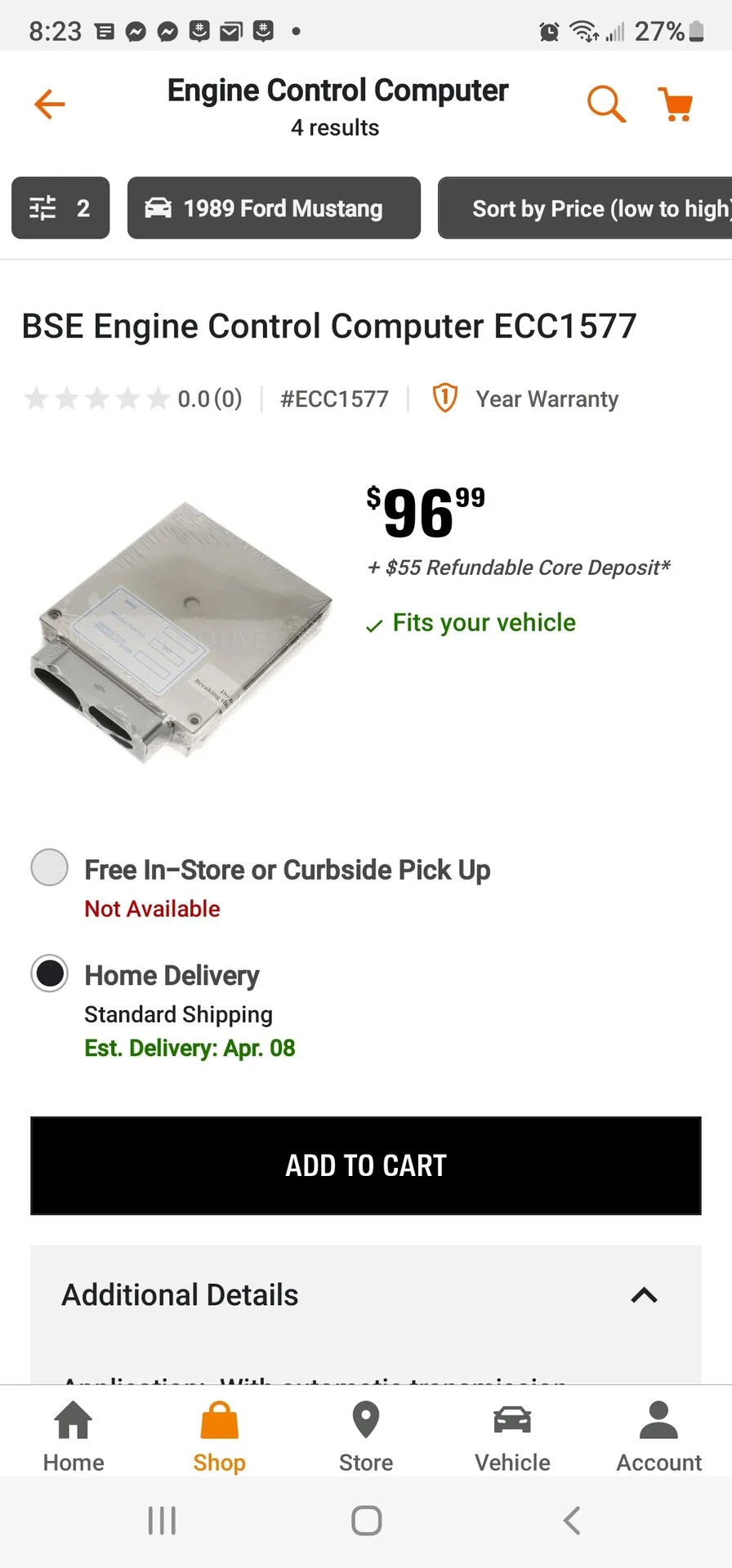

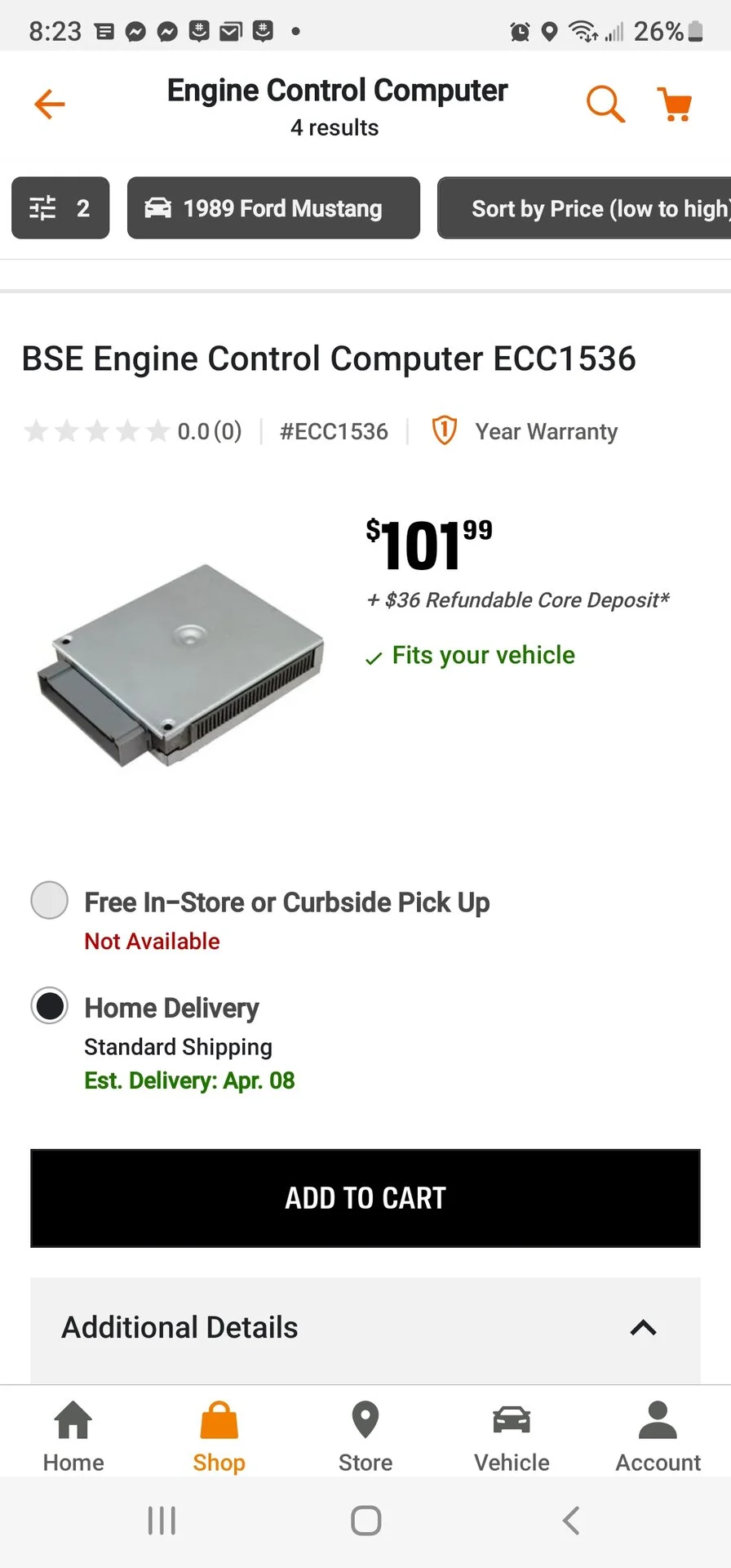

Seems to be holding up the little I have been able to drive it. I'm dealing with a bunch of other issues. Think I got a bad starter and a bad ECM. Would yall know the difference between these 2 ECMs? Description is the same on both except one says Remaned with Federal Emmission OEM #E8TF-CUA and the other is OEM #E8TF-CTA.

Well, why do you suspect the ecu?
Did those both come up for the same application? same year, make, model, engine, trans, etc?
Yeah, they both came up for exact fits on my car. 2.3l auto.
