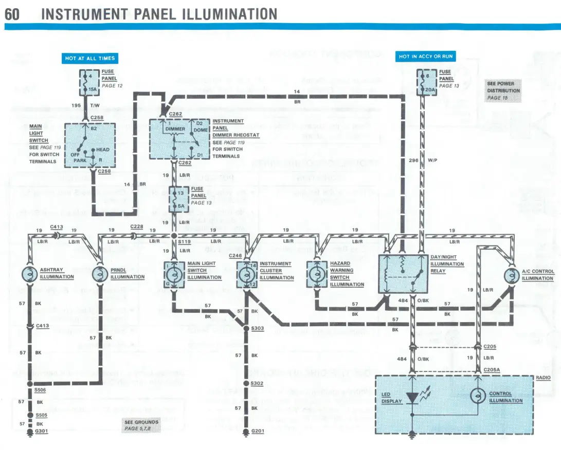

So I have the dimmer working for the instrument panel but not the ac controls or other illumination items. When I try and start the car the ac controls and other illumination items come on and I hear a click under the dash. Any thoughts on this? Relay?
Here's the wiring diagram
