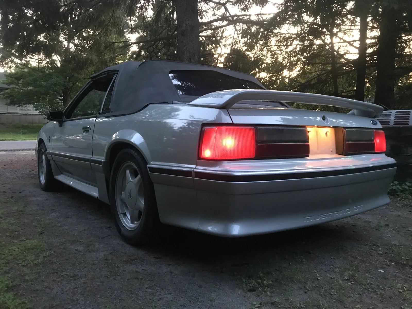

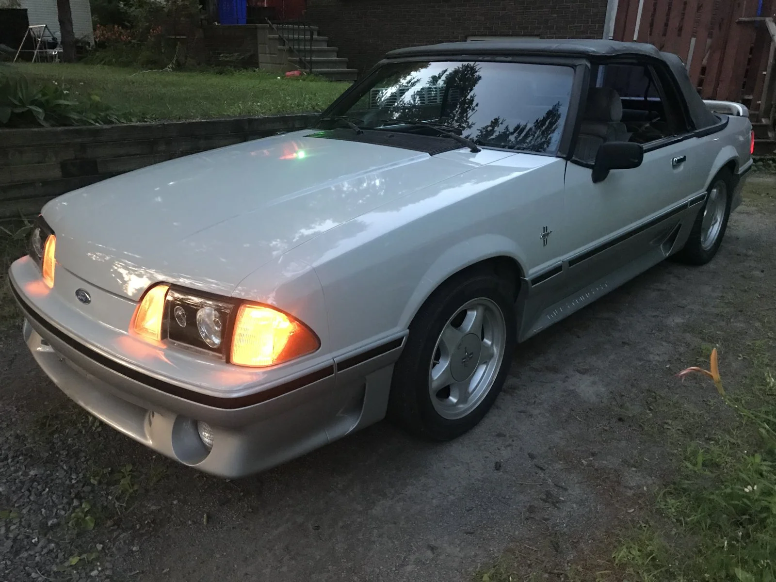

1989 Mustang GT convertible

I'm a new owner of a 1989 Mustamg GT convertible
I've owned it for a month
